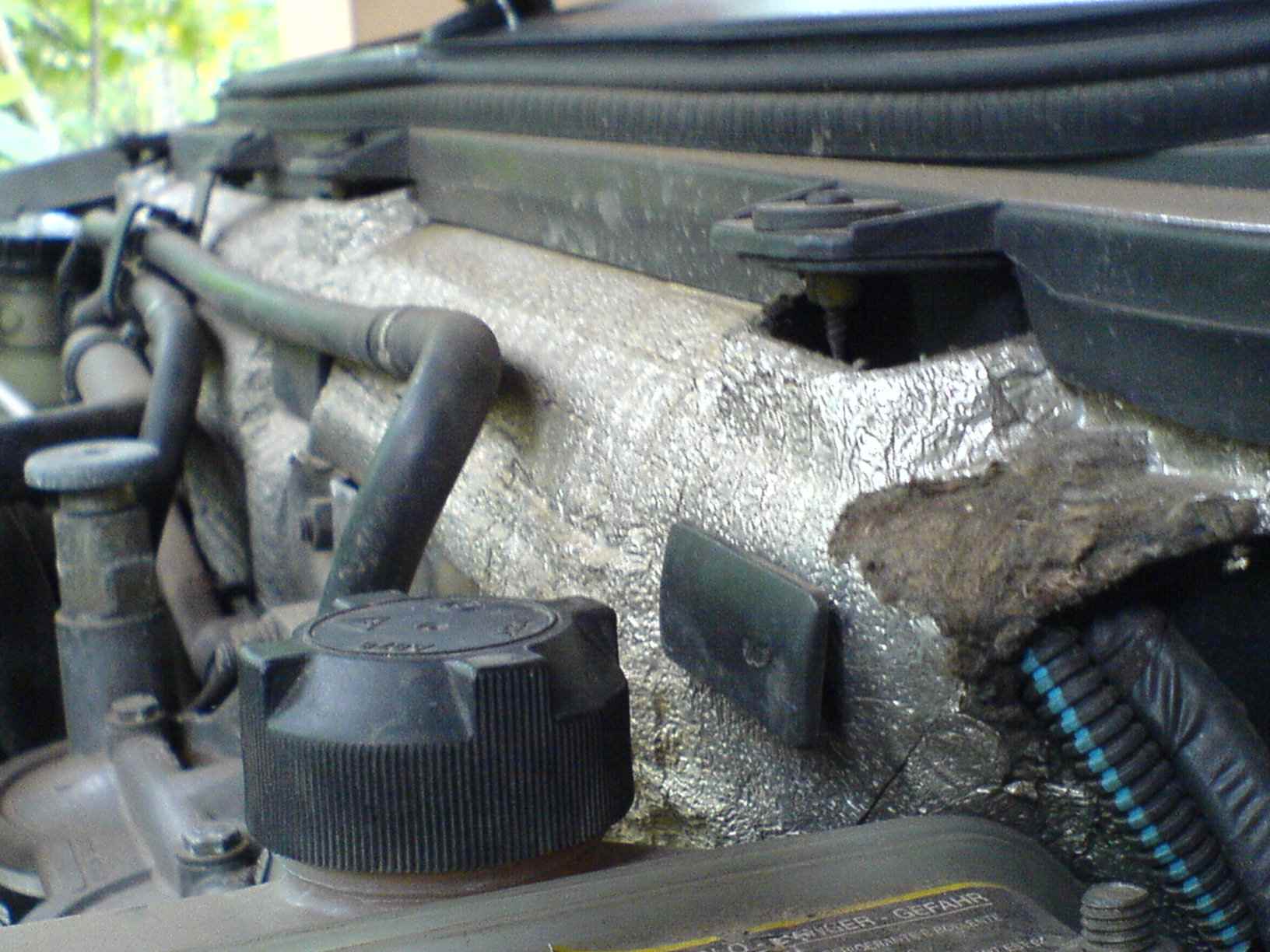

Did not replace the Transmission mounting but only the rubber front mounting of the engine.
Hope you meant the entire hydraulic mount(not just the rubber washer inside as many would do to save money), pic 1.

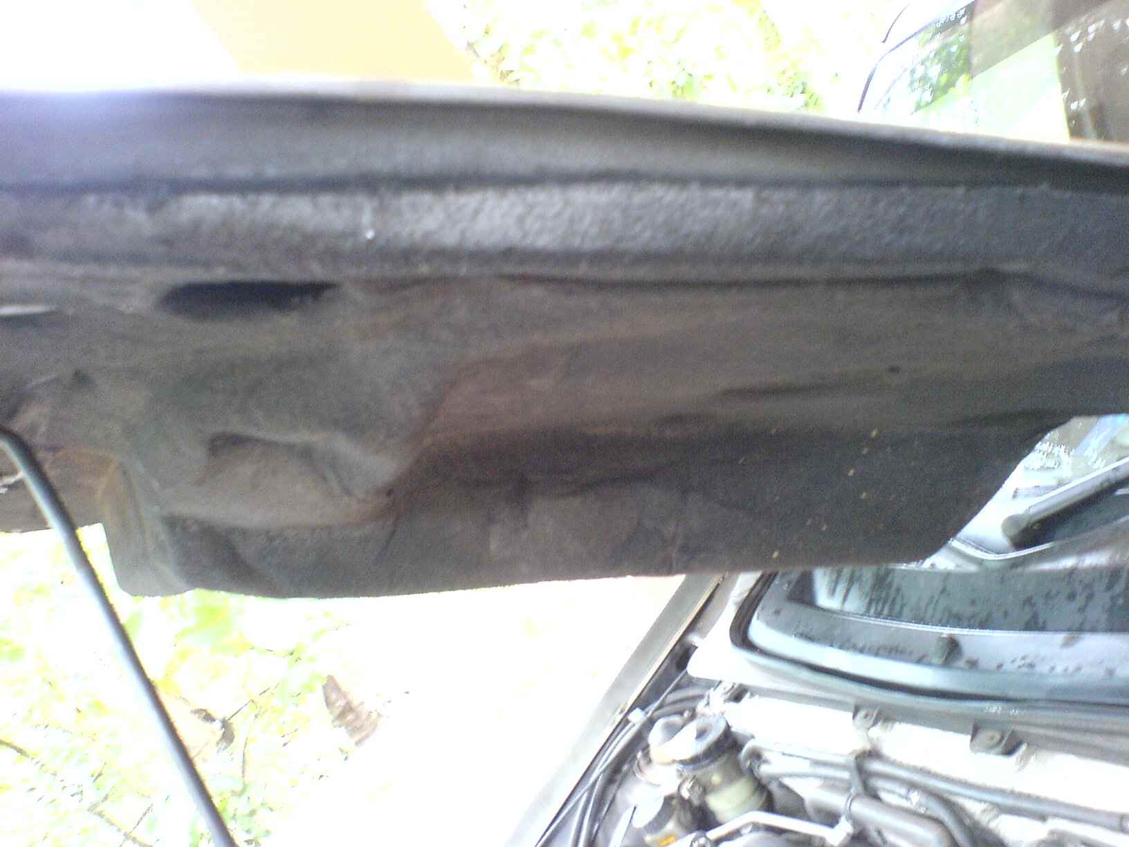

Are you suggesting damping of the noise using foam + cotton waste inside the cabin? Are they not risky considering the heat generated inside the Bonnet?
The noise/heat damping materials came with the vehicles are heat&fire retardant, as they're not ordinary foam+cotton waste. pic 2&3.
