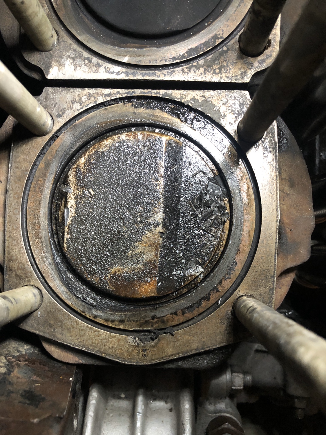

You might pull the cylinder barrel from the damaged cylinder and check for any damage to the piston e.g. crushed crown (top) or trapped/broken rings. Also check the cylinder bore for any damage (might not be any). Before doing this, turn the engine so that the piston is at the top of it's stroke (tdc), lift the cylinder barrel a little so that it comes free from the cyl. block (crankcase) and stuff some rags into the crankcase mouth to prevent any broken piston rings (just in case there are any broken) from falling in, then remove the barrel fully to inspect the piston.

The piston is deffo beyond repair and whilst I agree with Al’s comments about checking the cylinder for damage I would be tempted to just replace both barrels and pistons.

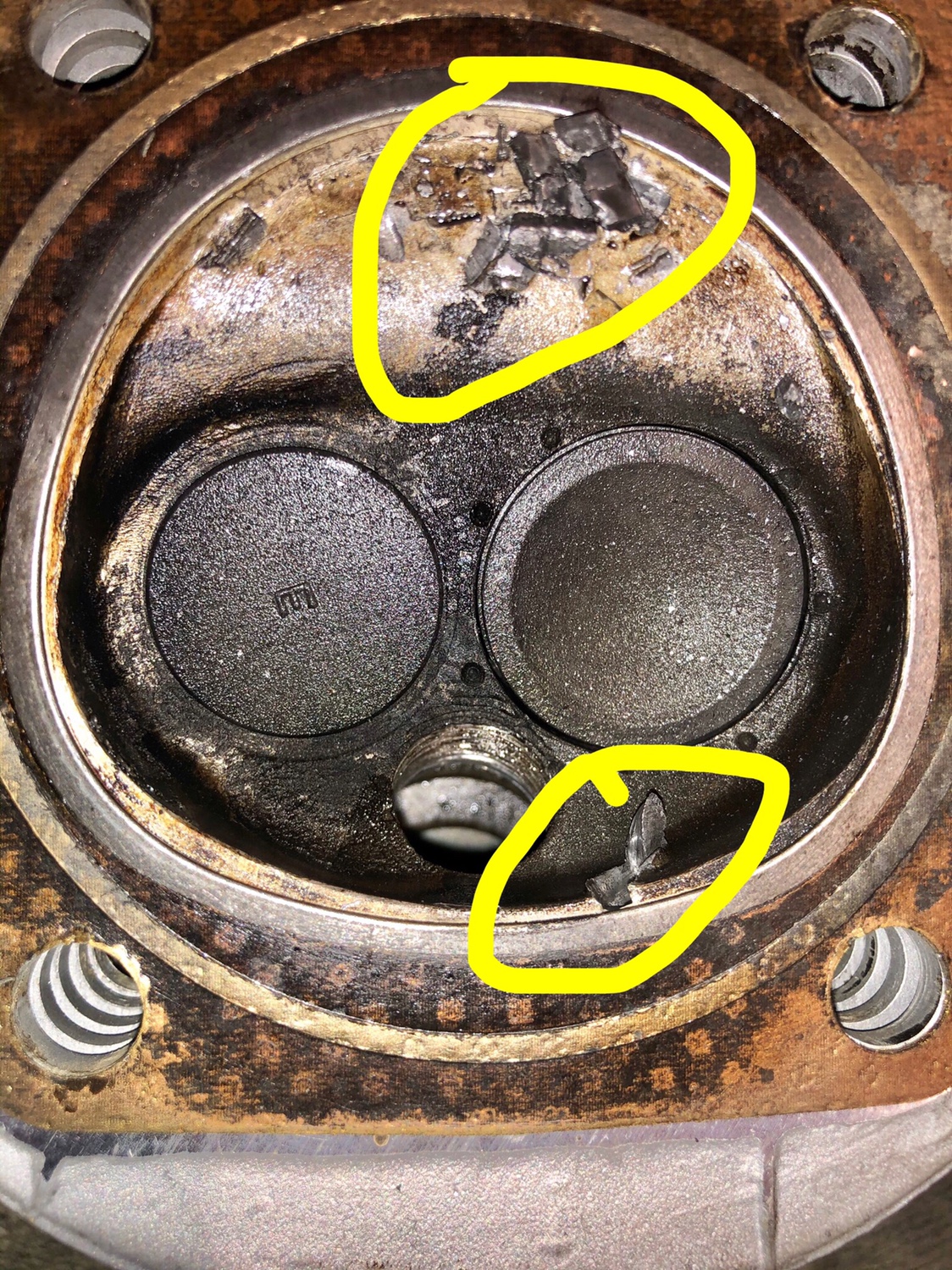

The head has a huge gash in it and a pulverized valve seat ring which is embedded in the top oh head next to the spark plug hole. I can’t see how this can be fixed nor would I trust it again if it could be.

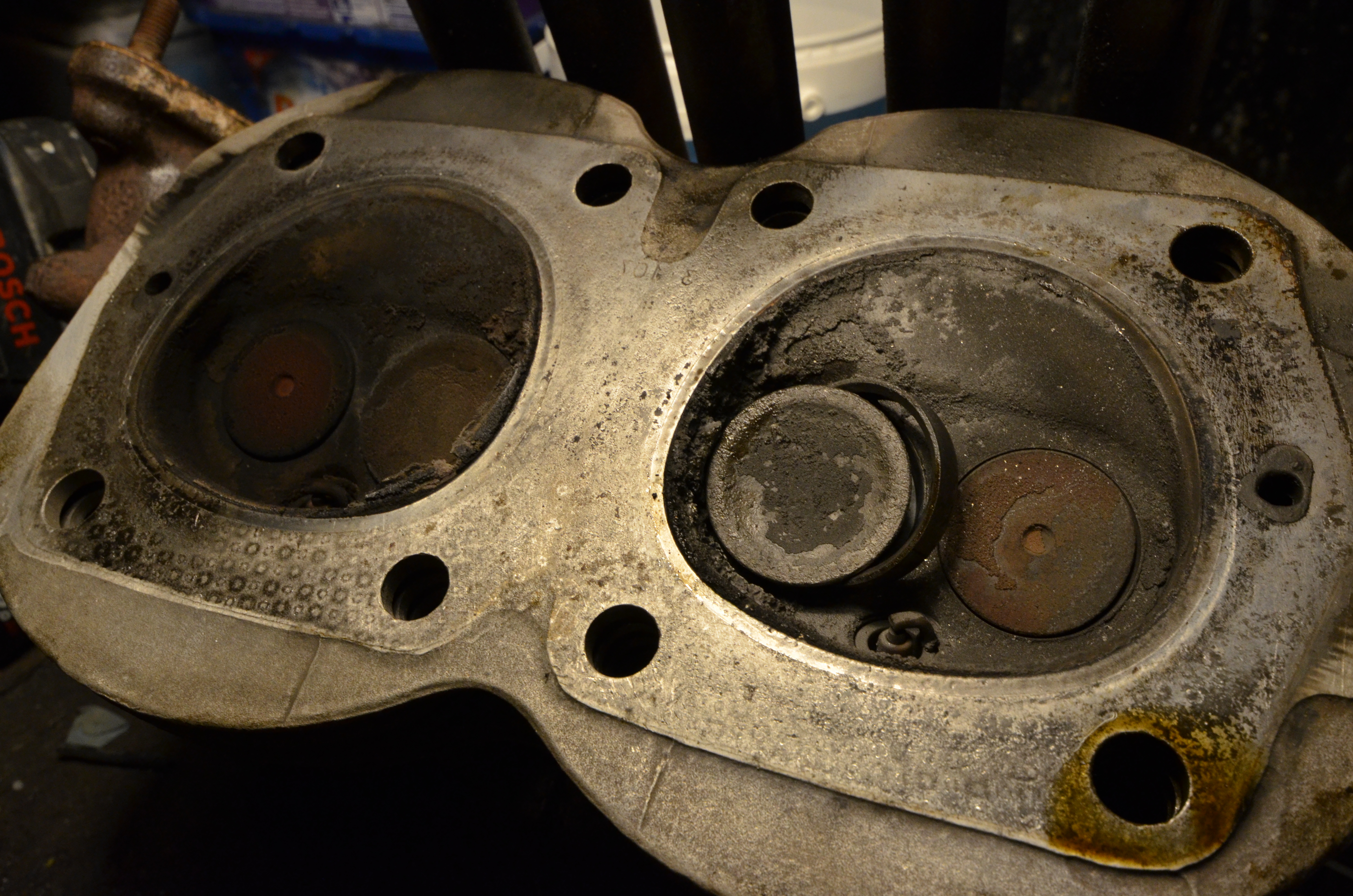

I can't quite work out where the seat has gone missing (obviously it must have done!) as both valves appear to be sitting reasonably correctly. When mine did that it looked like this.View attachment 204205

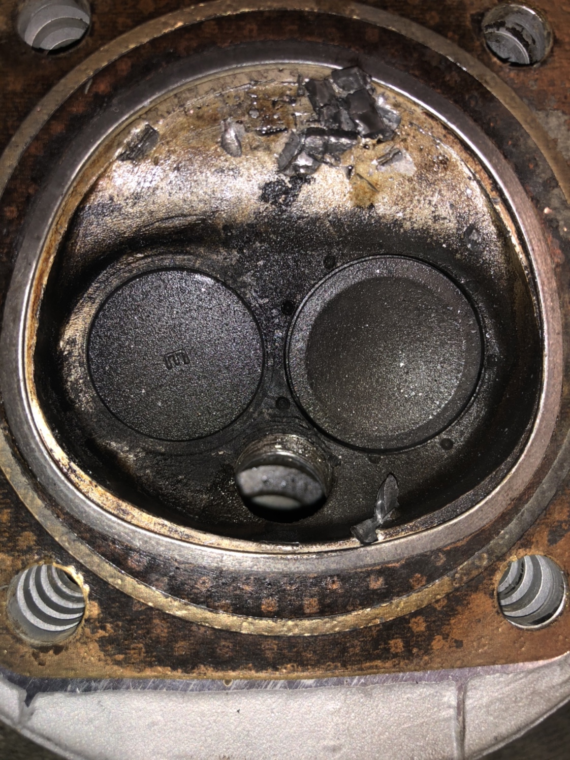

Hard to see but it’s sitting a bit higher in the head than it should be. It has to be that because it was repaired (you can see the little guide holes) and had zero compression. Did the oil test too to make sure it wasn’t the rings. Head gasket was fine.
That head could be repaired, it's not that bad.

I'd be interested to see if indeed the valve seat insert has broken. Your pic in post #26 'seems' to show at least part of the seat insert (left of pic) still in situ - I've never seen this.
In your post #23 , you mention compression pressure figures of 0 on cyl. no.1 and 90 psi on cyl. no.2..... 90 psi is too low, so as The Whitakers suggest, it would be a good idea to pull both cyl. barrels and pistons for inspection.
I've seen this on a couple of occasions. When this happens, the engine looses a cylinder (due to zero compression) but the seat insert is retained by the valve head (as in your pic) preventing it from entering the cylinder and doing a lot of damage. If part of the seat broke away, then surely the remainder would do so also, resulting in no valve seat so the valve would sink into the seat insert recess in the head - yet it looks to be sitting normally?
Those 'little guide holes' look to me to be centre (dot) punch marks.
2 reasons for these marks.
1. To try to tighten a loose seat insert (either the original or a new one). Bad idea, won't last. The seat insert is supposed to be an interference (i.e. v. tight) fit in the recess in the head to ensure it never comes loose/falls out and also for heat transfer (v. important for exhaust valves). If the recess is too large to achieve this interference fit, there are oversize seat inserts available or the recess has to be reclaimed by welding and machining.
2. As extra insurance having fitted a new seat insert. Not needed + looks amateurish. If the seat insert has been correctly fitted it won't come loose/fall out. If you don't believe me, just try removing a valve seat insert at home.....
It's not a good idea to leave any sharp edges/points in a combustion chamber (using a centre punch can do this) - such points can glow red hot and cause pre-ignition (not good).
I don't mean any disrespect to your older mechanic who reconditioned this cyl. head - anyone who has worked on VW engines for years obviously has great experience on air-cooled engines - maybe using a centre punch as 'extra insurance' was just a habit he developed over the years - most mechanics develop their own way of doing things over many years, including adopting certain little habits without actually stopping to evaluate if these habits are indeed necessary or might be potentially harmful to either the car or themselves.
