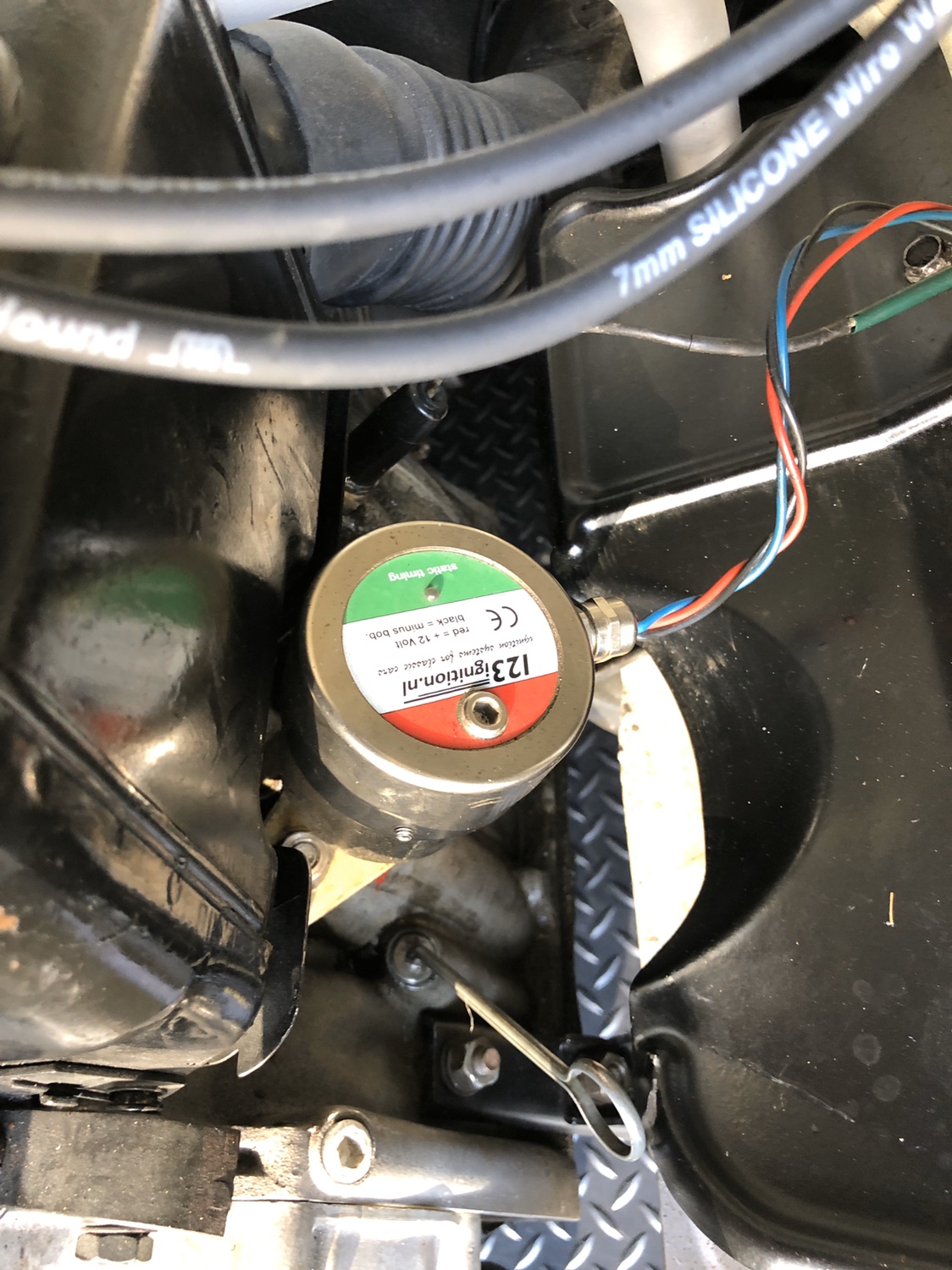

Is it definitely a 123 setup then. They have a custom distributor and you wouldn't be able to fit points etc. into it.
Yes. I wish I had a working spare I could swap it with and see if this is the issue. The spare I have is dead.
I hadn't thought of that; you have the version which does attach to the body of the existing distributor. I'm not familiar with how it does that but it does open out more interesting ways in which something got messed up. This may not necessarily be a fault inside the unit itself, but I wouldn't know where to start looking.....out of my depth with that one:bang: But it does offer the possibility of rebuilding using the original points and condenser as long as you still have all the removed internals.
Maybe a clue in these instructions...two magnets fitted over what I guess are the bob-weight pivots; is one missing or touching the circuit?
http://www.123ignition.nl/files/manuals/123manual_FIAT500.pdf
I think it might also restrict the range of coil types that you can use, but not sure about that either.
I presume that you must have a coil with twin HT outputs?
You are correct Peter---the "add-on" 123 electronic ignition comes with a pair of small tubular magnets which fit over the bob-weight posts, after you have stripped the points, base-plate and bob-weights out. And yes, you DO need a twin (wasted-spark) coil. Which brings us to another possible cause--is there a fault in the coil terminal to No1 spark plug. Being that sparks are sent to BOTH plugs at the same time (the one with the piston on its exhaust stroke therefore being 'wasted'), what would be the result if you swapped the ignition leads over at the PLUGS (but kept them in the same terminal at the coil)---I wonder if the fault would move to no2 plug? Just a thought!
Apologies Peter, I forgot to mention that it is ONLY the "add-on" 123 ignition that requires a twin-coil, and this is the system Steven (Labman) has on his car. The 'complete distributor' unit has a rotor arm, so therefore you only need a 'normal' coil for that installation.
Thanks Tom, that part I was aware of; see above.
https://www.fiatforum.com/500-classic/476795-strange-issue.html?p=4503356
I'm just pushing ideas around which might lead to a solution for Steven; rather than trying to cover the full technicalities of anything in particular. As I was indicating previously, my car has been running successfully on the 123 FIAT-2-R for more than 20,000 miles.
there are I believe 3 types of 123 distributor types for teh 500/126 engine (excluding the usb new version)
1) the complete 123 Distributor with Distributor Cap
2) the Add on that sits on top of the std distributor
3) the 126 version that looks like the one in Labmans picture...
that is a complete distributor without a cap.
I know because I have 1 & 3
