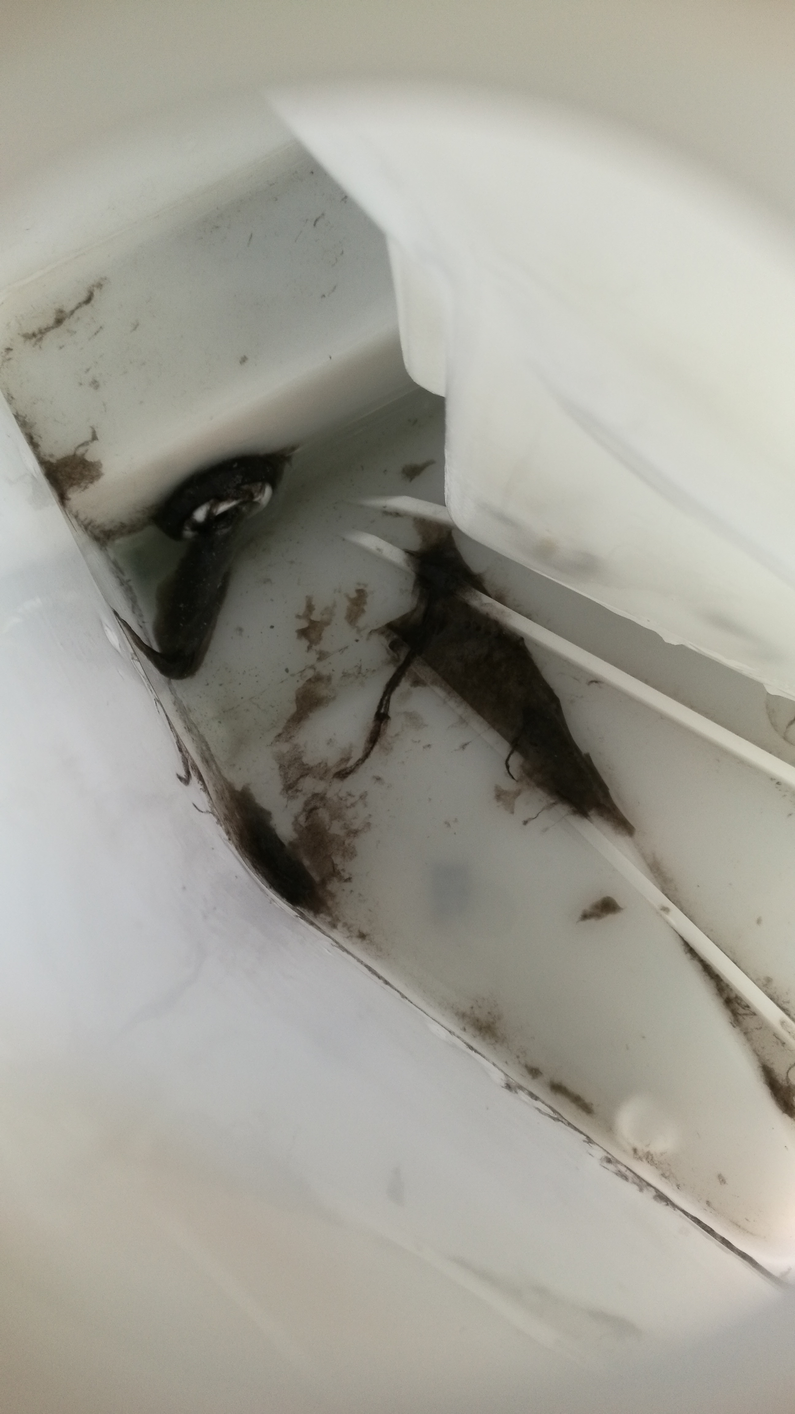

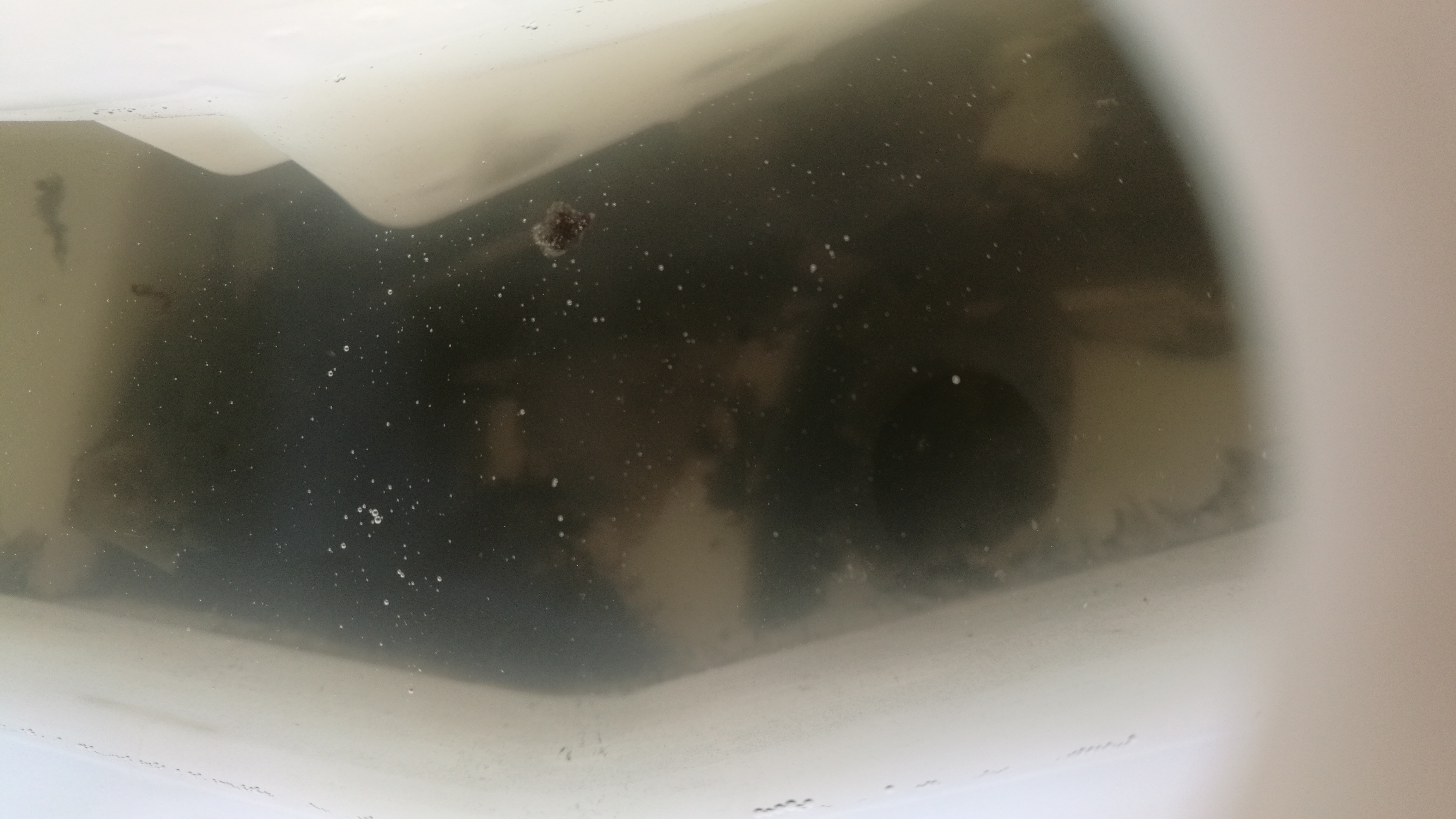

I then looked in the washer fluid tank and ... :yuck::yuck: it was full of crud! How this happened I don't know because the tank has a cap! :shrug:
Leaves, a small stone, goo, grit ... it had it all!

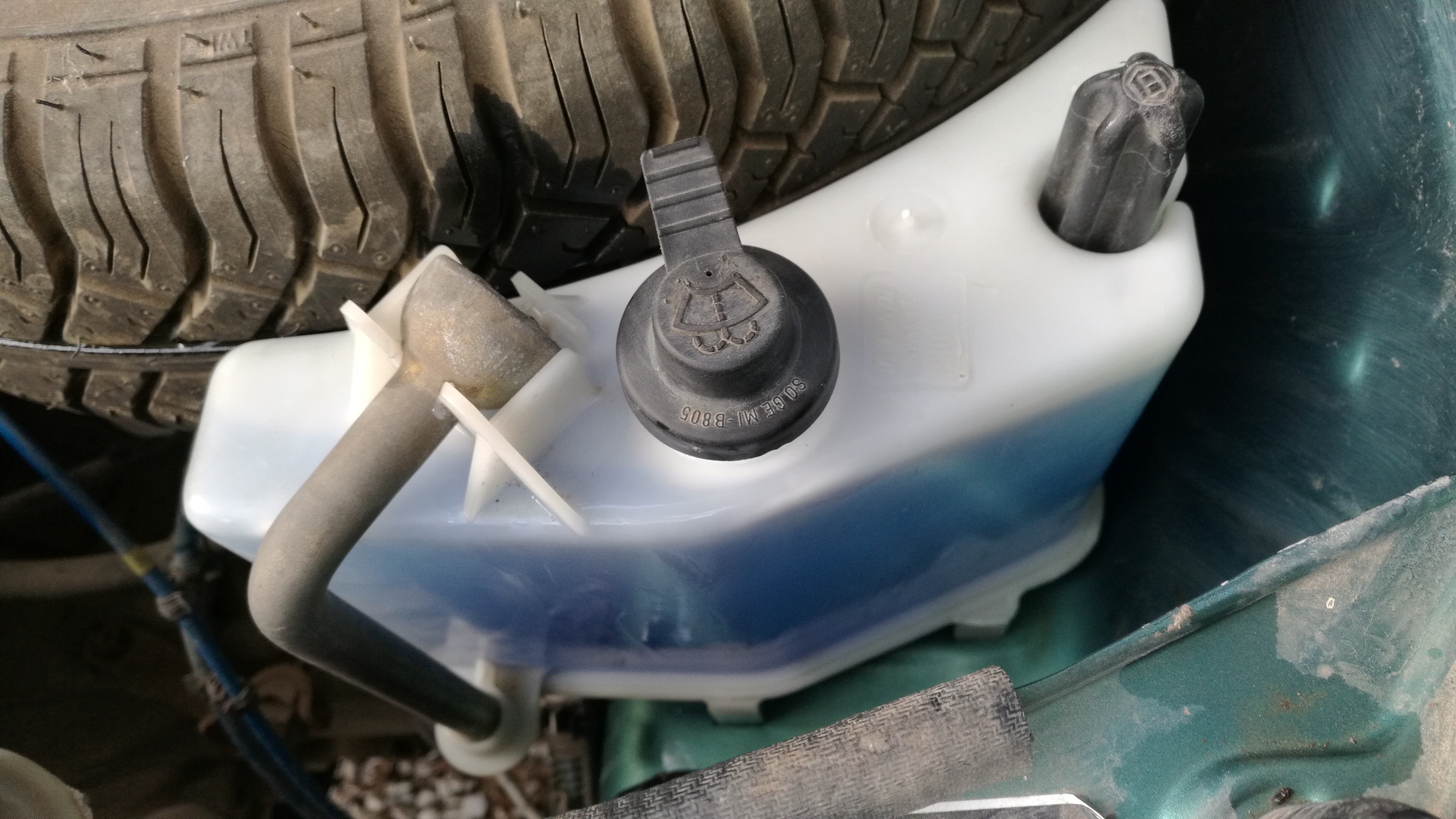

I can only presume that at some point in its life the cap was missing, even though the cap looks of original age!
Anyway I removed the tank (only one nut! good old simple pandas!!

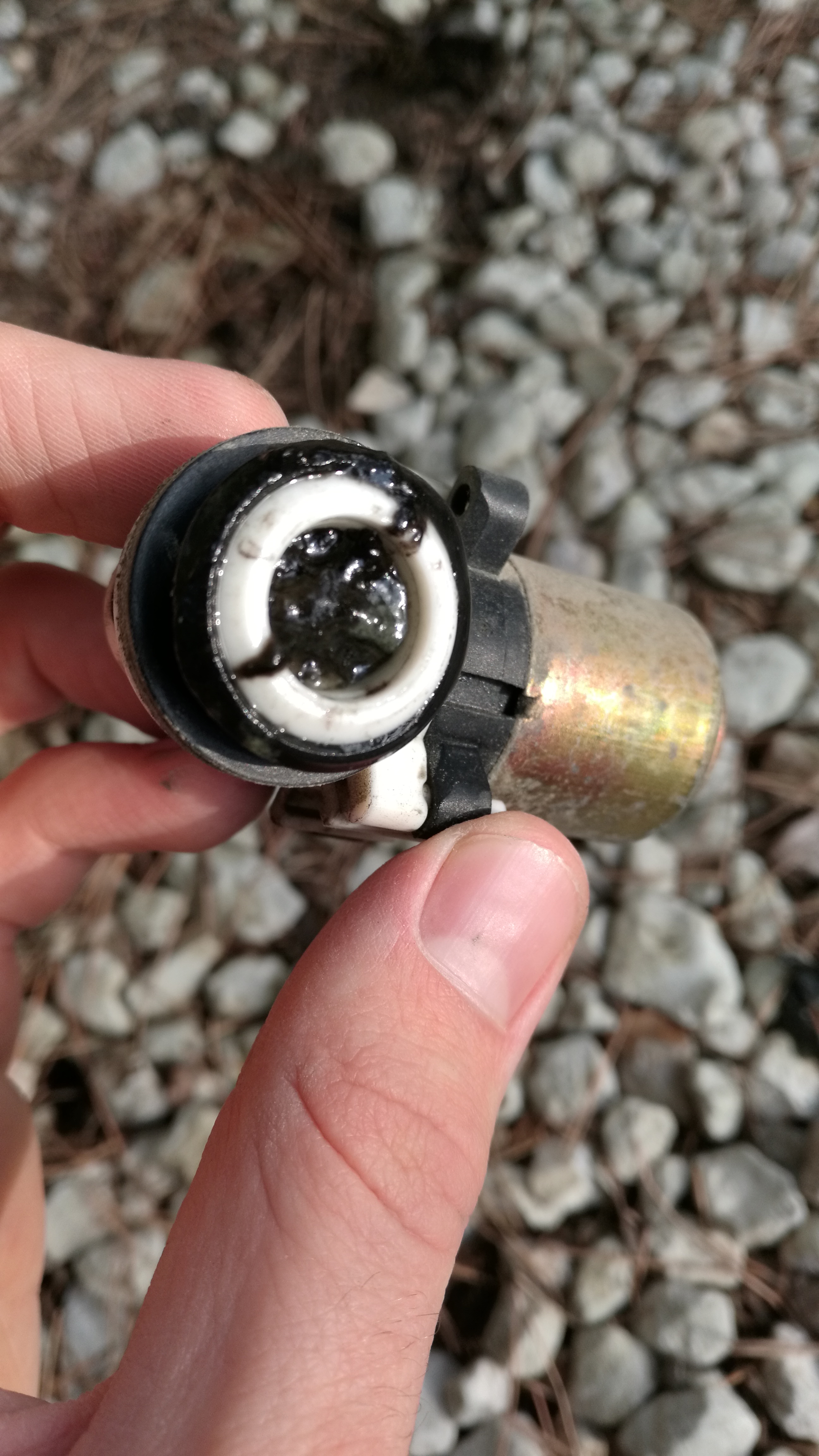

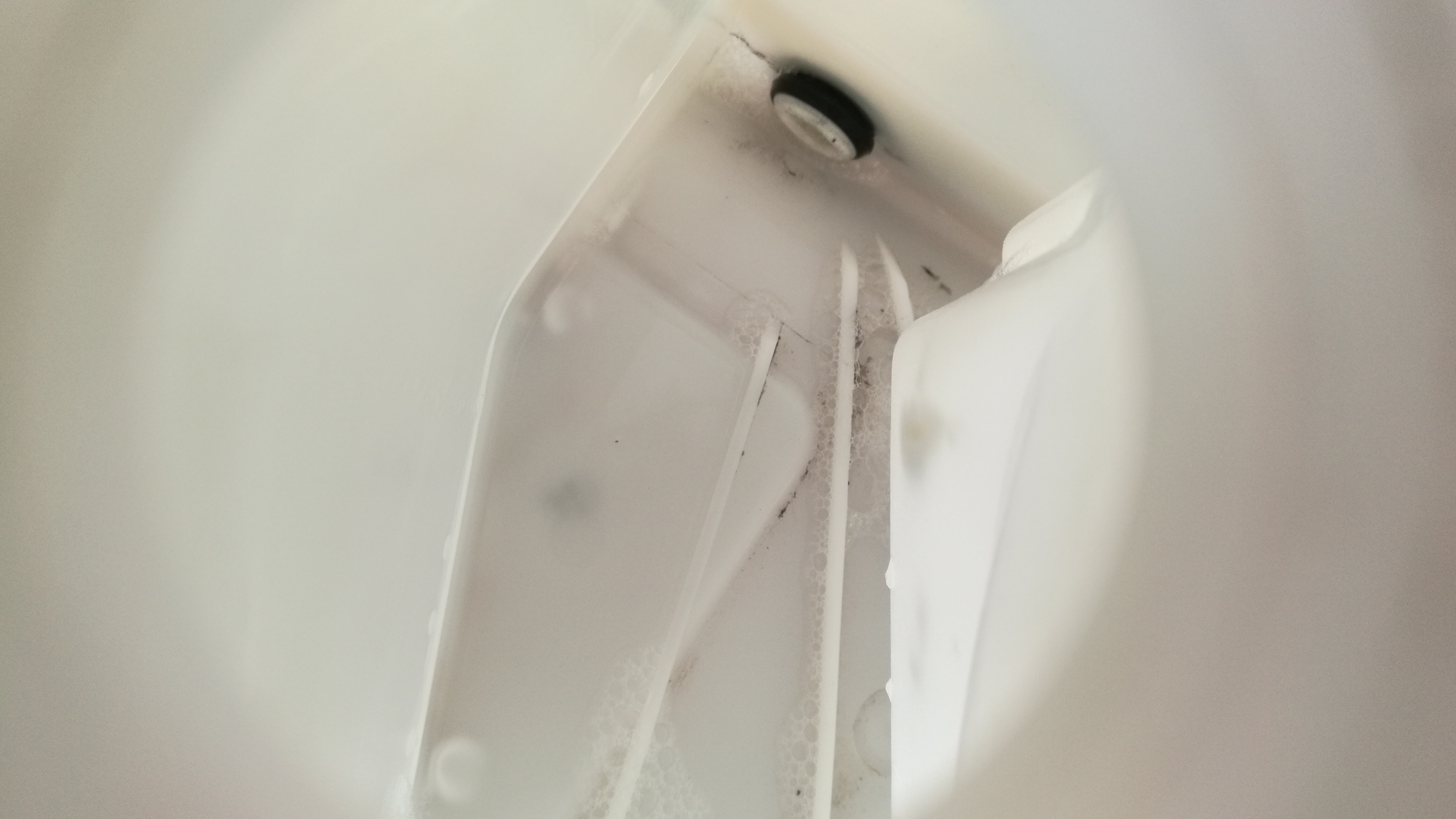

) and then removed the motors/pumps so I could clean it inside and out then I put it all back together and hey presto it worked!
