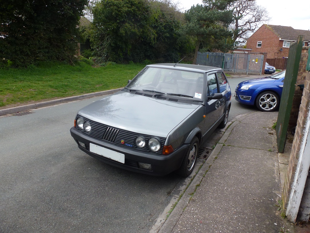

Your cars the same age and colour as mine. Few things that I've noticed from the photos.
Yours seems to have the mk3 cromodora wheels, whereas mine has the pirelli wheels.
Wish I had the skill to attempt something like this, good luck. Here's two photos of my Strada taken a few days ago to encourage you!!

Wow that looks good.
What does it go like?

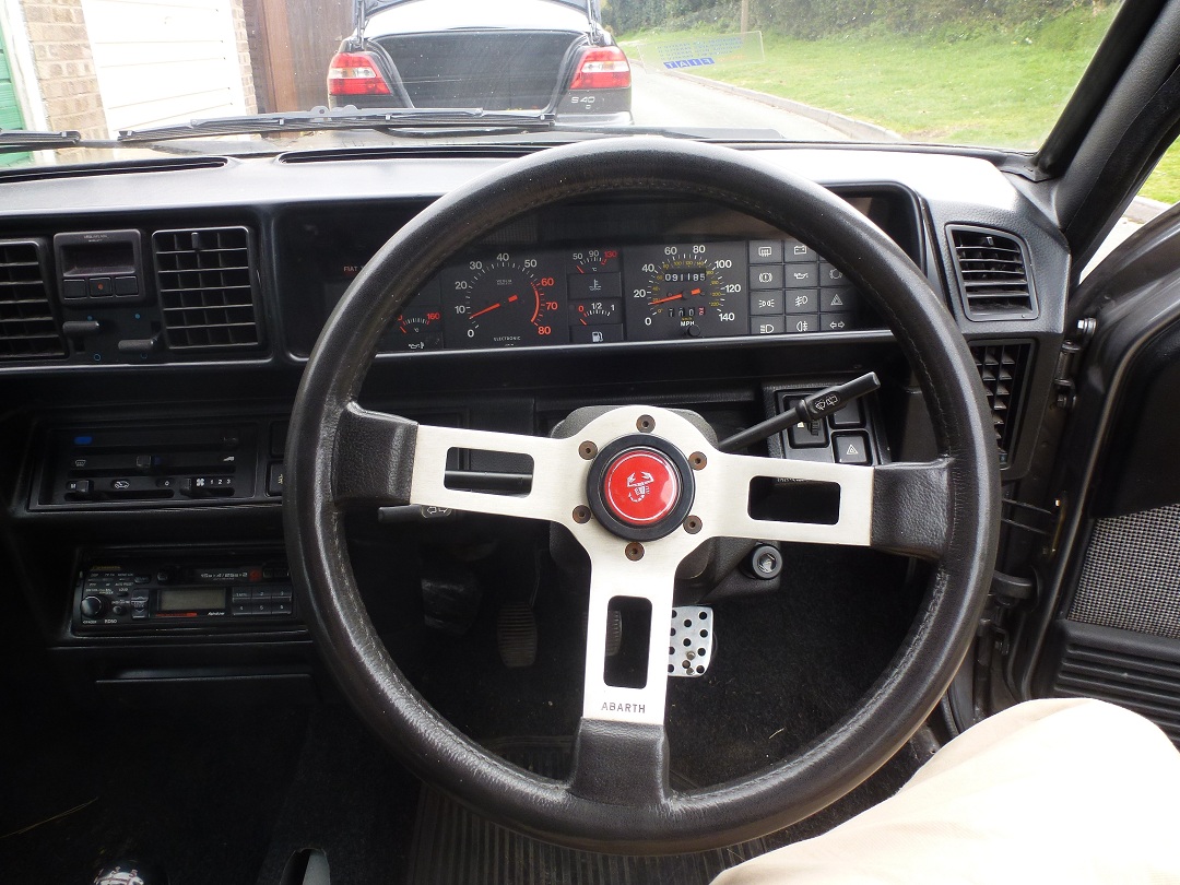

What interior do you have?

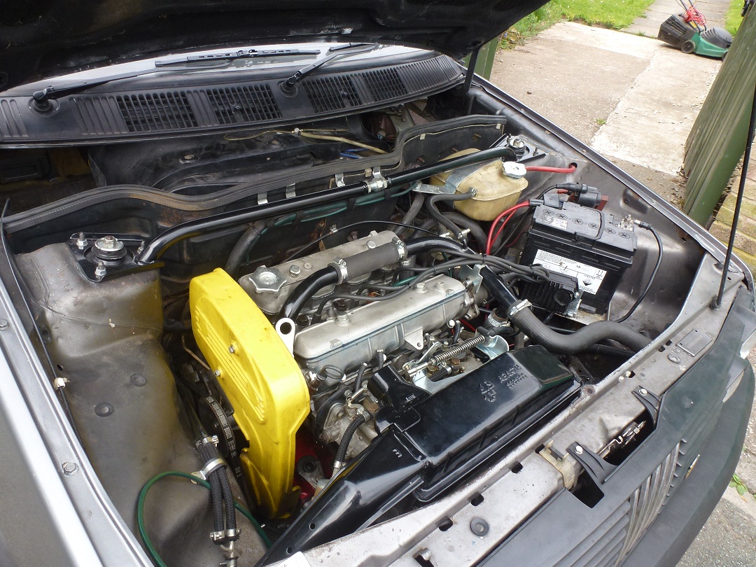

Is there an engine stabiliser bar from the suspension turret to the engine if so mine's missing.

I've had her just over a year now.
Here's some more photos. She's so original that I plan to keep her that way really. Seats were recovered by another owner. It's had an engine rebuild with a Guy Croft cylinder head and a few other mods.
She does need a new exhaust really and I addressed one or two issues with earthing points and non working oil temp sender etc. Currently need to sort out windscreen washers, which is an MOT requirement, didn't realise that Doh!! Quick panic fix involved switching rear and front pumps to get water on front windscreen which got me an MOT, looking for a permanent solution right now.
Yes there should be TWO stabiliser bars. These are secured to the cylinder head above the gearbox with one going backward towards the rear inner wing by the turret and the other going forwards to the front inner wing behind the headlamp.
It is quite common for the metalastic bushes to fail and as no replacements are available the previous owner probably took the bars off the stop the clattering and rattling that would have been happening.
If you find the bars then I can supply the bushes (my own design).

Yep both my bars are absent .
Never mind need to put them on my shopping list.
