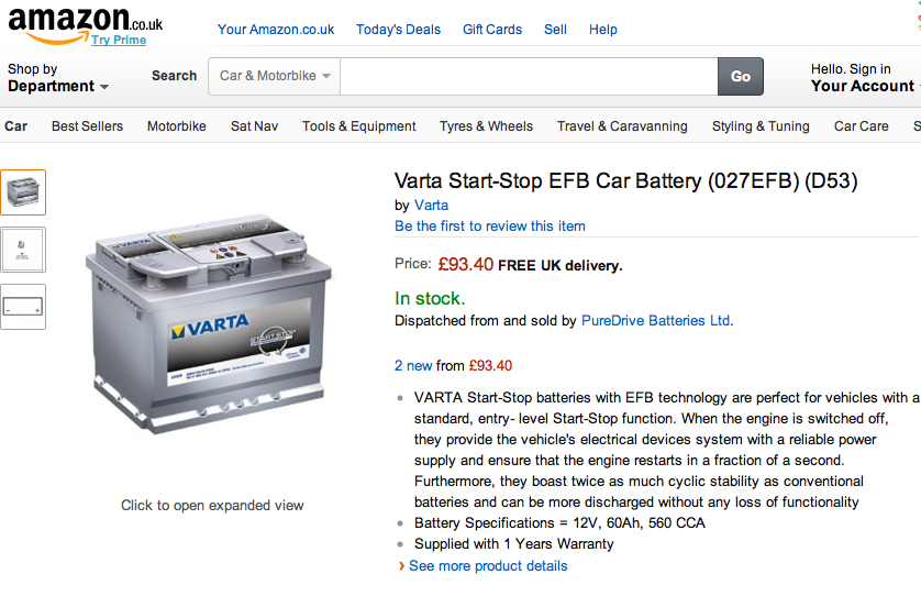

Any road up, I've put my hand in my pocket. :eek::eek:
[ame]http://www.amazon.co.uk/Varta-Start-Stop-EFB-Battery-027EFB/dp/B00842JYQC[/ame]
This had better work.
Regards,
Mick.
This is the one.
Mick.
Well fingers crossed it works.
