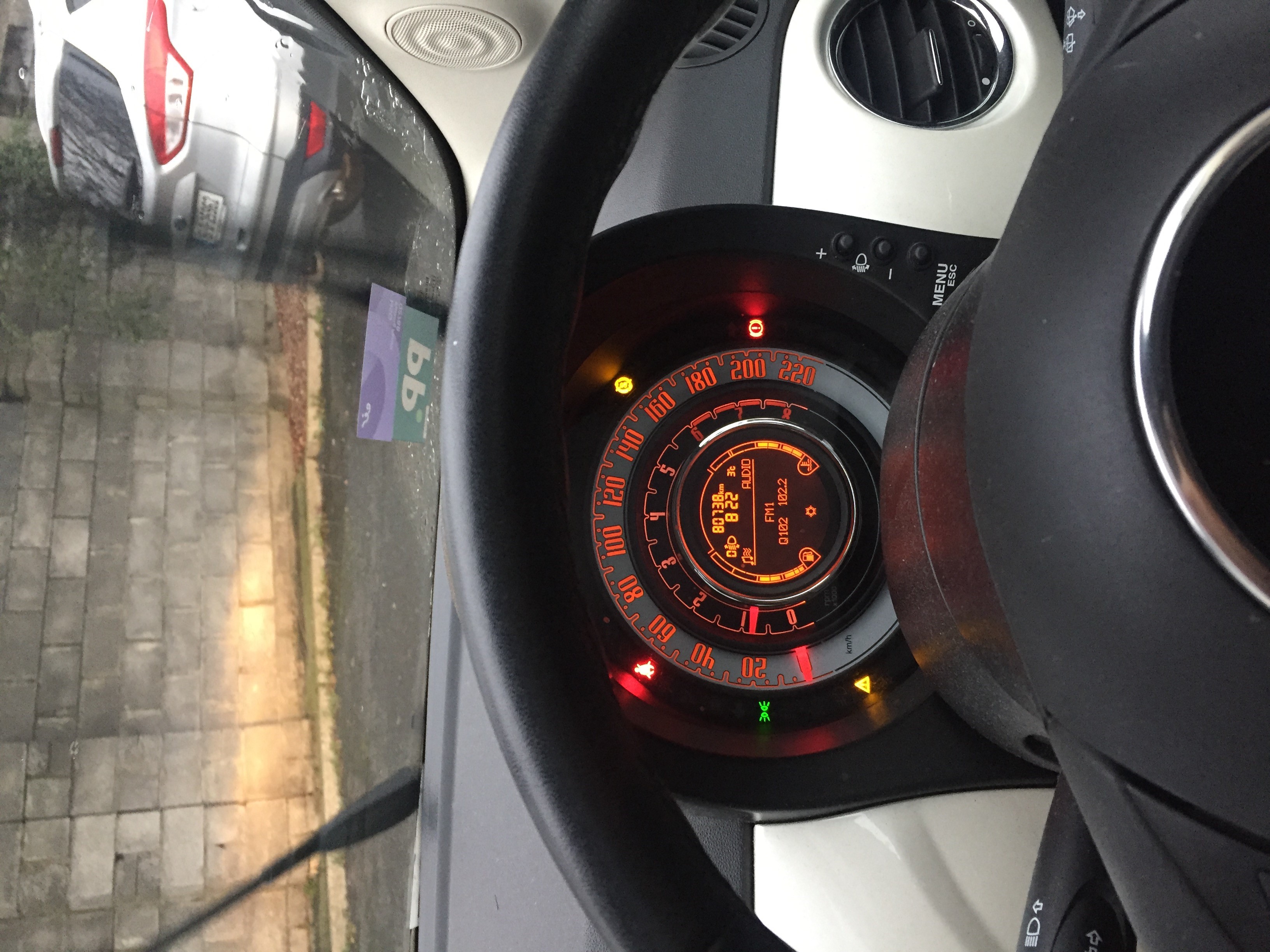

Hi
After driving for 2/3 minutes, the car jolts forward, and the "check engine" and "stop/start" lights flash come up on the dash and stay there. I've had the battery, starter engine and relays all replaced after the car broke down on 3 different occasions and it's still happening.
If this doesn't happen it will just cut out once it goes into neutral.
Really hoping someone can help, I've had nothing but hassle with this car since I bought it.
Cheers
Eimear

Yep, everything else should be fine; they thought it was definitely the starter engine, but it's just been replaced 3 months ago.
What happens if you disable S/S once the engine has started?
(on older 500's, you need to do this each time you start the car; on later models you can also disable S/S in firmware)
If running with S/S disabled prevents the car from subsequently cutting out, then I'd suspect a faulty sensor in the S/S system; if the issue persists with S/S disabled, then the problem is likely elsewhere.

Shows how much they know if they say it can’t be done. Have you actually tried manually disabling it simply by pushing the button on the heater control panel?
It can be disabled within menus certainly using MultiECUScan and I’m sure dealer level software too. Certainly sounds like a sensor issue, especially as its intermittent.
Them replacing the starter motor is ridiculous. It starts the car, that’s it!

I can turn off the S/S through the control panel, like you suggest which stops it jolting forward when I'm driving but it still cuts out if it's in neutral or in 1st with the clutch for any more than 15 seconds or so. Usually this happens for a few weeks/months tops before I just can't get it started at all.
I'm not sure it can on the early cars; on later ones it's certainly possible to disable it permanently. IIRC there are hardware/firmware differences.
I wonder if it could be the gear sensor, or it needs a neutral relearn which MES does. Where are you based? Someone nearby might have MES and be able to help. One of those things that a process of elimination might be the only way, but it must throw up a stored code somewhere.
