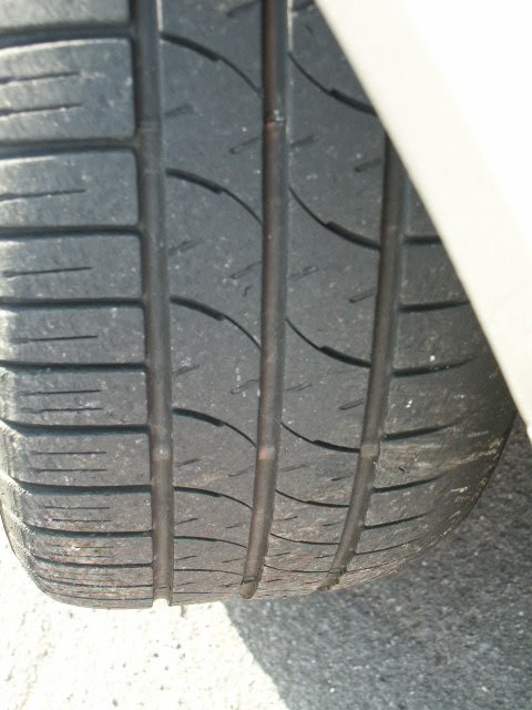

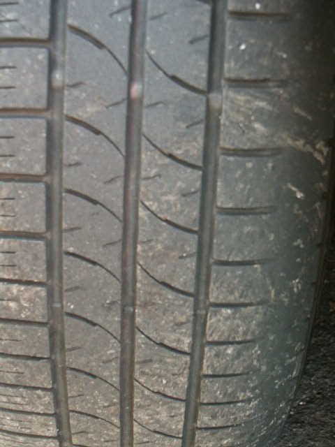

Yup put me down for 2 new tyres - see attached. Not too bad at 12k compared to the other photo example on here. Fiat have agreed to do the tracking plus pay for 1 tyre - I pay for the other. Sticking to Firehawks. Seeing what you guys have said I will insist on castor camber toe in plus tracking being done. Dealer says that "it's just a matter of using elongated bolt holes"!!! ;) :(
Apart from all the info on the FF the only clue I was on the 1st service report which stated that the 2 rear tyres were both 6mm and the front were 5mm o/s + 4mm n/s. Roll on FF (y)
