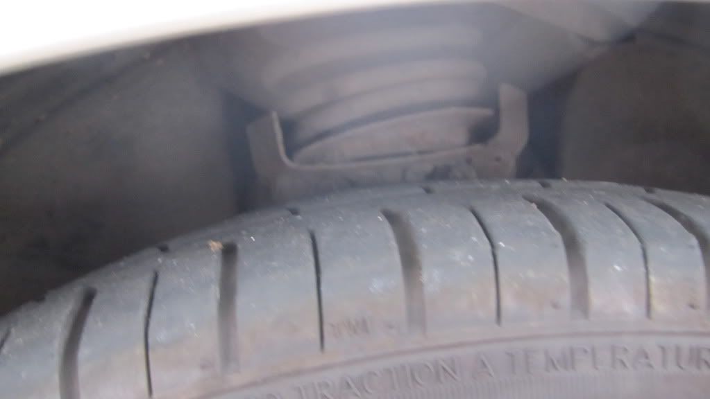

hey i was looking for a cheap option as i dont get my student loans till september which i will be buying coilovers :D SO for now i really need to replace my spring i will upload photos to show you what i mean.
This is passenger side looks fine to me nice and normal i guess then you look at drivers side and

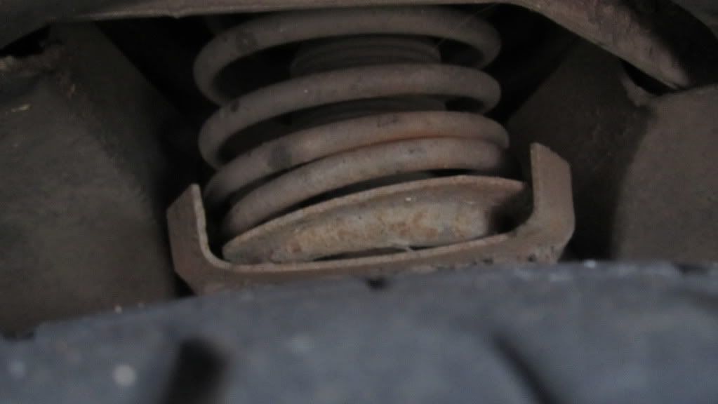

BOOM HEAD SHOT!
looks messed up is this a spring problem or a shock absorber problem?
car feels horrible driving over any bumps in the road.
Thanks
Eddie(y)
Spring busted, very common, there was a recall for spring catchers to be fitted to Stilo's for free to prevent the sharp ends penetrating the tyres....
New pair of front springs required...
If you are going to fit coilovers in a short while I would only replace the broken spring.
I have one such you can have for free. Either collect or pay the carriage.
