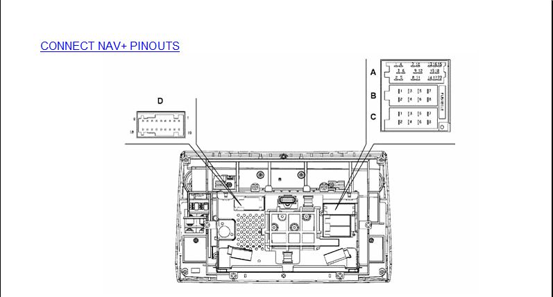

Hi. I know there is a guide on your site..but the link to pins diagram is broken..So my question is ,where do I have to connect that second 12v feed ? And what is for ? Just bought unit of ebay,plug it in..and..unit stucks on fiat logo :D Is there not enough power to run it ? Is this will change if I connect this extra 12v ?? :confused: Many Thanks.
This is the pinout diagram for the Connect Nav+

Stuck? Should still get passed the FIAT logo even without the feed, just will only stay on for 20 minutes and you can only use the radio/cd part of the unit. I would've suggested re-flashing it, but from memory i think you need to have the 12v feed in place otherwise it wont work!?! If you need any help doing the wiring send me a PM, i think i've got a few pictures of it being done on my celly.
Thanks for the pinout Davren, just what I was looking for! I'm building a head unit to replace my old amber-screen Connect unit. Good to see Fiat used ISO stuff where possible.
