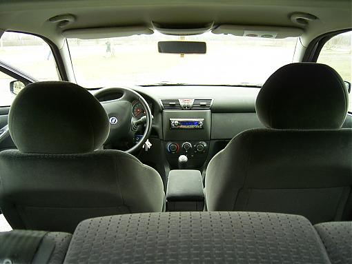

Do you get the impression Fiat don't want anyone replacing the factory head unit? I've got a fascia for a normal din head unit, but I'm sure it would make the cabin look a bit spartan. Has anyone got any pics of a replacement head unit installed, so I can see what it looks like with all the extra plastic?
Re: radio removal
there are from a other persons headunit, and facia, mine has a little shelf under the headunit, so it does not look so spartan
