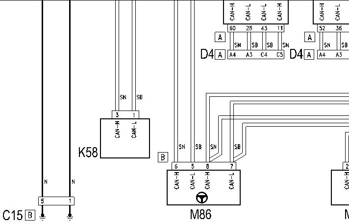

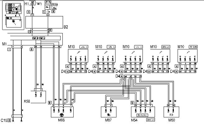

But i'd take a serious look at the D4 connector as that's the bus stop (quite literally) on the way from the steering column M86 to the engine ecu M10
M1 Body computer
M10 engine ecu
M86 steering column
K56 is the steering sensor
