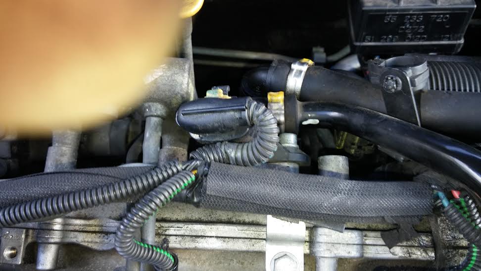

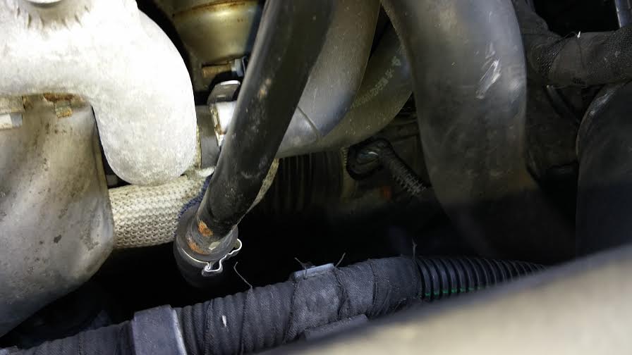

Im really struggling to find this maf sensor.
Ive attached 2 pics of what I thought were right,
The one at the top of the engine that plug I think is the MAF?
The other one shows a plug in the middle Ive unplugged which looks like a MAP.
when unplugging both of them to car can't rev over 3000 revs regardless of how hard I hit the pedal.
Am I unpugging the right things or the wrong thing?

Ah ha - ok so its just the MAF (The one lower down one)
If I disconnect that, yay I get a fair chunk of power back

Yeah its the bottom one lol, I couldn't take a pic of mine to show you what I meant as mine has been relocated due to induction kit lol.

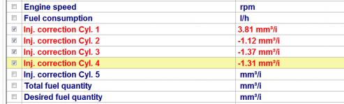

When I plugged my laptop into the car I noticed these readings on the Injectors, why are 3 on minus numbers and 1 positive?
Is that normal??

yes think of it as ecu trying to balance the rpm via injector flow.
so to get a smooth as possible crank speed, its plus on inj 1(maybe suggesting slight blockage, delivering less than required)
so to keep a smooth crank speed its also requesting less on the other 3.
usual is to see 2 minus 2 positive all even values is ideal, close to zero ideal.
I would run a tank of good injector cleaner and keep an eye on them to see if it reduces number 1 down a bit.
also I would recheck at different revs and engine temps like cold start, and hot start, and vary the revs like the sort of logs I did in this thread

I would recommend something like forte injector cleaner, bg244 , or the recent ar6400-cr, over the likes of petrol station redex or carlube stuff not that I don't use them just I don't think theyre strong enough to waste time when you need a cleaner id use them as a maintenance keep it clean now and again.
also try removing the injector plugs and use contact cleaner to clean connections and plug unplug a few times to ensure good connection.
