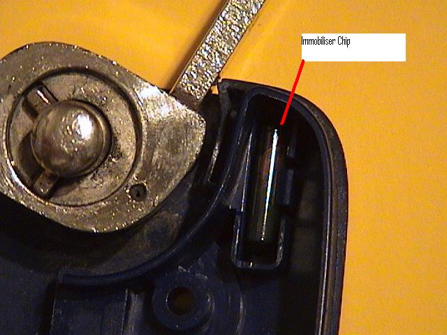

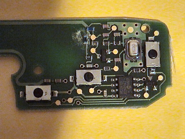

The immobiliser is a totally different part of the fob and requires no battery to work so that side won't be affected.
So your car is not quite happy with the lock/unlock signal coming from the suspect key circuit. As the other key works fine then I'd expect the suspect key isn't putting out a clear recognised or accepted signal but you'd have to take it to a technician to find out
