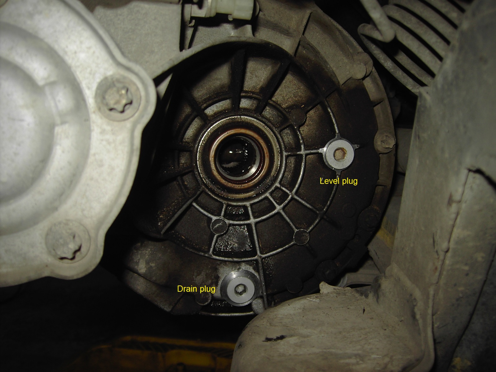

Drain the gear oil. There's an Allen headed drain bolt near the bottom of the box (but facing the wheel/your face .. not "under" the gearbox itself).

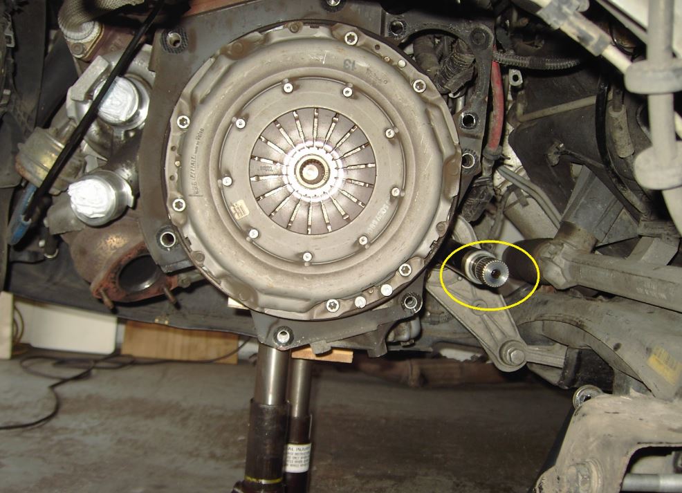

Yes. The driver's side is completely unaffected. I took the o/s wheel off and was halfway through dismantling the driveshaft before I worked out that I didn't need to touch it. Luckily I paused when I got to a bracket that didn't want to unbolt... :D
The nearside driveshaft comes out. I remember I left the "outer" end still connected to the hub/disk and the track rod still connected too... I just stuffed some rags in the CV boot to keep the grit out and then put a small bin liner bag over everything to stop it getting wet/gritty since it was January and I was only working on it over different weekends.
The brake disc/shaft neatly fits behind the wishbone arm (which was left in place... it's not in the way... though the sub-frame "knuckle" it attaches to does get in the way later.
Caliper can be tied to the spring. The damper can dangle (once you have disconnected it from the hub).
The half shaft stays attached to the motore. When you pop the gearbox off you have to pull it out enough for the bell housing to clear the clutch (it'll be fouling the sub-frame knuckle, so it's a bit tight) then jiggle/rotate it forward to get it under the bumper/clutter then pull it out some more to clear the half-shaft.
If it didn't weigh 40 kilo's it's not that bad.. :D Luckily it tends to fall out.. get wedged somewhere and then you have to somehow drag the beast out.
You can jack the car up more just to give you clearance to get the box out from under it. I put a few sheets of cardboard on the ground so that the box has a soft landing when you eventually/inevitably drop it onto the ground .. then used the cardboard to drag it out, like a sledge.
You need burly mates.. but getting the box out could be a one-man job.

thanks so much for the detailed information....bit worried about the drive shafts though. I have partly started removing stuff but the first problem is I haven't got a 36mm socket to fit the hub nut. In your instructions you say you left the driveshaft still connected to the hub. How does the other end (gearbox end) come out?
Also, as I am not removing the offside driveshaft, will I be pulling the gearbox away from the shaft?
And when I am ready to put the shafts back in, I assume I will have to position the gearbox over the splines of the offside driveshaft. Is this correct, and how will I know when they are far enough in?
Sorry to be a pain.
Chris
It just pulls out complete with the CV joint. You may need to apply slight leverage between CV joint and the gearbox.

thanks for the info, I am having considerable problems undoing the rear bell housing bolts, am I missing something, they seem to be impossible to get to
There are only 2 x 17mm bolts and 2 x 17mm studs that hold the gearbox to the engine. What trouble are you having with which one?
Assume you've already removed the starter motor (3 x 13mm bolts) and semi circular plate (2 x 8mm bolts) at the bottom of the bell housing?

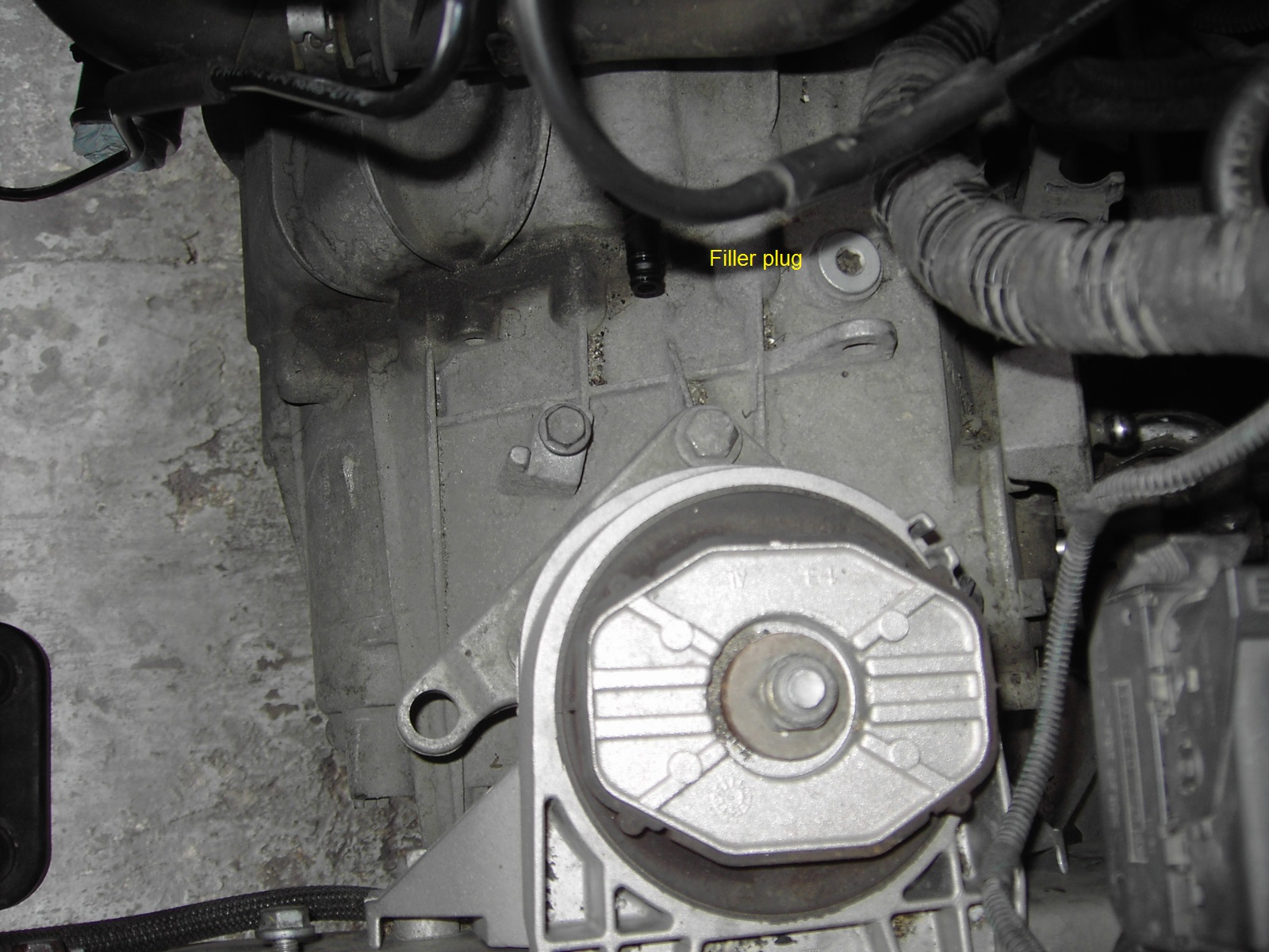

Almost ready to go, but I cant find any information on where the fill plug is for the gearbox. There appears to be one on top of the gearbox but normally they would be on the side so that it would seep out when the level was reached.
If the gearbox is completely empty, you can fill it with the exact quantity of oil (see handbook) through the filler plug on top of the gearbox.
Alternatively, you can fill it by the level plug on the end of the gearbox. The car needs to be on its wheels on level ground for this method.
It needs synthetic gear oil. Fiat specify ZC80, which I think has been replaced by Matrix.
