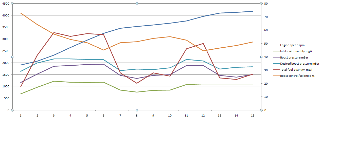

heres your log as graph

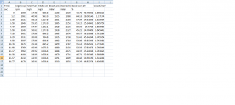

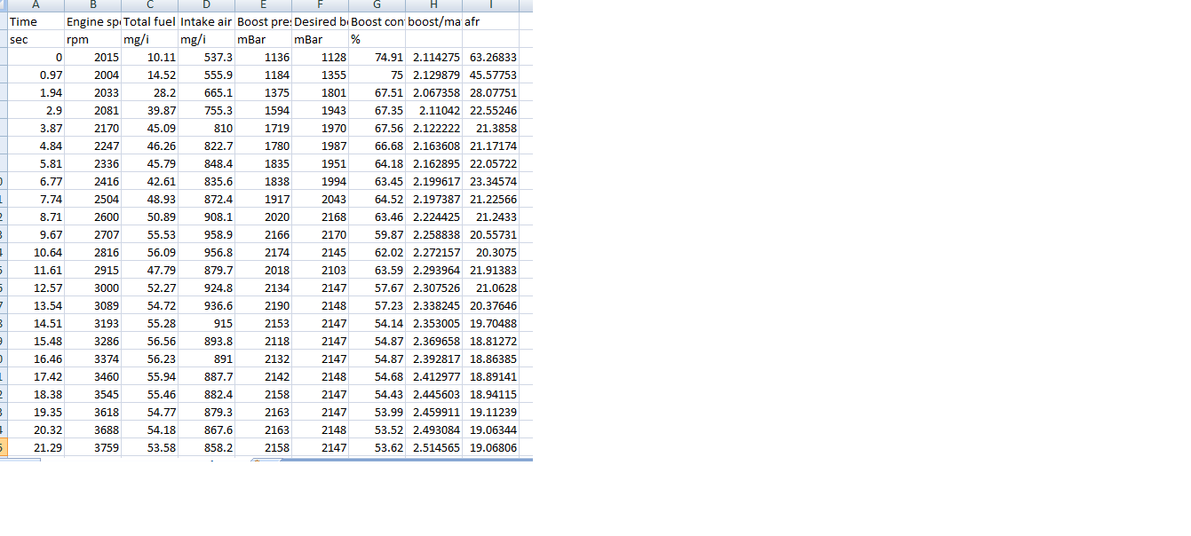

and heres with added data of afr(air fuel ratio) and boost divided by maf(which I use to compare realistic values to abnormal values such as would occur with boost leaks or high low reading map / maf sensors)

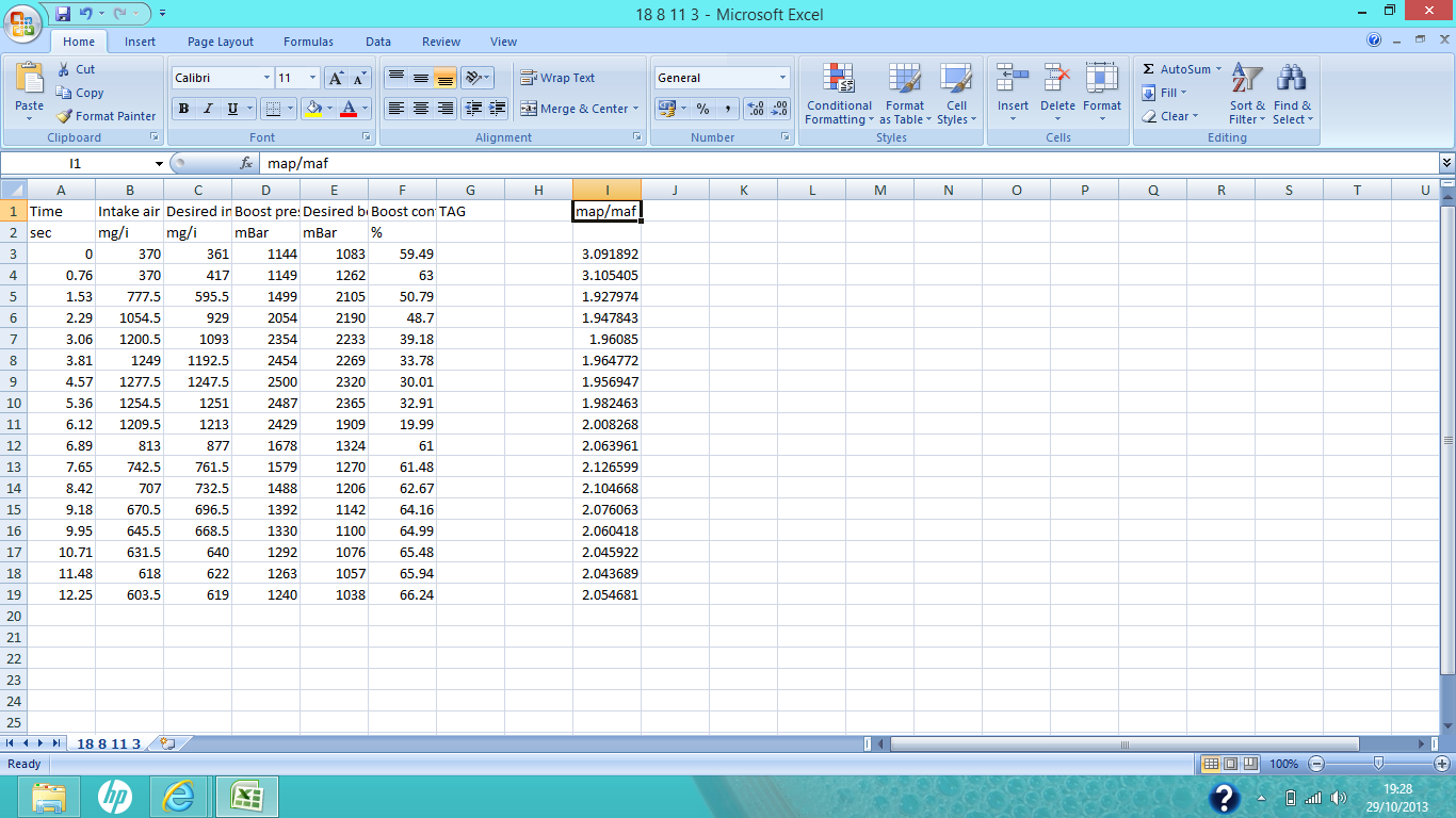

and to compare to one of my logs
as long as egr is disabled/blanked the value of boost/maf has always been around 1.9-2.0 and maybe 1.8-2.0 but as can be seen in your logs value drops a fair bit lower so could be maf is over reading , or map is under reading, maf is real and boost leak is present as an additional issue ?
also the afr only drops to around maybe 24 I would expect this to be fairly clean burn, a faily smoky figure would be below 16-17afr maybe and black smoke less than 15afr possibly, so again leads me to think the air the maf is reading is not getting to the cylinder so possibly a boost leak or again maf reading is falsly high?

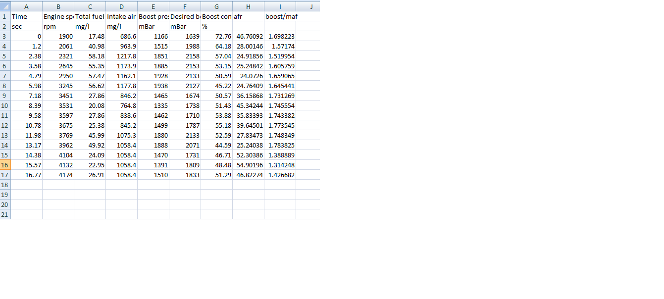

heres your old maf log

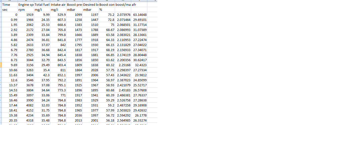

and here are the other 2 with new(used )maf
as you say boost has increased for sure but as a consequence of maf change or that temperature sensor in maf ?
looks like vnt is nearly 10% higher to achieve actual boost in later log, theres still a possibility that your map sensor is over reading or that new maf is under reading slightly(or possibility of air leak after maf from split turbo inlet pipe or common broken vapour trap under airbox, letting unmetered air in that bypasses maf giving low reading).(having replaced the maf any chance its loose clip around hose ?)
