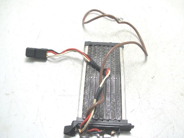

An electric PTC heater was available for the diesel Stilos. Not sure if it was an optional extra, but it wasn't fitted to all diesels.
Perhaps it was part of the "Cold Weather Pack", along with headlamp washers, heated seats and heated windscreen washer jets.

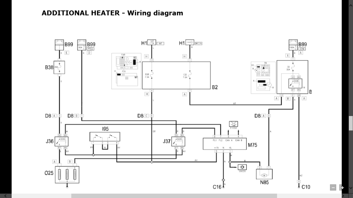

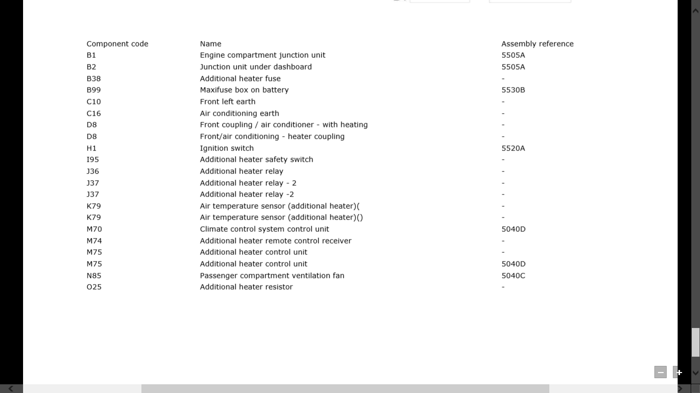

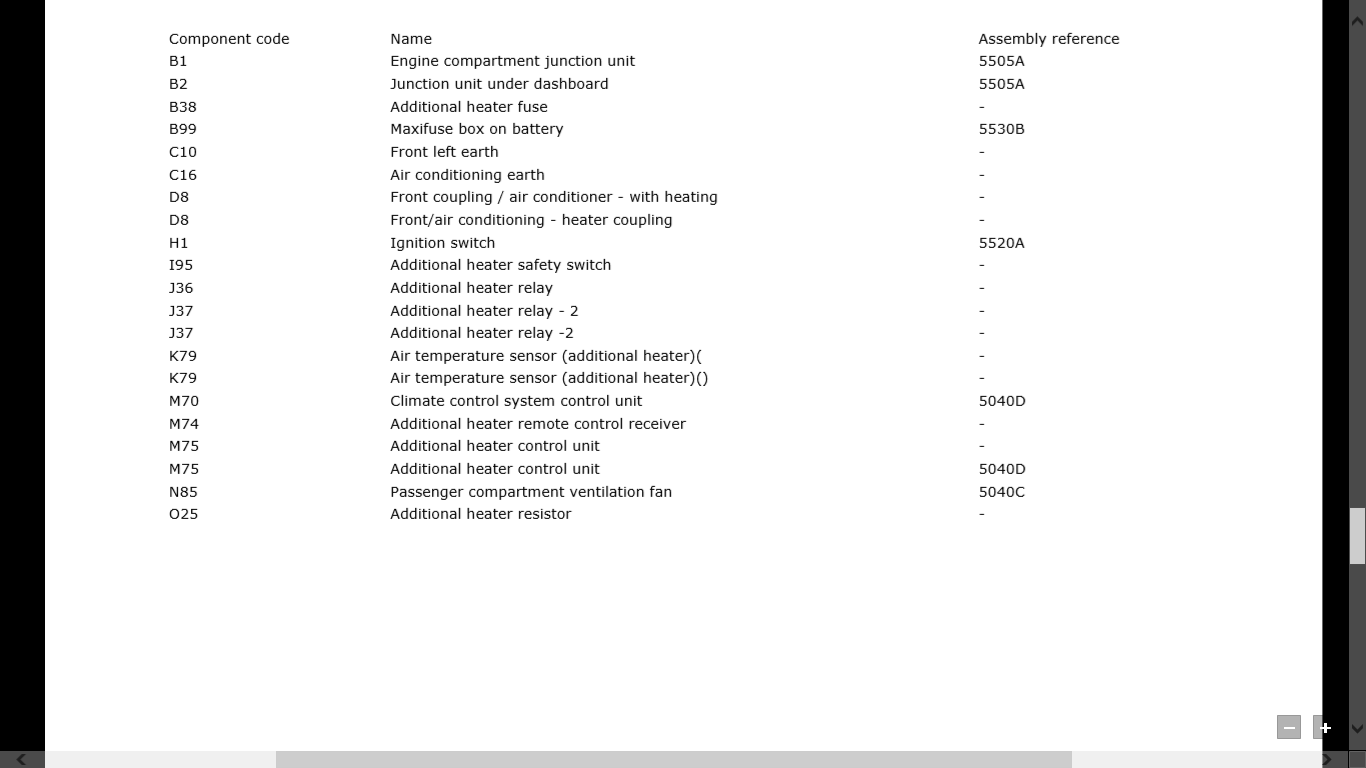

like to get to the bottom of this.
on your info looked into fuse section of manual and have found listed
additional heater(multijet versions) f73(midi fuse) 50amps figure 61 shows its the battery pos terminal fuse box and is the one next to the 150amp maxi fuse for the ecu(f70)
wonder if it is activated via heating knob and fan speed and needs aircon compressor running?(manual climate control) this is all the manual says to get fast defrosting or demisting and I don't usually have aircon on(and also usually have heat knob on cool to speed up engine warming)
if I havnt got it id like to retro fit it if possible, any more info like part number or wattage ?
edit
just been out to have a look for that fuse and ive got nothing there just an empty space and no wire to it ,
so to retro fit would require fuse , wiring , activation button/circuit, control circuit, relay and heater matrix , if theres even space for it in a standard unit (unless it could slot in where the polon filter sits)
found this too much for me to be bothered with it might help others who consider it
http://www.google.co.uk/url?sa=t&rct=j&q=&esrc=s&frm=1&source=web&cd=8&cad=rja&uact=8&ved=0CFYQFjAH&url=http%3A%2F%2Fforum.fiat-bg.org%2Fdownload.php%3Fid%3D47242&ei=4DeDVKCRCYbvUuDpgPAP&usg=AFQjCNHydE0UWwtLKRrJyJX84P5Cx3-7eA&sig2=o9tn2-0QGgqQD0tR_gR2GQ&bvm=bv.80642063,d.d24
should open a elearn pdf
