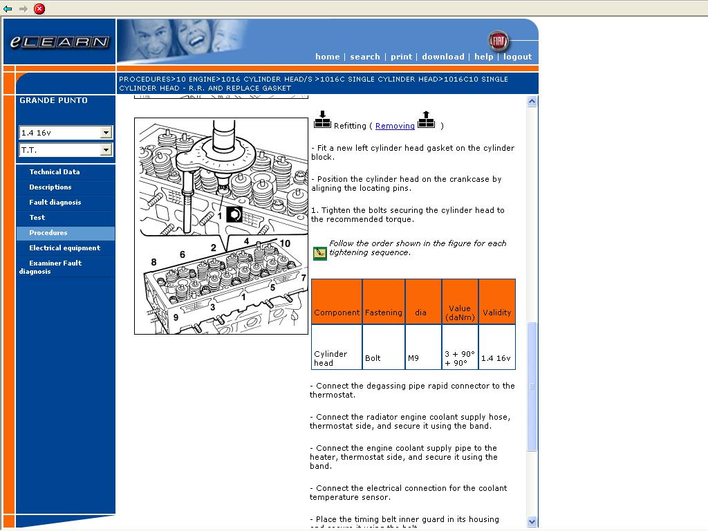

hi just wondering if anyone knows the tork settings for the head bolts ?? its a 1.4 16v. and what tools would be needed ?

I need the cylinder head torque settings for a 1.4 16v Stilo ?

Dont forget you will also want to know the correct torquing sequence
This is for the Grande Punto but going by the above figures it looks to be the same engine .... (just double check first ;) )
