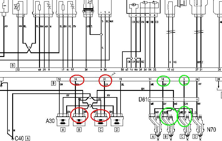

Ok the fact that the problem disappears when you change a coil might point to simply a poor connection in the wiring from the ECU to that coil. That would give you all your symptoms and without the need to change coils or plugs
Diag shows coils A30 leading to the ECU
So I'd check and clean up connections here (red circles)
N70 are the injectors
A misfire of course can also be caused by an injector or wiring (green circles) to that injector. Knowing the stored Fault Codes can be helpful here.
