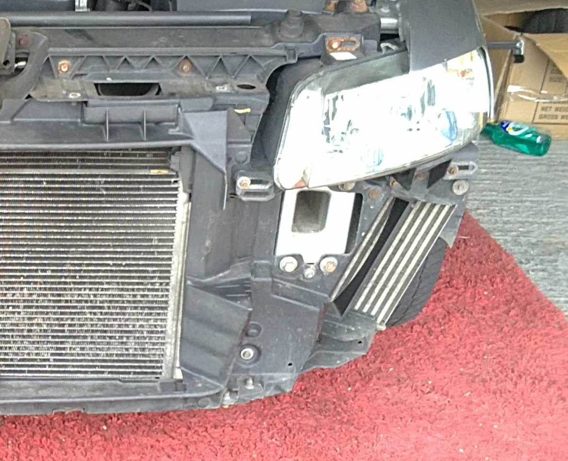

My only concern for you is i think i mounted the N/S light where the inter-cooler sits on the JTD, can you confirm if the "space" behind where I've mounted my N/S light is vacant (bar one slanted almost vertical plastic strip)?
Here's a photo of the front passenger side showing the intercooler(bumper reinforcement removed).
The distance from the rear of the bumper to the face of the intercooler tapers from 220mm down to 65mm over a distance of 150mm.
I'm sure I have enough room to install a similar set of lights if I can figure out the best way to mount them. Possibley steal your idea. ;)

OOOKKKK, it MIGHT work for you because your light units are nowhere near as long as mine, mine are about 8" front to back, maybe 9" :S.

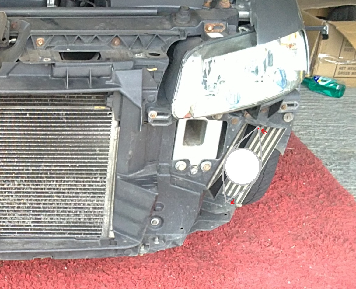

The yellow circled bit, i cut away and where it is marked with red dots i drilled holes to attach the mounting bars
In this one i've drawn effectively what i have....the silver "curves" are the alu. strips, red dots denote fixing points to the front panel, and red arrows denote the direction of the bolt (top one goes right-left bottom one goes top-bottom)
feel free to steal my idea, it works well as that "plastic" isnt really plastic, its got some fibres re-enforcing it, so its very strong and doesn't break without quite a bit of force.
ill try and get a few photos up this weekend, but you get the jist of how i did it?
