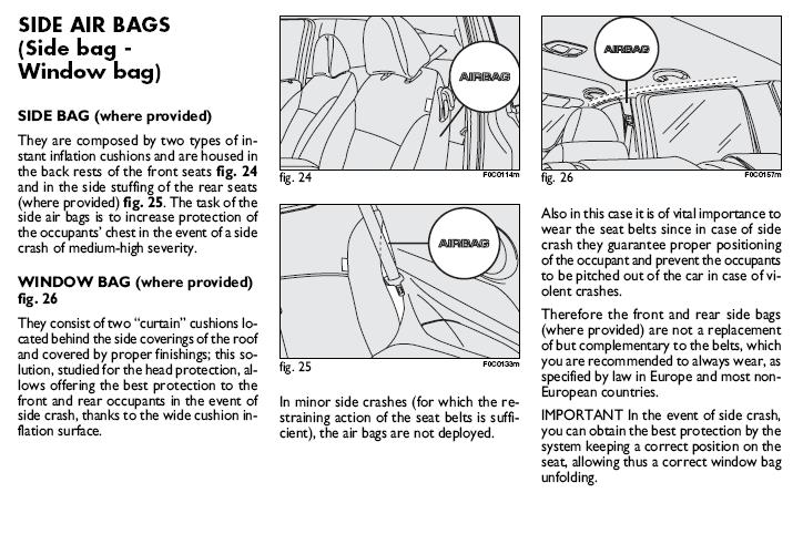

Code 14 -drivers side airbag squib is driver's -side air bag rather than "drivers side" air bag. With me?
Side air bag just for reference (no need to remove this)
So side air bag connector is here. Electrical contact cleaner to clean up the contacts and might be a cheap and cheerful fix
