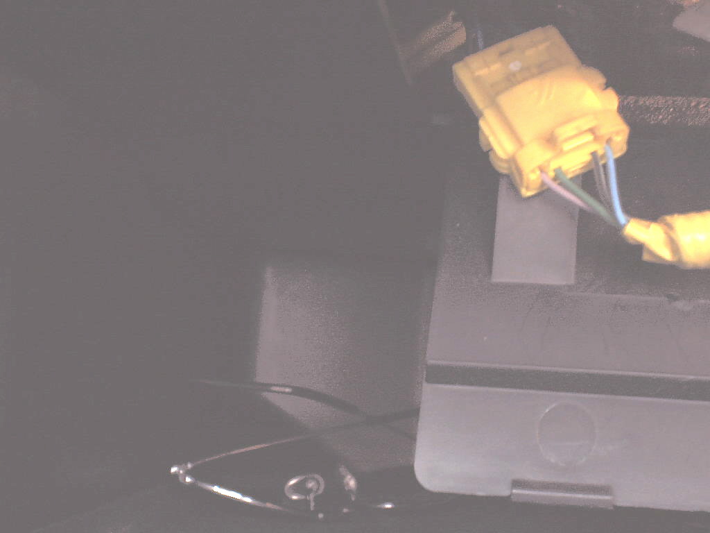

in the roof of the lower glove box compartment behind drop down panel

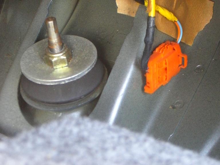

over the rear rh tyre well behind pull out oddments pocket
There are others but i'd go for those easier ones first

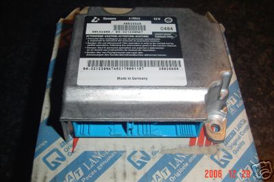

The airbag ecu connector itself in the centre console or even the steering column airbag coilspring
It's a guessing game once you've gone for the easy ones and it can be quicker to bite the bullet and have a diagnostic done to point you in the right direction
