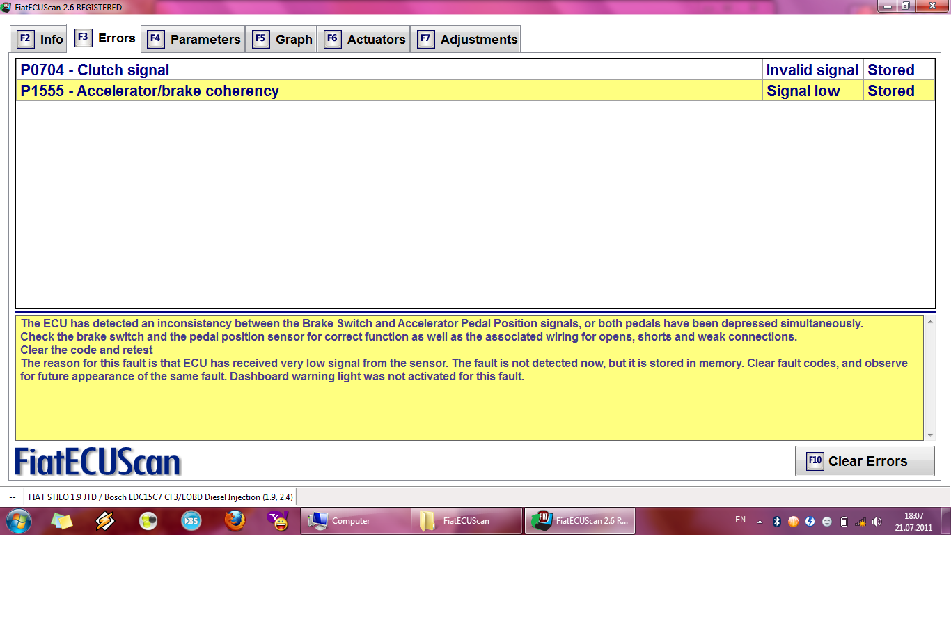

the results of the FiatEcuScan.
2 errors stored, replaced the brake switch yesterday, so i cleared the errors.
So what can you tell me about the other error? I wanna say that i changed my clutch pump last week, so i guess the erros was from then?
i erased them and didn't appear again.
Opinions?
Opinions?
P1555 just means that the brake pedal and the accelerator pedal have been pressed at the same time. The engine management ECU doesn't expect that to happen so it shows as an implausibility fault.
Davren - you right, that was before replacing the brake switch, the old one was so sensitive, even my foot shadow light up the brakes, and sometimes the brake lights were stuck--> so brake light ON + acceleration= simultaneously pressing. So i replaced the brake switch.
As i said i delete the errors, i drove a little bit, around 2 kilometers, no errors reappeared, so hope to be good.
the clutch error can come from the clutch switch too?
