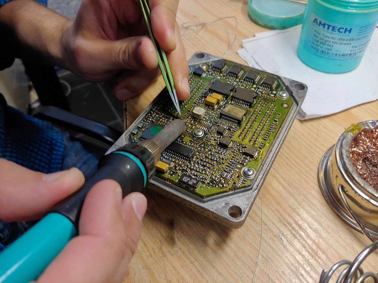

I checked o2 sensor wires from sensor to ECU, the problem was not with the wires, but with the engine ECU. There were several resistors and capacitors unhooked. I soldering resistors, condensators around the socket contacts. After this repair engine run idealy.
2. Temperature rose above normal (>90o), although engine was cold, I changed temperature sensor, did not help. After reading on internet forums I again started looking for a problem in the ECU unit, there was the same problem, several resistors were soldered poorly. After resoldering, temperature went to normal.
At the same time I resoldered all 128 connector contacts to prevent similar problems.

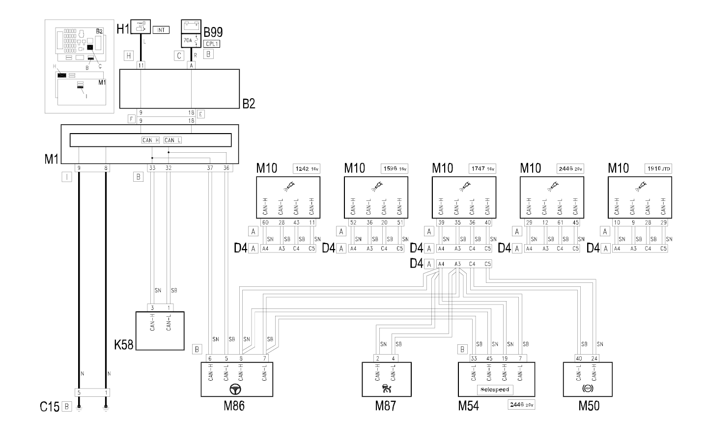

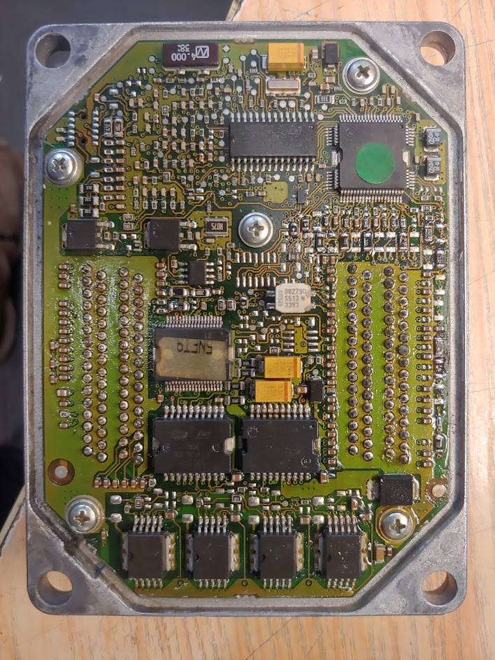

I started looking for a problem by checking CAN lines, but I didn't find a problem with it. One way to check was by turning on the ignition and allowing IMMO to detect the key, then disconnecting the D4 to connect near battery, then I started the car I started on the LPG, since disconnecting D4 connector the petrol pump wont work. The car engine still randomly stoped working. All information on the Internet linked to the same problem, something is wrong with the engine ECU. Then I decided to re-solder everything what can I see from visible ECU PCB side.
After a long and tedious work (~1-2 hours) everything was finished. Now I'm driving, the problem is gone.
