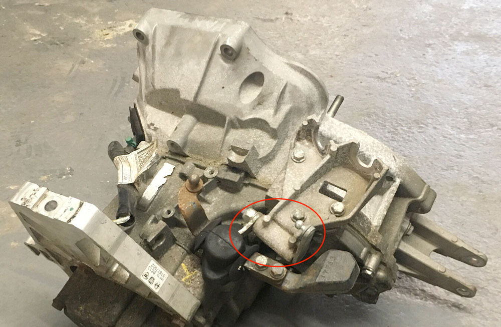

Hard to make out from that drawing - but I've marked what I think it looked like on a photo I've found online (not necessarily a Panda gearbox). The cable connects to the ball at the right, and then a rod passes inside a cast section before reaching the nut. I lubricated that by dripping oil in the nut. (If not this exact part, certainly one that looked very much like it :) )

Glad that worked for you,. In the case of my 2013 Panda, and that of @landie9, lubricating the ball at the base of the gearlever inside the car had no effect, nor did lubricating the cables themselves or the joints on either end of them, - because the problem was corrosion (likely from winter salt) causing part of the mechanism on the outside of the gearbox itself to become stiff... hence the more involved replies.
... I've marked what I think it looked like on a photo I've found online (not necessarily a Panda gearbox). The cable connects to the ball at the right, and then a rod passes inside a cast section before reaching the nut. I lubricated that by dripping oil in the nut. (If not this exact part, certainly one that looked very much like it :) )

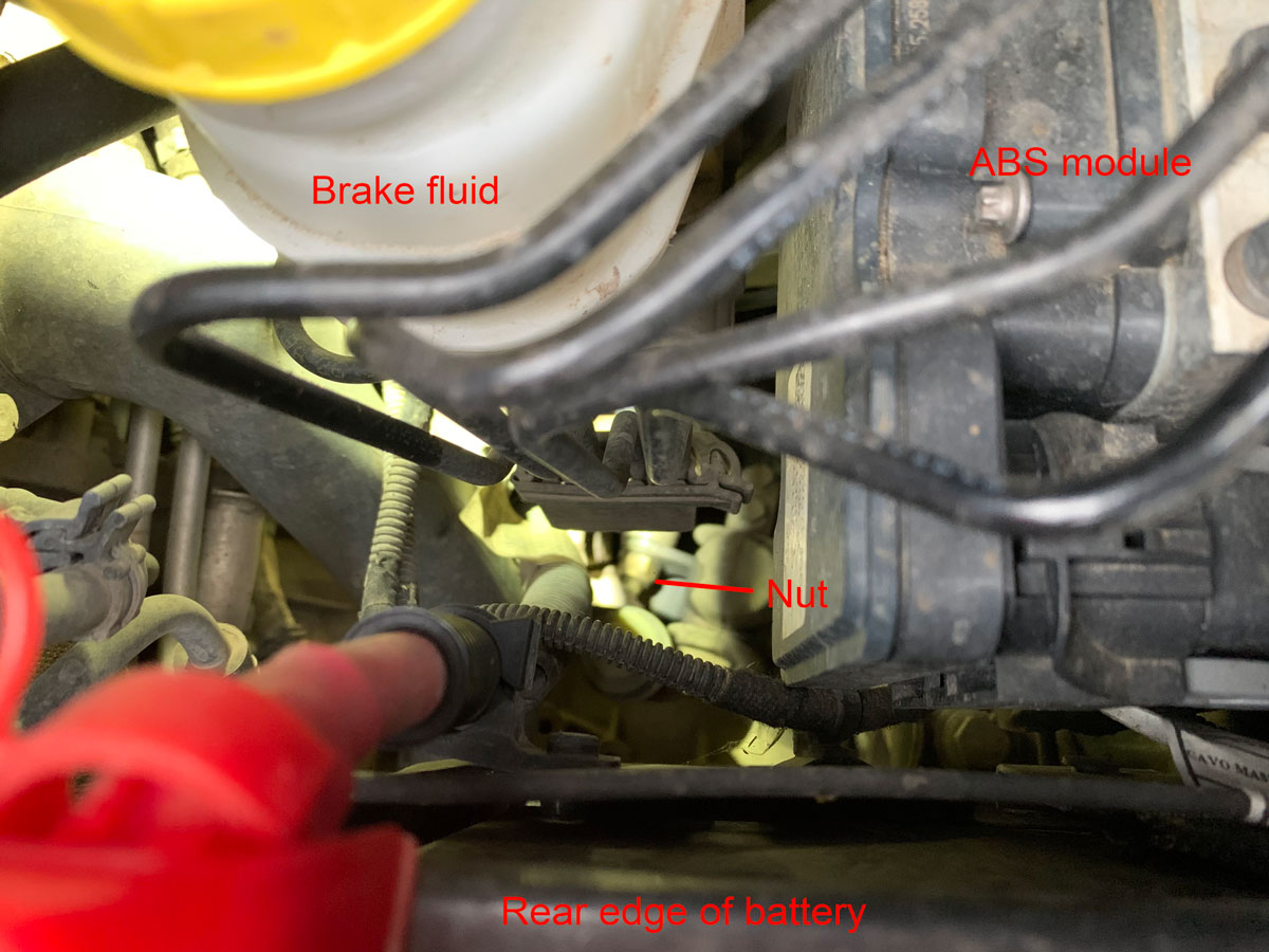

Bouncing this back up, as my 2018, 31,000 mile Panda 4x4 MJ has today also suffered the same problem as my previous one - the gear-lever became stiff and didn't 'spring' to the central portion of the gate.
As before, the problem is stiffness were a metal rod passes through a casting in the gearbox outer casing (and as before the stiffness occurred a few days after driving through flood water, so assume corrosion between the rod and the casing causes the problem).
This time I have managed to (just about!) squeeze the iPhone camera in behind the battery to show where the nut is on the end of the rod in question. You might just make it out in the photos - which gradually get closer in, having first 'set the scene'. See if you can compare these views with a photo of a similar gearbox 'out in the open', which appeared in my earlier post, and can be seen here: https://www.fiatforum.com/attachment.php?attachmentid=207449&d=1585775210. in that photo, the red circle is drawn around the whole unit in question: the gear lever cable that moves when the lever is pushed from side to side connects to the balljoint at the right side of the red circle. The nut is at the left. the motion of the gear-lever is turned through 90deg by this mechanism to move the selector system up and down inside the gearbox, via another rod which is under the large rubber cover just to the left of the red circle.
Applying a drop of oil between that nut and the casting, and wiggling the gear-lever to get the oil to move down into the casting has cured the problem. I used a kids paintbrush on a bamboo cane to apply a drop of engine oil here!
