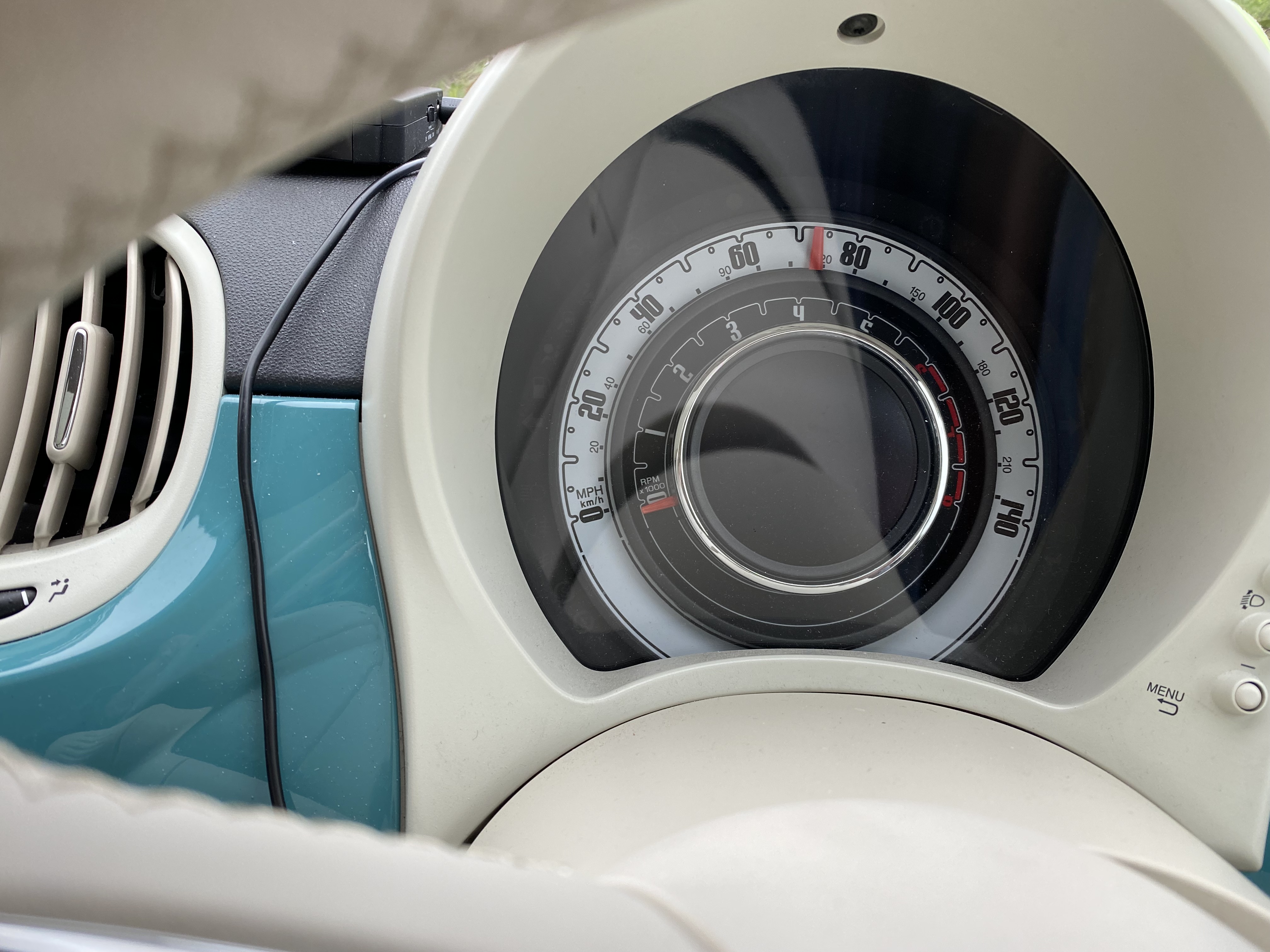

Not TFT and as you can see it is stuck again.

The speedo issue has now been resolved. In the end we had to revert to the main dealer and have a New unit fitted at circa £700. It was also pointed out that when it's next service is due in Nov this year the car would be 5yrs old and the recommendation would be to have the Cam belt replaced. Prior to this my OH was considering getting a new 500 but her hopes were dashed when she was told: Fiat had decided not to produce anymore 500's with Dialogic transmission from around Sept. last year, so a new Fiat is now out of the question. So mayee having to look elsewhere for other small cars with 'Auto' box. OH cannot do Manual due to Clutch operation causes discomfort, after major surgery, to left knee. So looks like end of an era for her.
