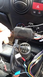

I decided to change the stereo in my Fiorino as the quality of handfree calls on the blue & me is awful so I fitted a Kenwood DAB unit with built in handsfree that we used to have in our old Mini.
As I wanted to keep the steering wheel controls I bought a Connects 2 CTSFA004.2 steering wheel control interface from Dynamic Sounds. It's a great bit of kit because as well as making the steering wheel controls work it also does away with the need to run a lead from the power socket to the stereo to overcome the lack of an ignition fed live. :)
Oh and if you upgrade your stereo to a head unit with built in bluetooth hands remember to unpair the blue and me from your phone before you start the install.
