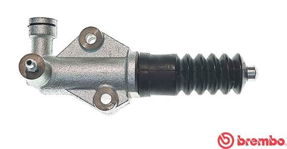

If the clutch pedal is stiff it might be the clutch slave rather than the clutch.

If you're lucky it'll be the clutch slave, you can see one below. Fixing that is relatively easy and cheap.

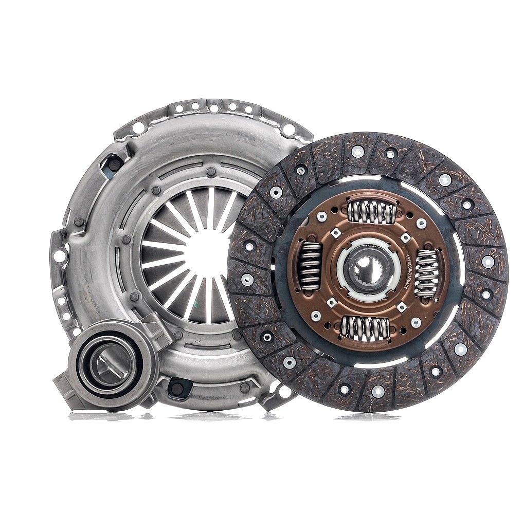

If its the clutch itself then its a bigger and expensive job to fix, those discs are pictured below.
thanks. Is it possible there are two of those slaves in the fiat punto ? I had the issue with that car before this one, and the garage first replaced one (the outer one, easier and cheaper) and then the second one. Somewhere near the pedal, i think
well my neighbour (owned a garage until recently) replaced the clutch and it's fixed now so at least that issue is gone.
