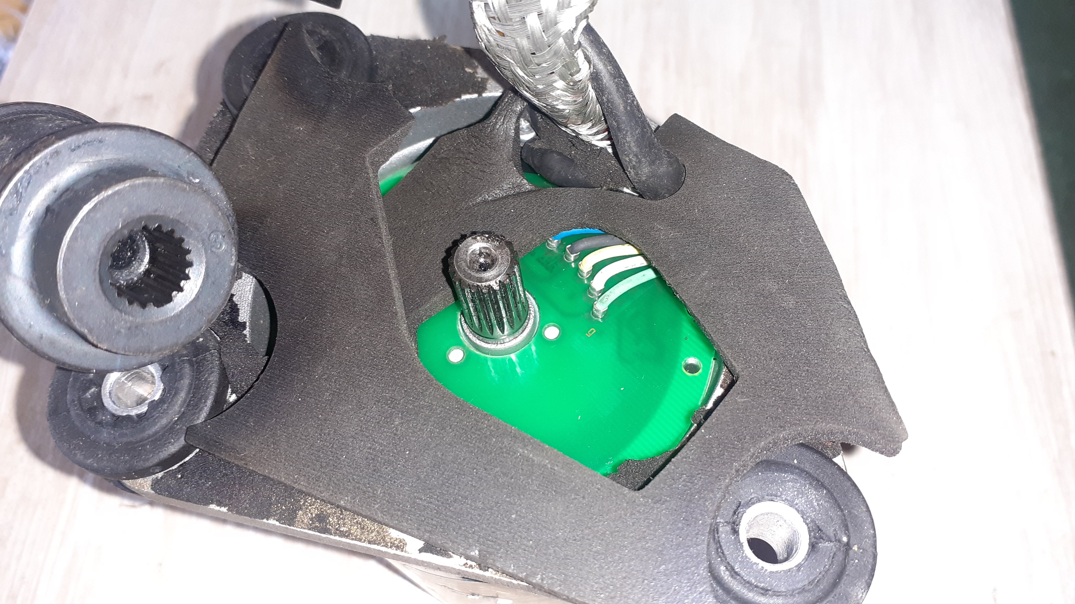

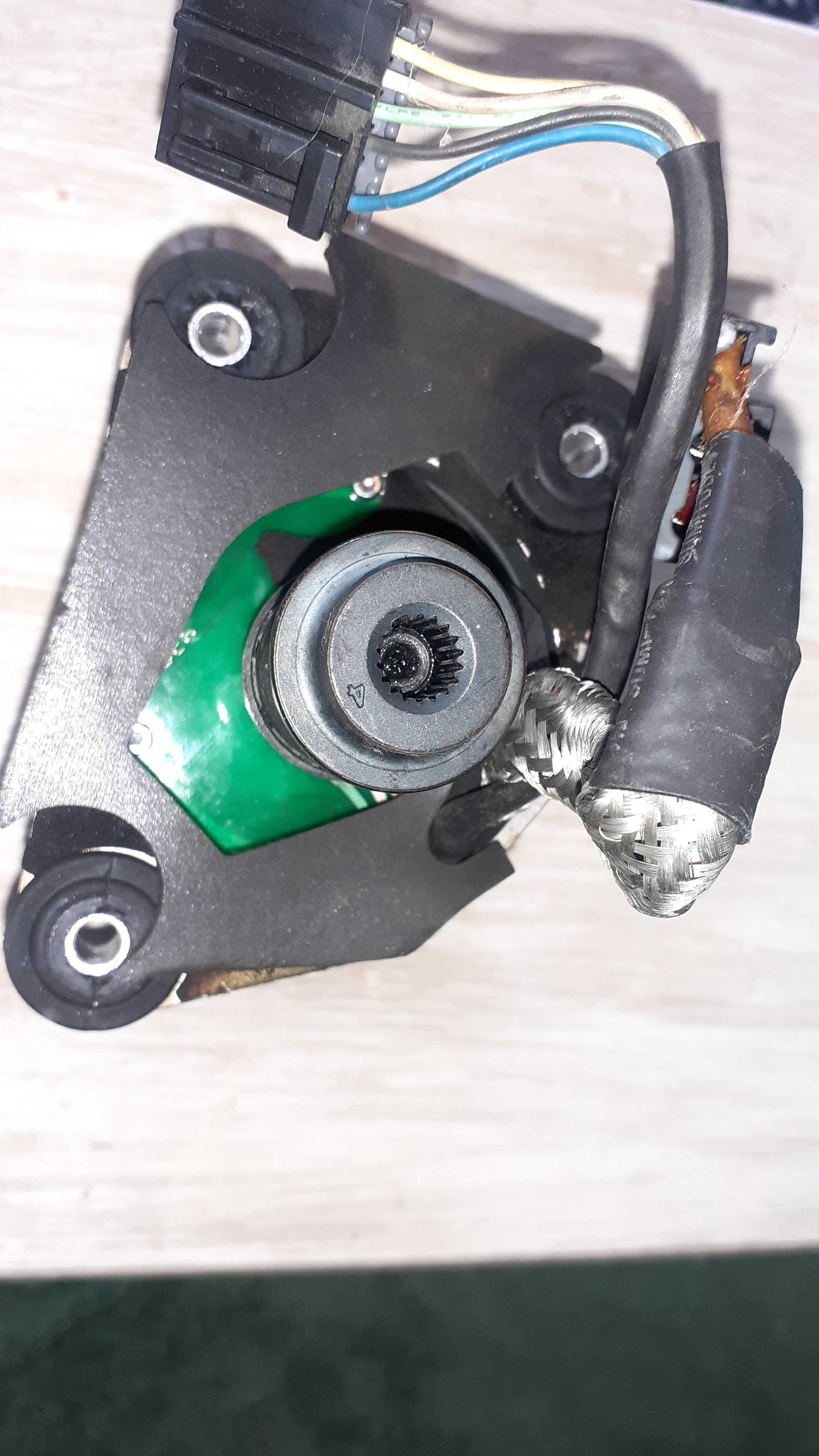

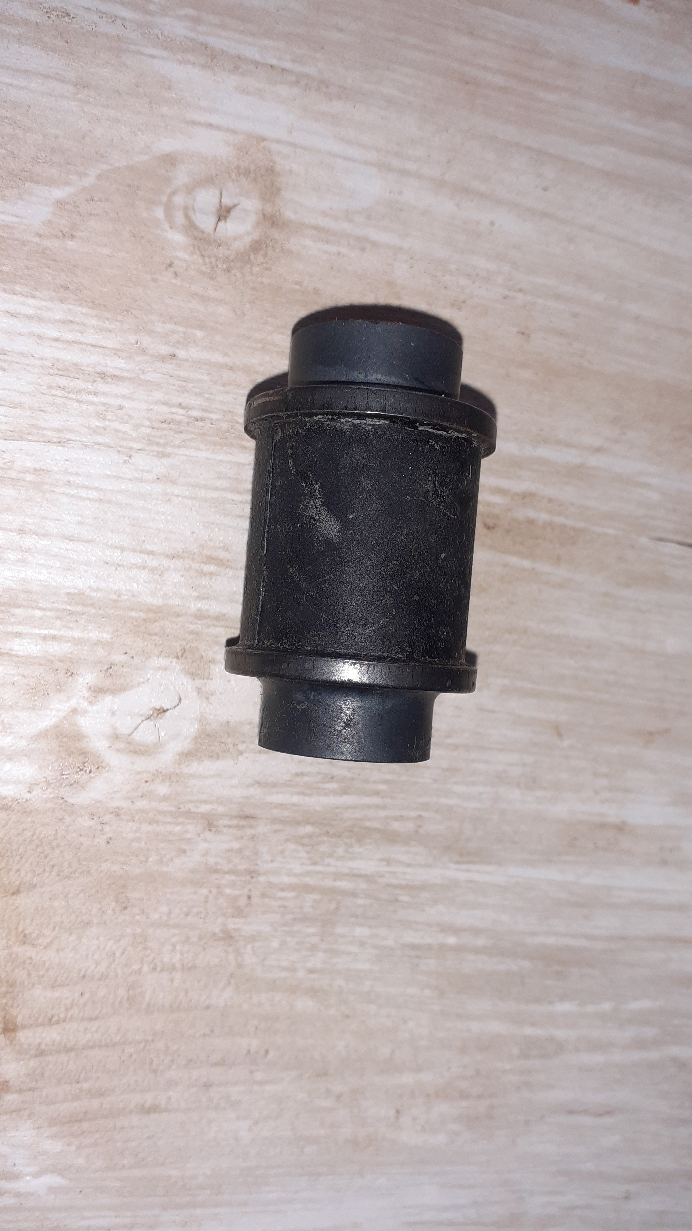

Take the cover off and identify on the rack exactly where the noise is coming from. There is a connecting piece between EPS motor and the rack. When I had problems with the EPS I found that part had grease inside, it comes over those little shafts. I didn't understand then why is there grease, as that part stays locked on the shafts and revolves with them, but because that is how I found it, I put it back the same, with plenty of grease. Never had noisy problems but I did heard of it and it was identified as coming from there. So take a look. Here are pictures with that
Thank you. Your power steering pictures looks like one in Punto, 500L have different kind. Do you think it is safe to open it? It would really be a disaster if some springs etc. jump out when opening and there is no way to know how to assembly it again.
There are no springs to jump, nor something else. It's easy to put it back, all you need is proper tools to unscrew the screws considering the spaces are tight there. Yes, my pictures are from Punto. But I think although it looks different, technically it's the same thing cause it does the same thing. So between the electrical motor's shaft and column's shaft is a piece that connects them, the one I've mentioned. I think the 500L has it too, but you can check videos about it to make sure. Anyway, before taking it down locate the source of the noice. If it's coming fron there, you take it down and fix it.
