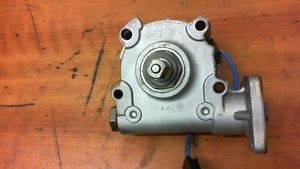

the only thing I think can be faulty is this (see the photo).
May be on the photo is not exactly Fiat Punto mk2 steering column, but you know what i mean.

I find the noise: this is the bearing of the column, connecting the electrical engine. I replace by an used one, and no more noise!
i replace this box
the noise was very loud when driving after disconnecting electrical engine, and disappeared when holding the bearing with hand.
hi
this is in the housing. But this is not torque sensor. The noise disappears when holding the shaft connected to the elec motor. et very loud when driving without elec motor.
