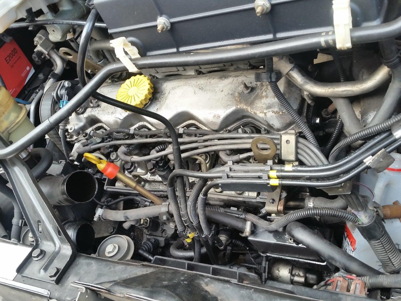

I was prepared to send a pdf line drawing of the EGR system, but if it cannot be opened, not much help. I will attach a photo of non EGR engine instead. Please compare the rear (manifold) side of the engine with yours. An EGR fitted engine will have a circular EGR valve sticking up at the vehicle RH side, and a cooler running across the engine, over the manifolds.
On second thoughts, perhaps follow this link and scroll down to the EGR circuit. The diagram shows the rear side of the engone with EGR fitted.
