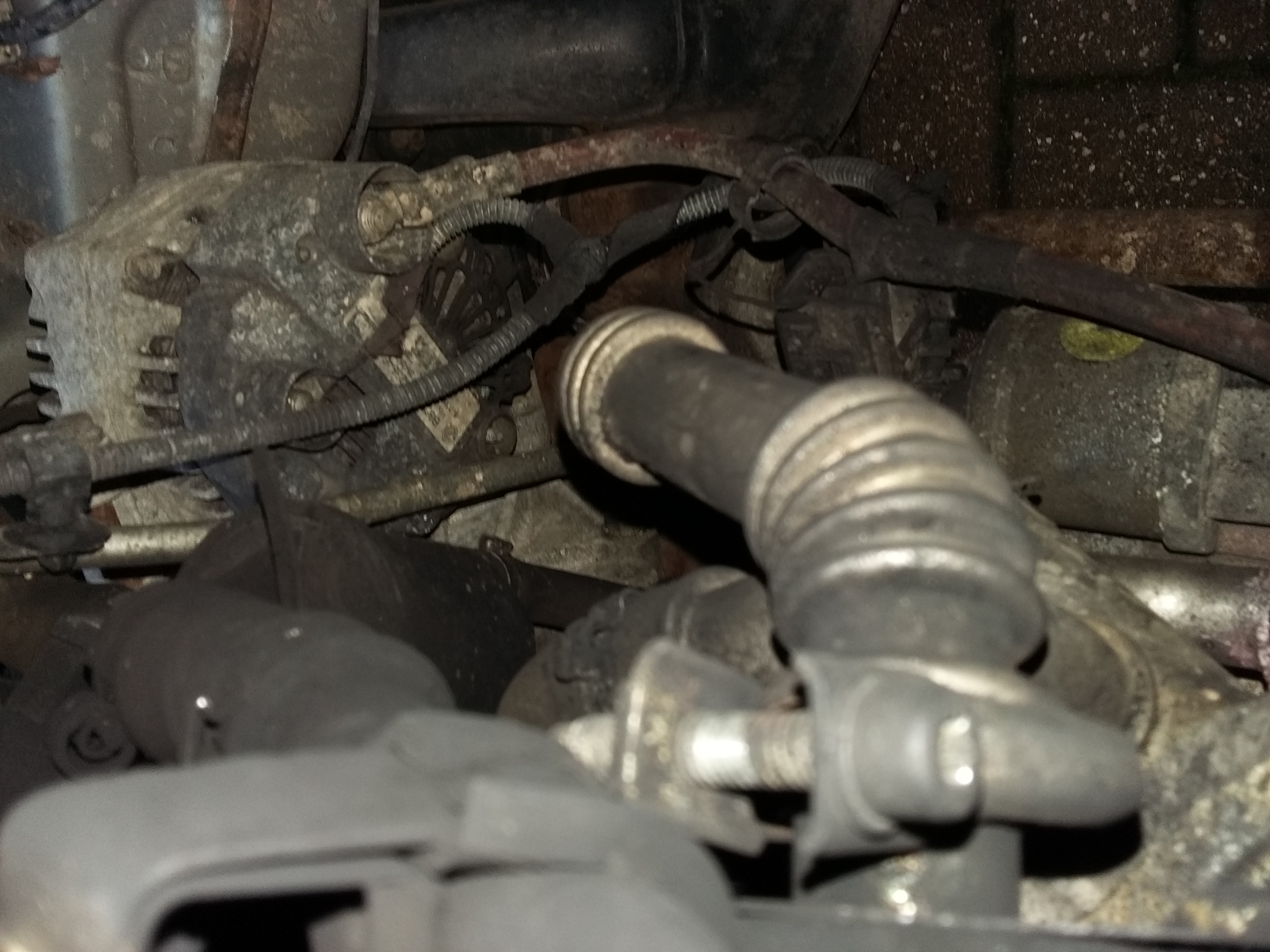

Stock photo..
But silver tube is EGR.. top rear
Looking down..to rear is
Alternator on top
Starter at bottom
Access with drivers front wheel removed may be fair
Charlie

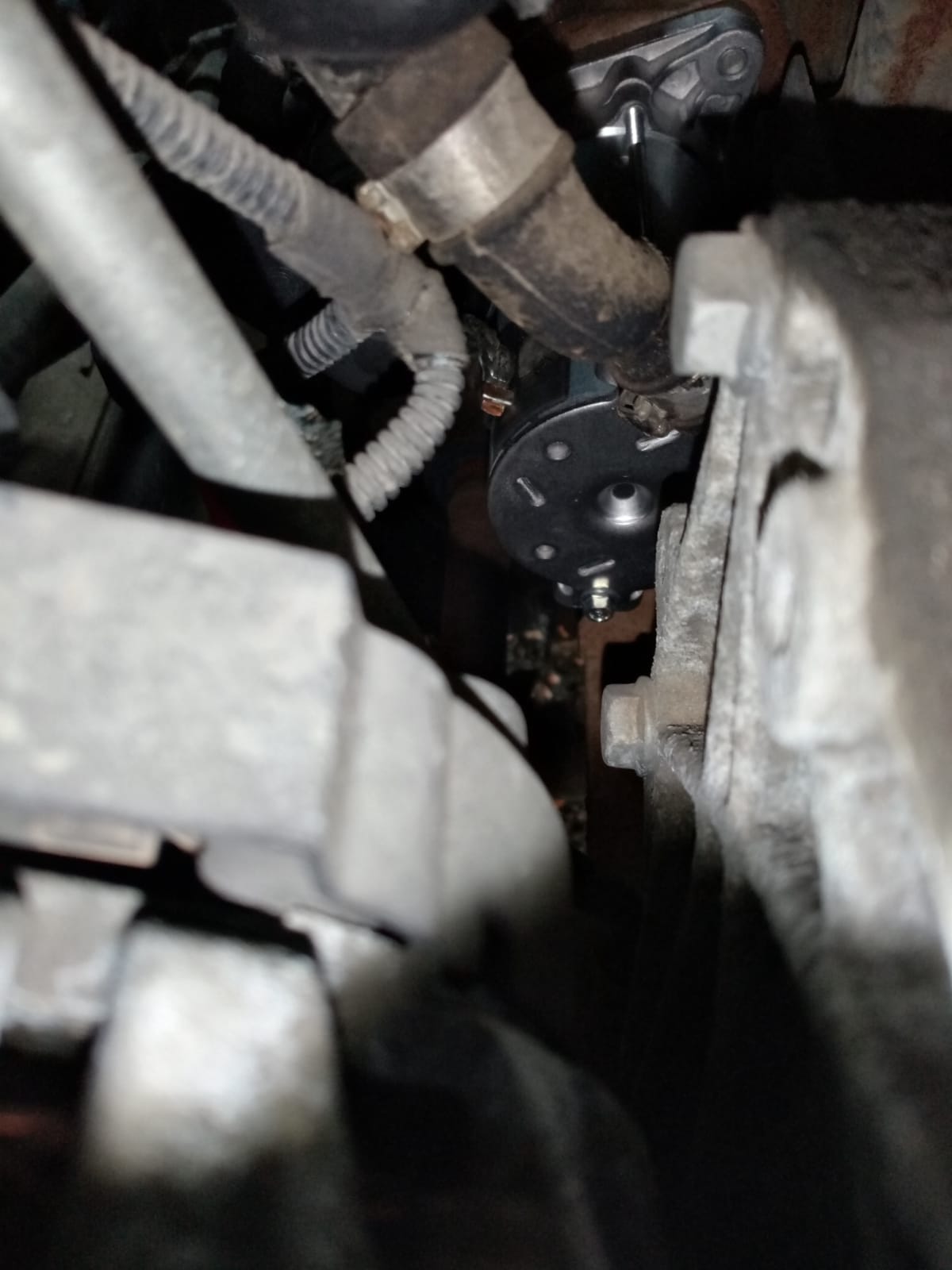

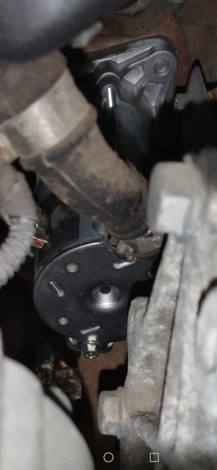

So I have had the starter motor changed for a new one and the engine turns over beautifully, from looking at the original that was removed it appears the primary issue was the connection to the solenoid, also a large amount of clutch friction material dust over the pinion making it stick a bit.
The garage charged me £60 (incl VAT) to remove and replace.
Attached are the images of the old motor (the rusty connection) and an image of the new one fitted in the engine bay, it is located under the alternator on the drivers side(MK2b 1.3).
