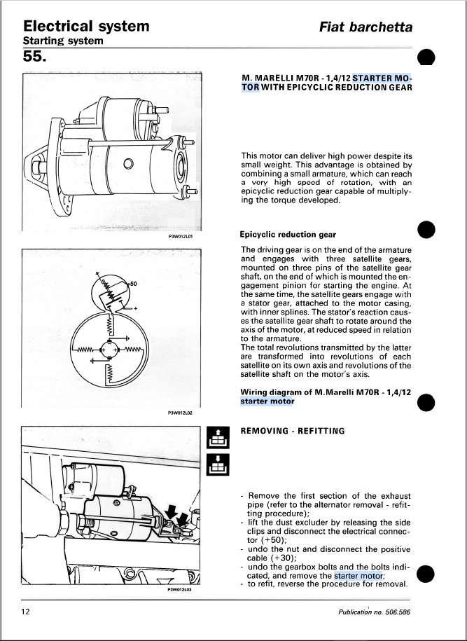

Had a look in the manual downloaded from the forum for instructions on removing the starter motor but can't find anything.
Am I missing some pages or is it just not there?
Also, is this the definitive manual or are the ones on eBay any better? Has anyone tried them?

Sorry I'm a plonker! For some reason I read/translated Starter to Alternator.
My apologies. :bang:
Very easily done, after all they both end with an "r". (y)
Well yes but my original thoughts were that I knew the alternator was a sod to get out and assumed that was the reason for the "how to" / manual info request. Least we now have both Starter Motor and Alternator now covered.(y)
