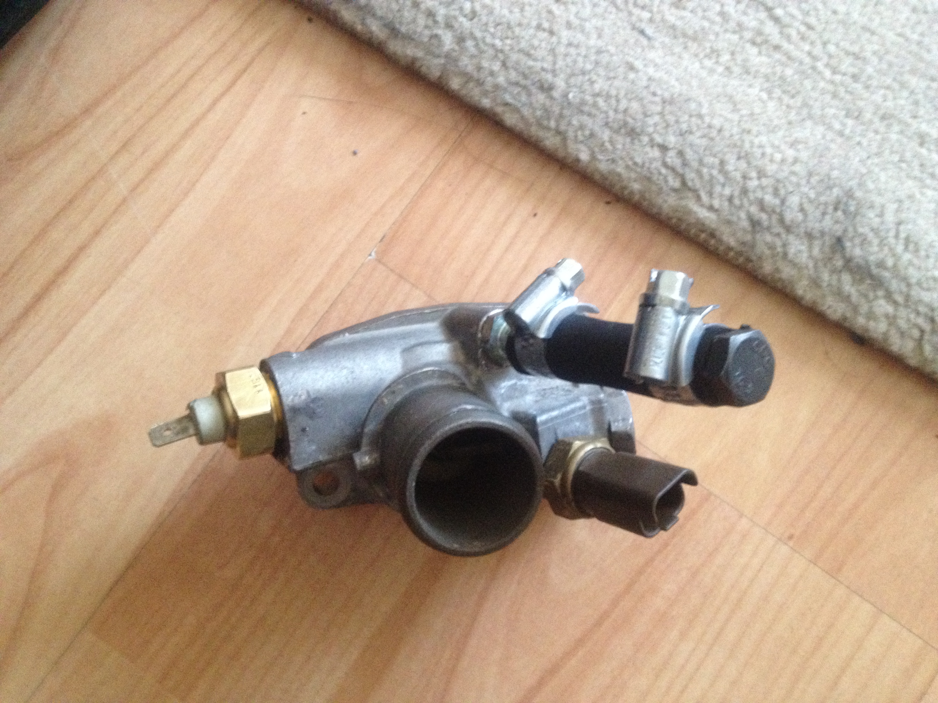

Time to go and have a play with the new thermostat that will hopefully work on the cinq and will then take a temp reading from the block side of things rather than just from the top rad hose.(y)
had to find some bits to use to block off the unused channels but only time will tell if all will be good;)

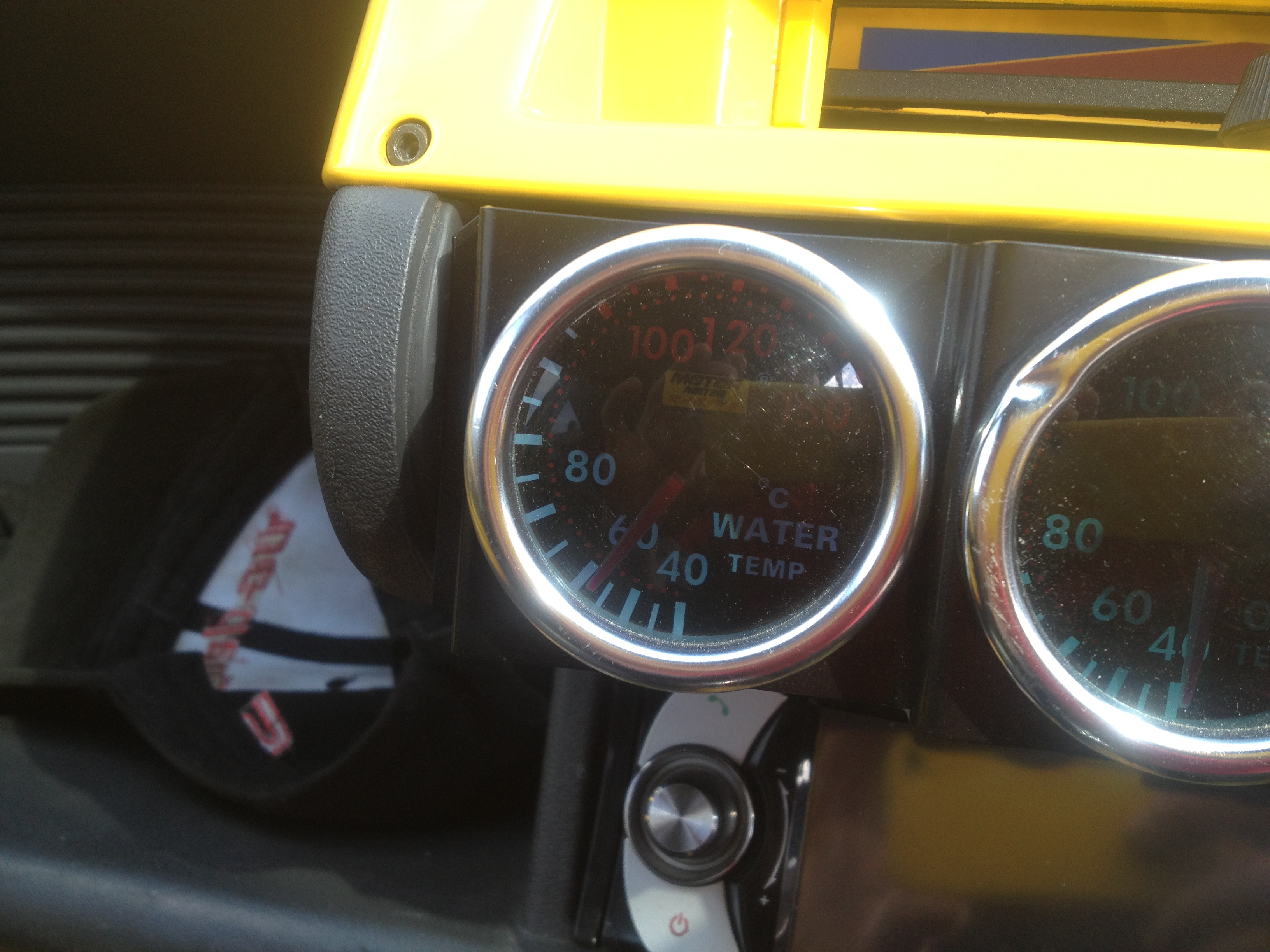

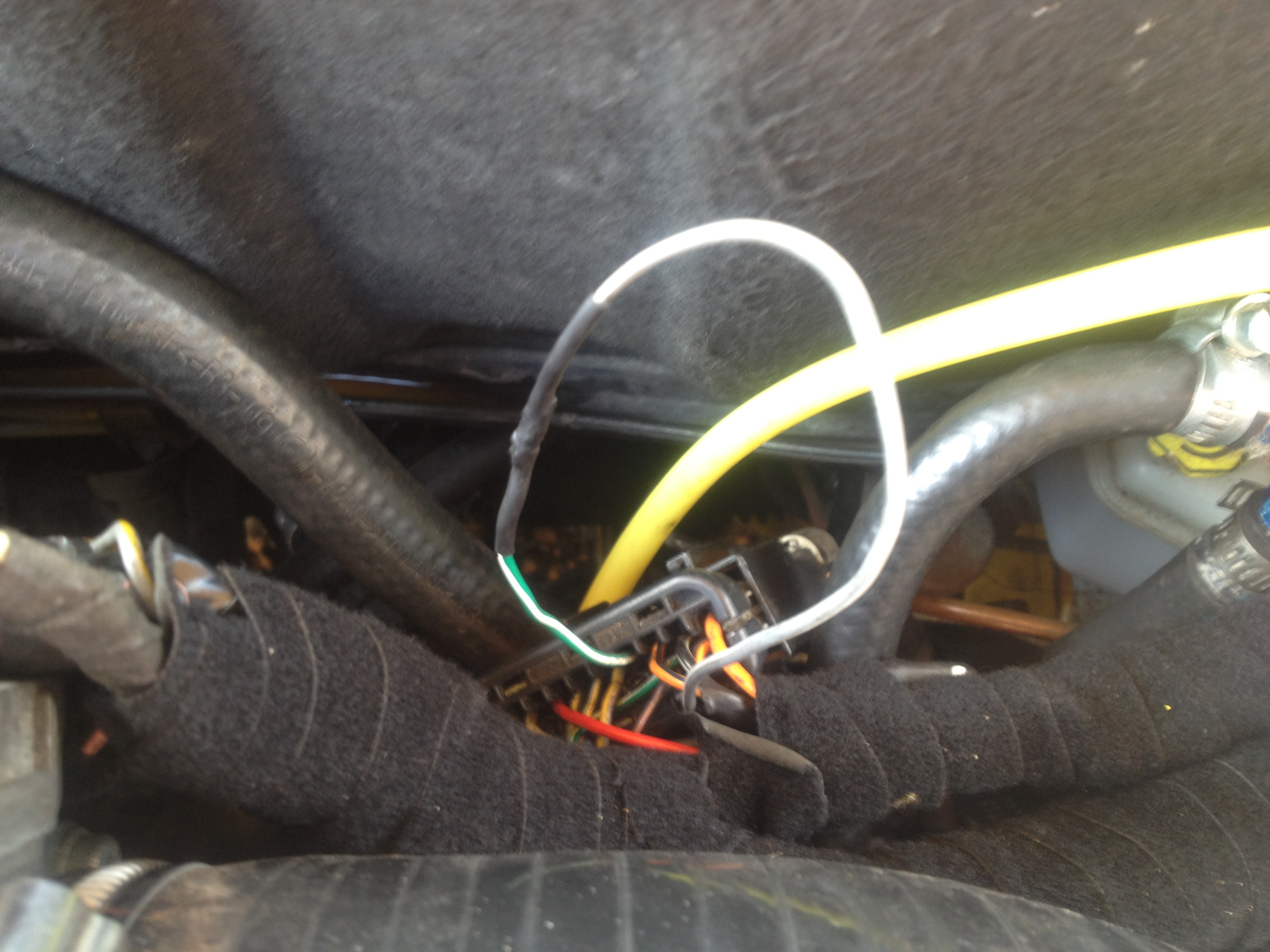

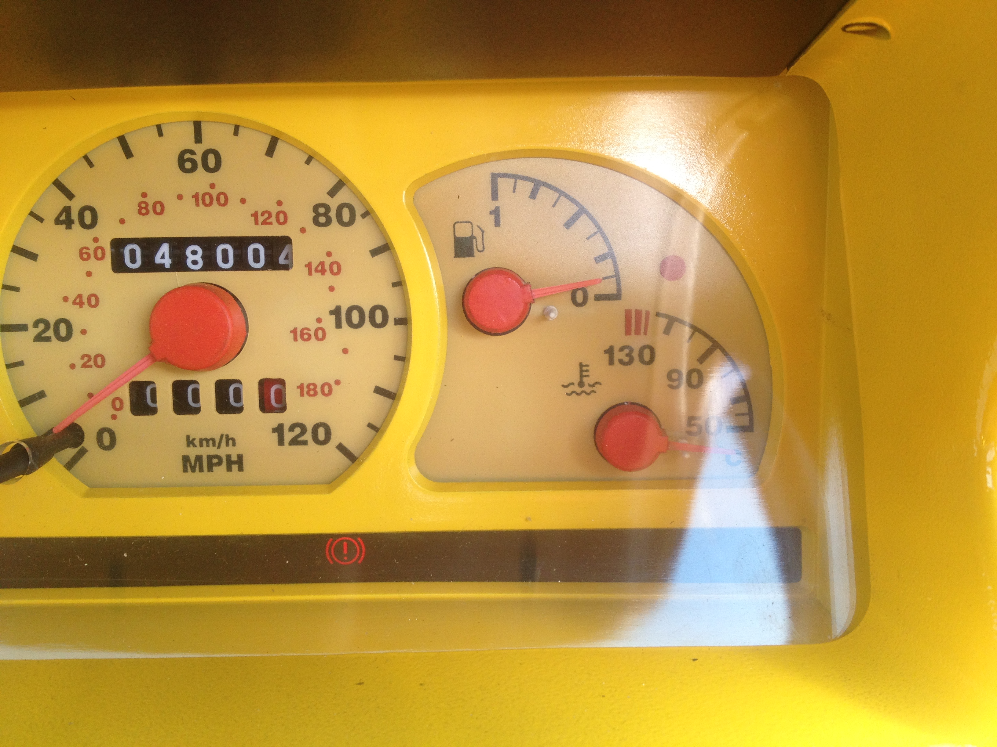

Ok the thermostat is on the cinq and system all bled up again and no leaks anywhere from any of the blocked of channels :D but the dash gauge still doesnt work:confused: i have the grey/white off the punto loom connected to the green/white on the cinq d4 which i believe is correct so does anyone have any other suggestions??? it has a brand new sensor in there but i have a feeling it is the wrong one even though it was ordered by registration number:bang:
This clearly shows the dash gauge is not working compared to the other gauge and the wire i have connected to the d4:confused:

What happens when you ground the wire that's meant to go on the sender? The gauge should hit the roof. This should help in tracing the fault.
I have just been out and earthed the wire and dash gauge does go thru the roof(y)so im thinking even more they have given me the wrong sender.IIRC you can take the spi temp sender out the head using a deep 13mm socket whereas this is a 22mm to get it out and im sure the thread wasnt as coarse nor as bigger diameter:confused:

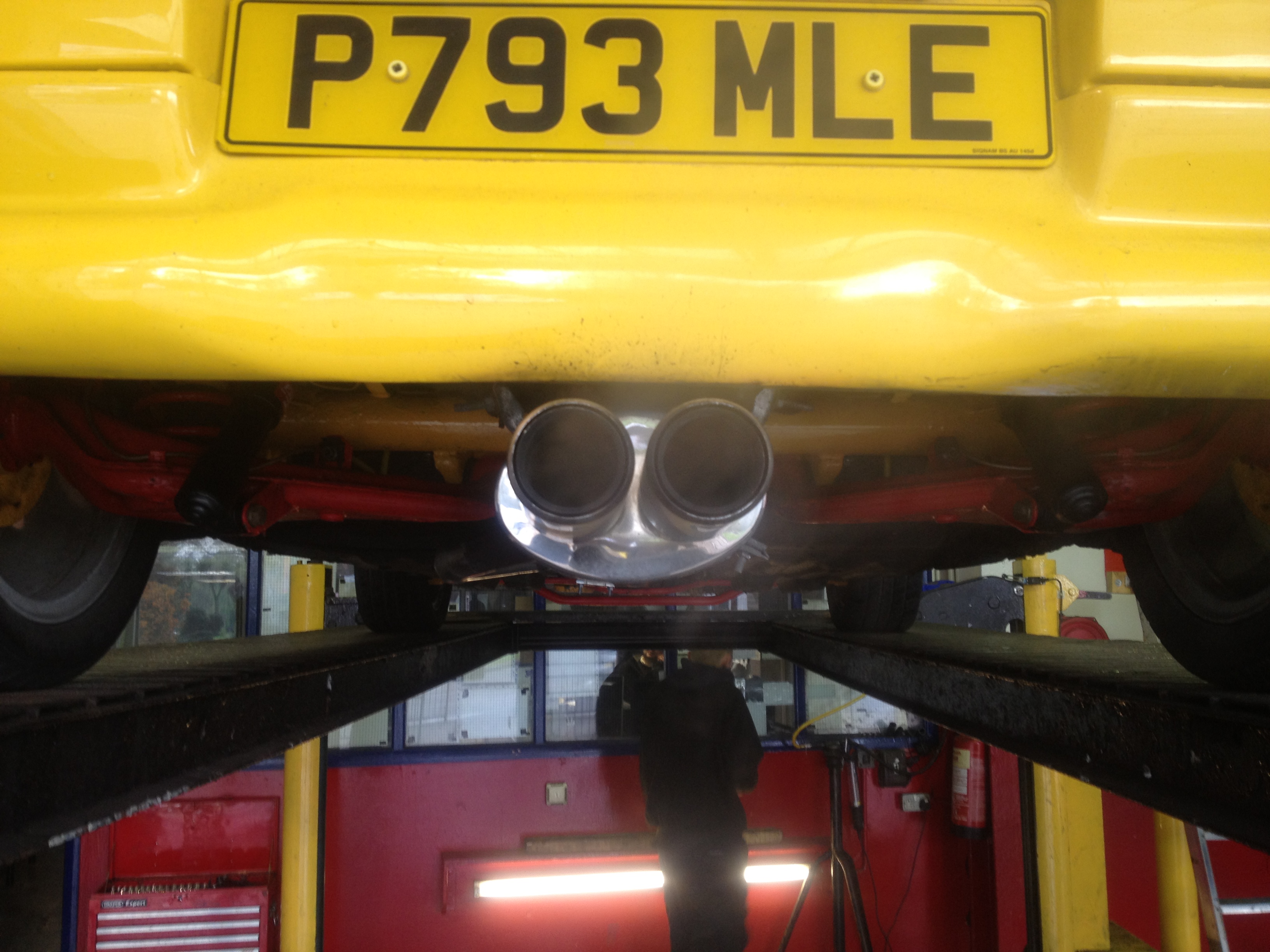

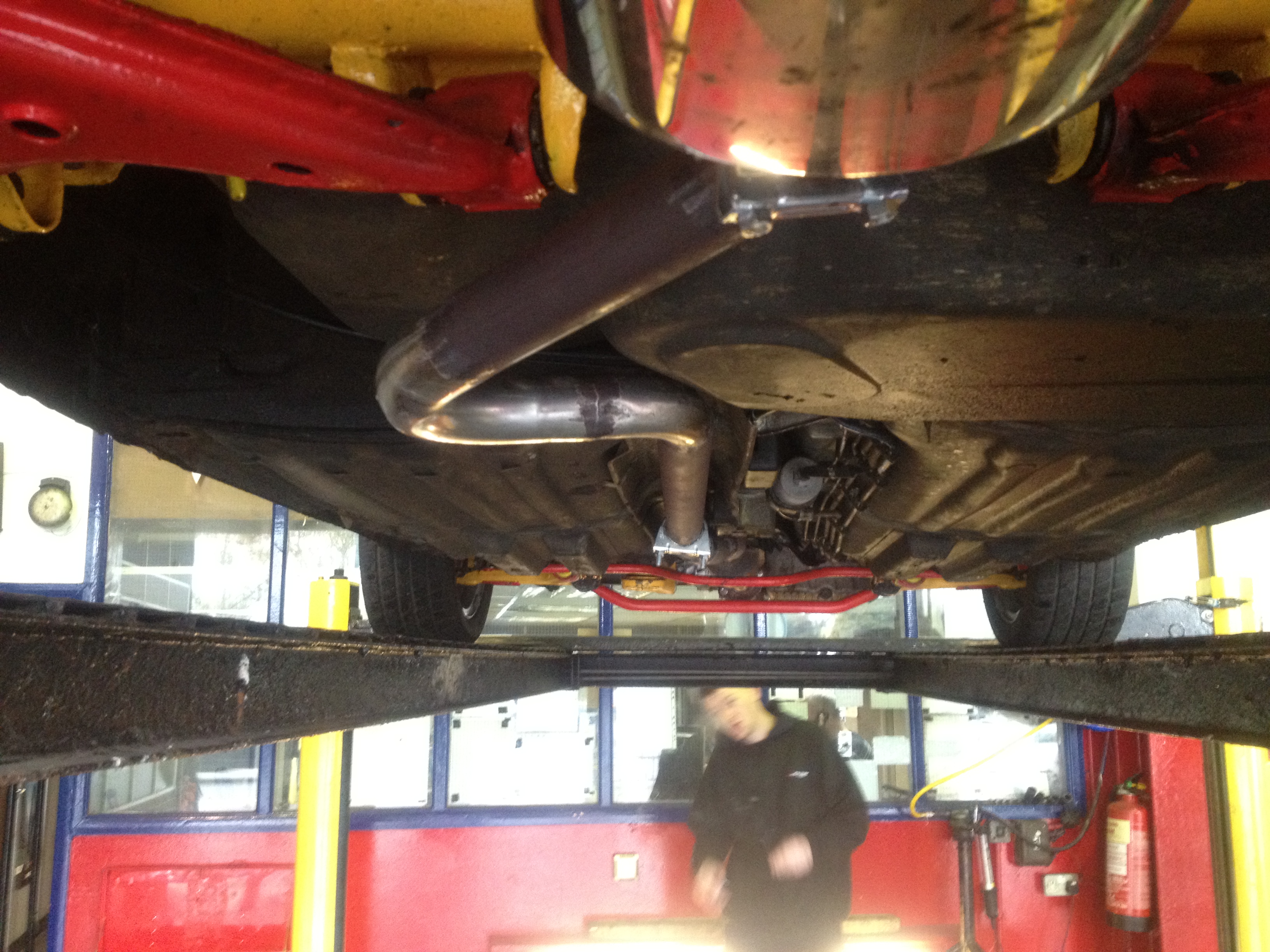

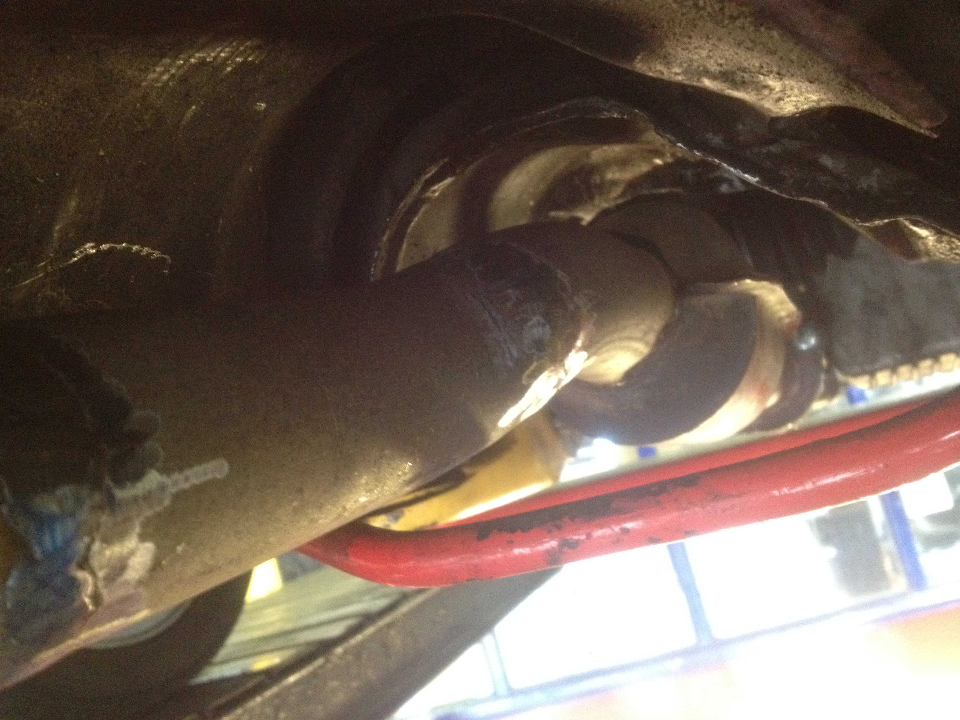

Over the last few days ive been remaking my front section of exhaust going from the supersprint manifold over the arb as i only had about 4 maybe 5mm clearance and was getting the odd knock from it :bang: but i was still using a bit of pipe from the old 8v engine but now i have an exhaust of correct diameter and the correct angles:D:D did it on the cheap as cash a bit short since finishing the conversion;) so into work came an old volvo 760 tub and the angles on the pipes were perfect and all that was wrong with it was the boxes had rotted out but pipework was good (y)(y) so 2 hours later mine is on the ramp and being played with....the result well im very happy now with the clearance as per the pics.:D:D

Finally i found a centre silencer at work that was a perfect fit and it has had the required effect of getting rid of some of the noise from inside the car as i wasnt going to pay £45 for a cherry bomb and i have used a renault clio mid section which has the same size box as the bomb i would of bought,now im just ashamed of using a renault part on my cinq:cry::cry: but if it does the job who cares:rolleyes:
