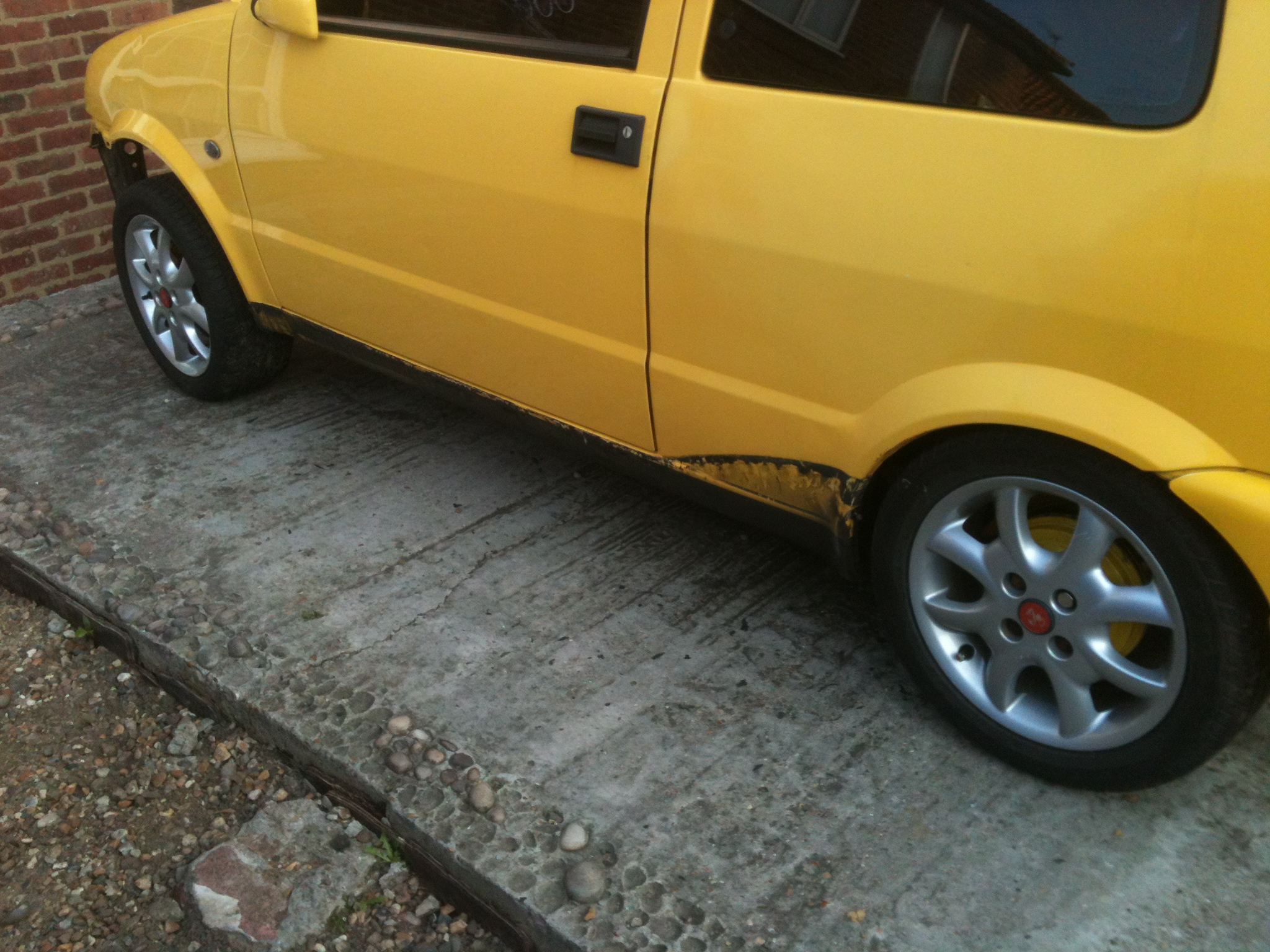

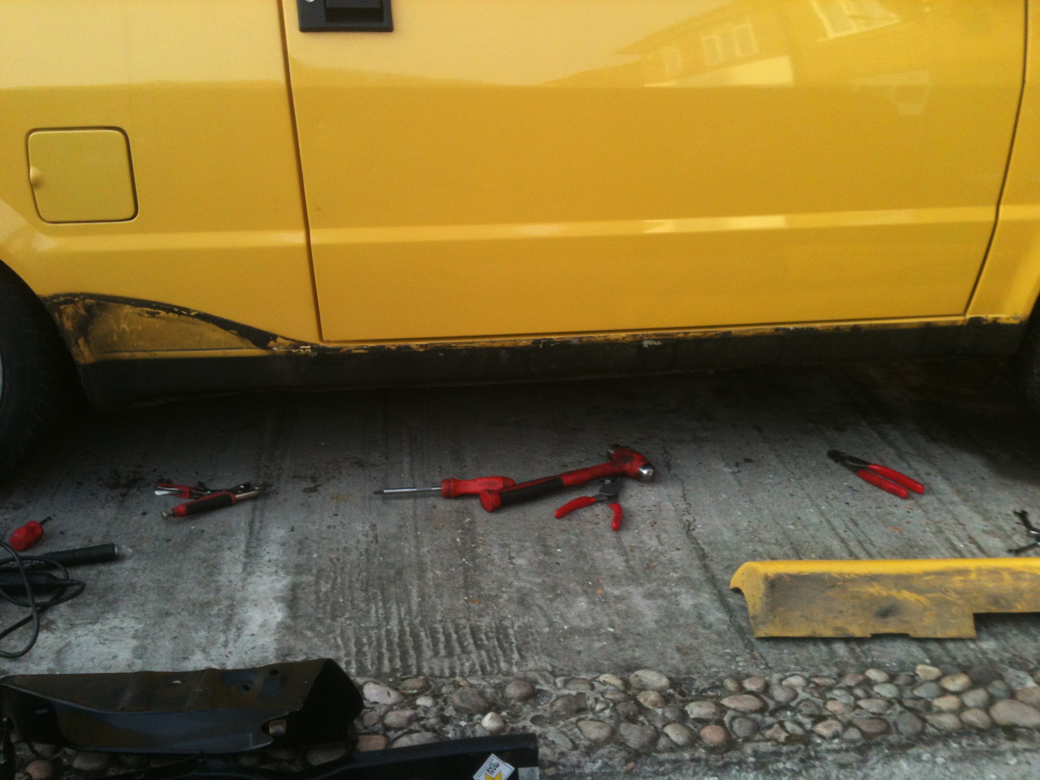

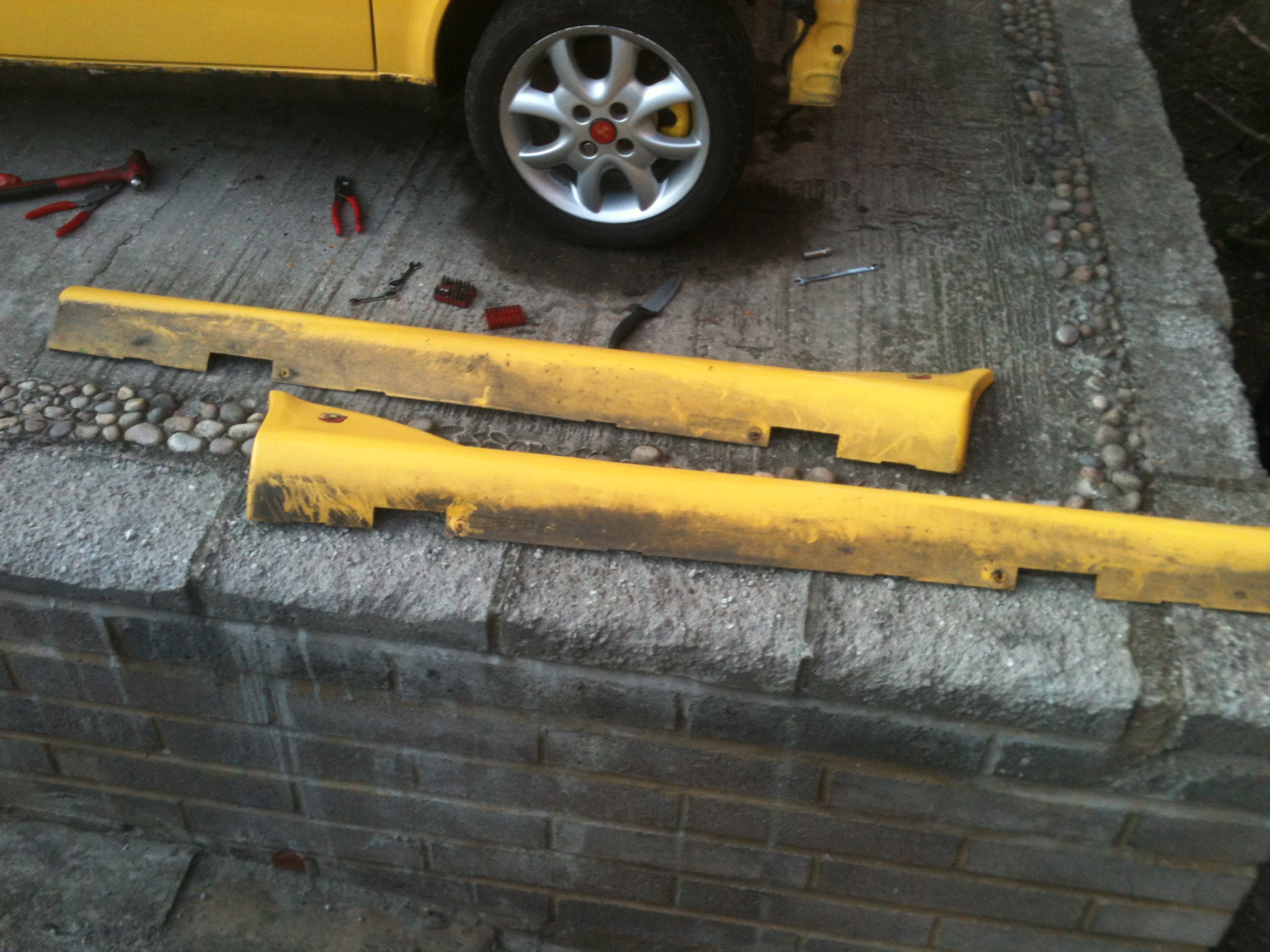

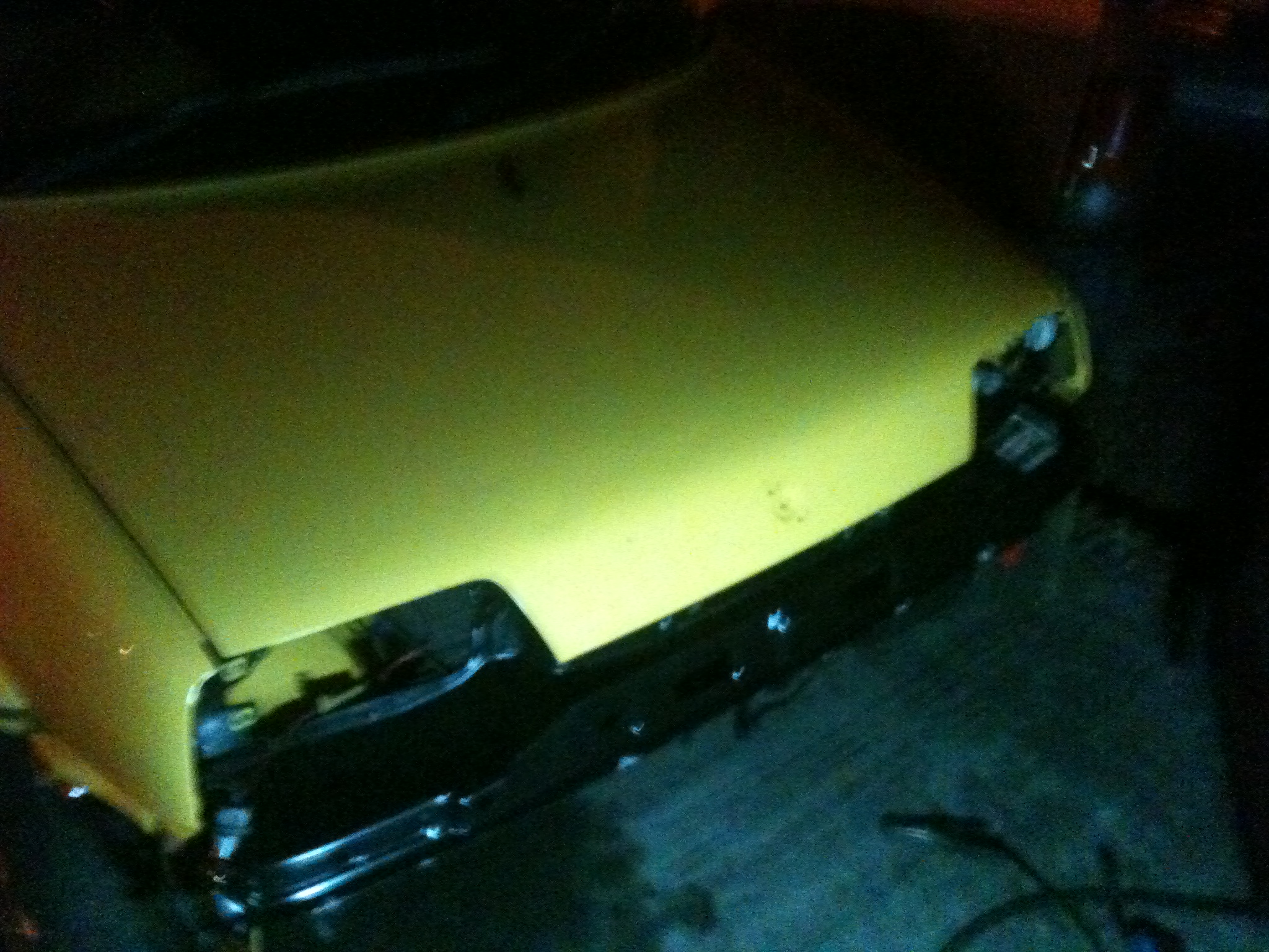

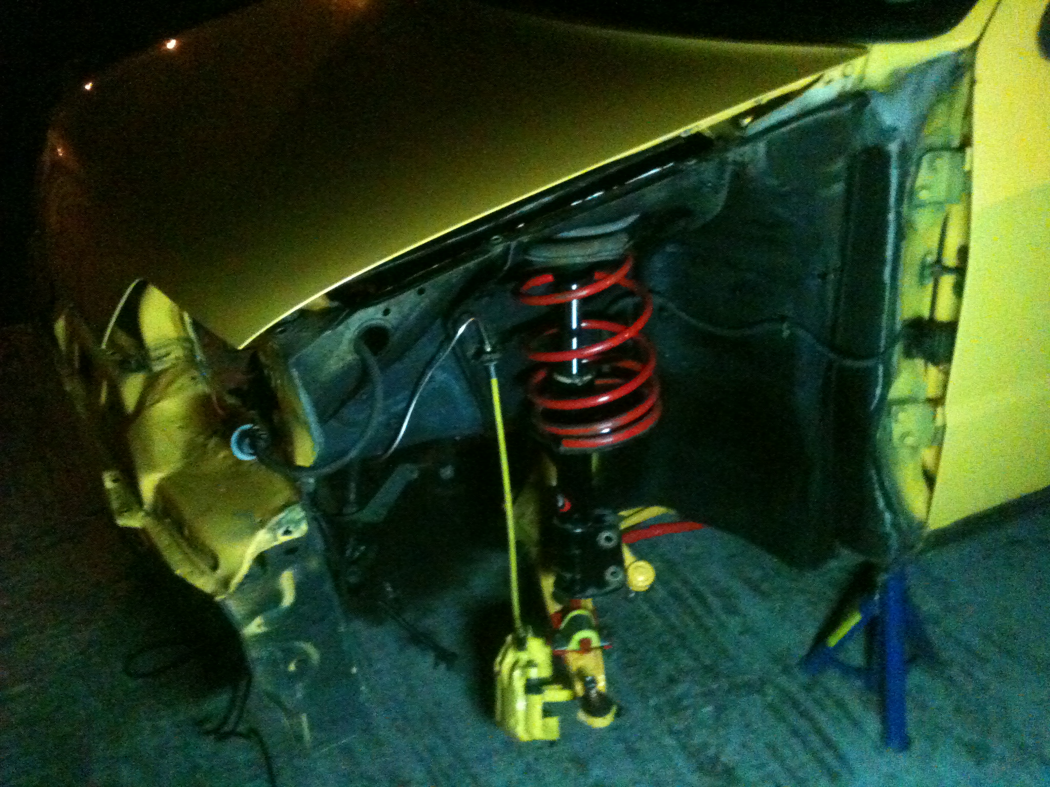

well over the last couple of days i have had a couple of cold evenings work.not alot has been done thats visible but i now have a set of fully working brakes and all the handbrake adjusted up,that was last night and tonight i ended up taking the side skirts off and both wings and bonnet so i can get started on cutting the front panel off on wednesday.:D:D:D
i have also taken both front hubs off ready to take into work tomorrow and press the new bearings in,only the n/s is dead but if one goes the other probably isnt far behind so may as well just do both now save ripping one side down at a later date(y)
the hubs will be going back on tomorrow evening after i get out of work:slayer:

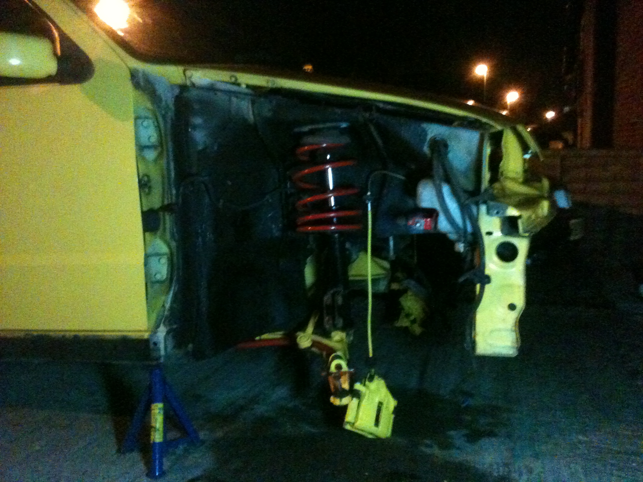

Finally the front suspension etc is all done and finished and no more messing about with that till full geometry set up(y)

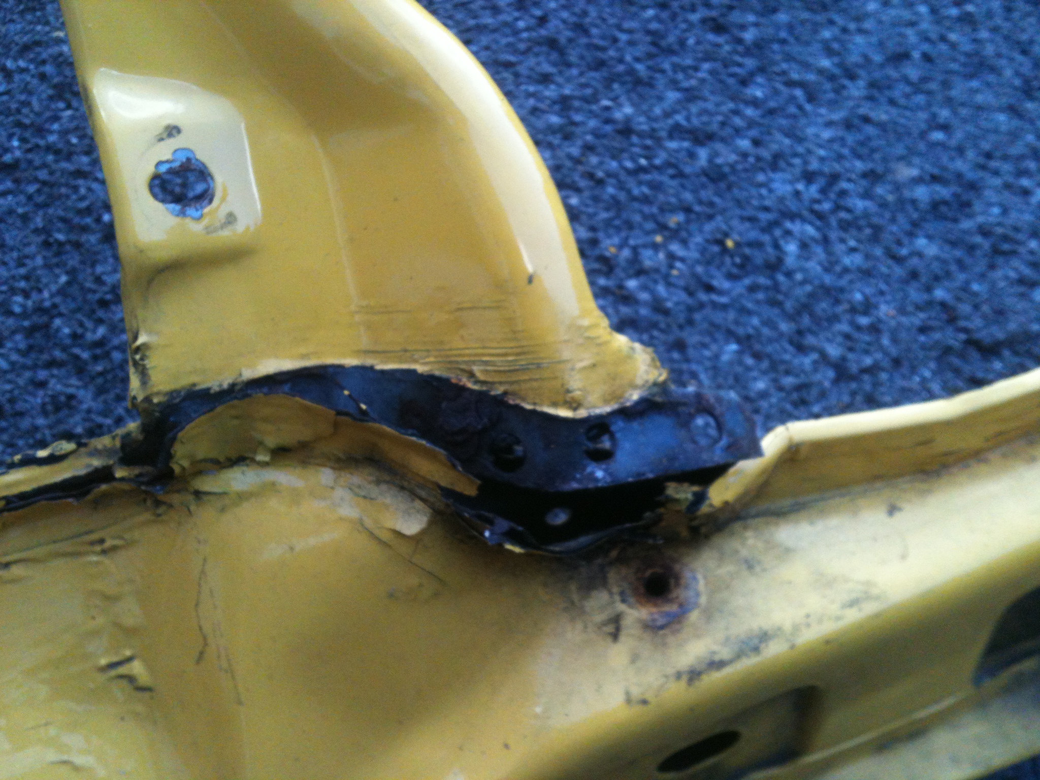

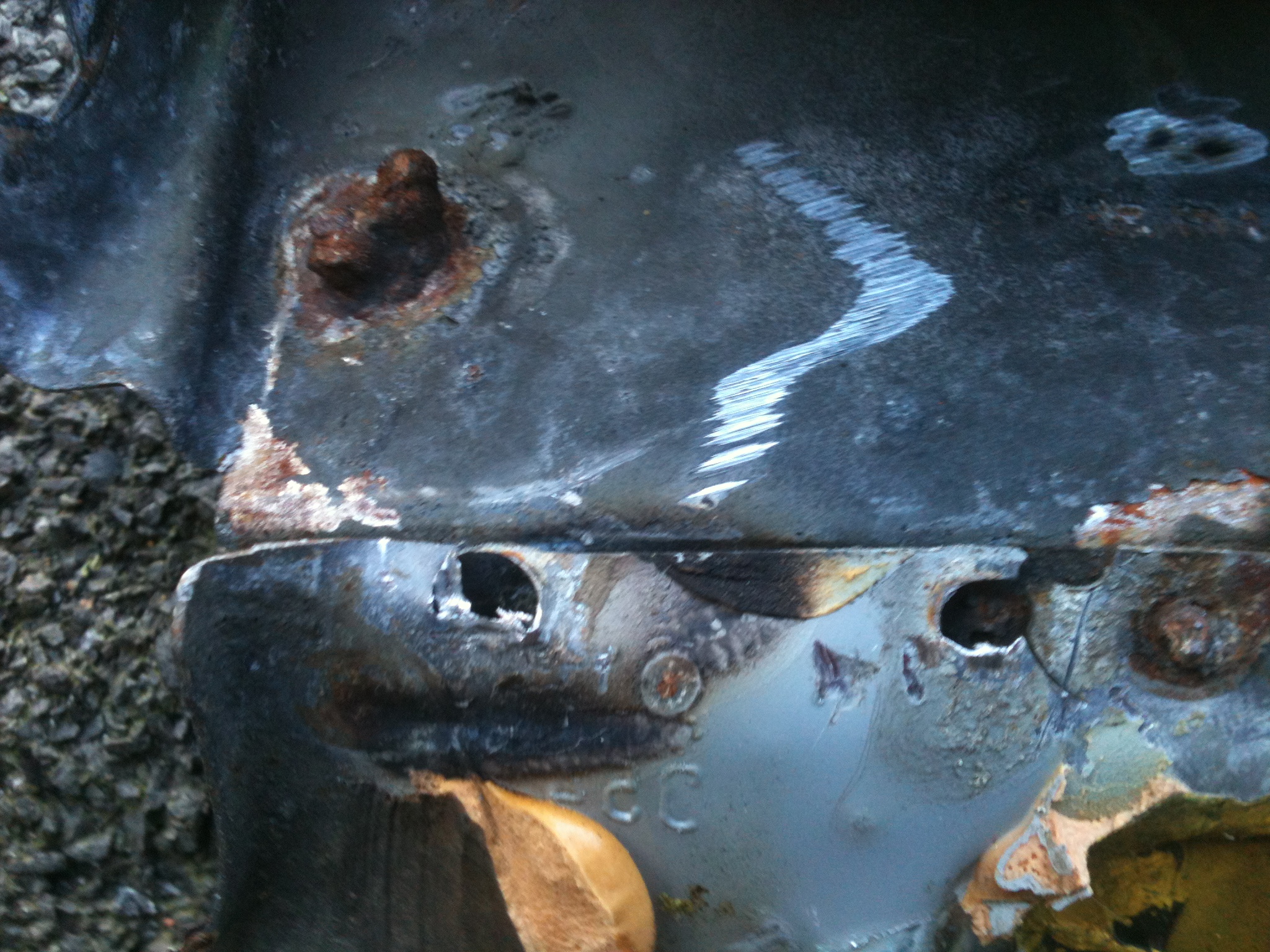

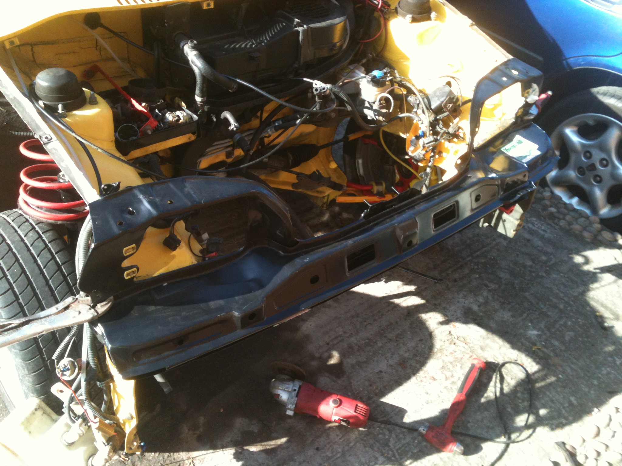

couldnt resist starting to seperate the front panels so i cleaned all the silicone and seam sealer off and all the drivers corner is held together with was 4 bird **** spot welds that i broke away with a pry bar not a big one only an 8" bar and now the whole corner flopped away from the rest of the car:mad:(n):cry:
never have i seen such a cowboy repair:eek::eek::eek: pics will follow tomorrow when i have some daylight and i hope the weather forecast is wrong:worship:

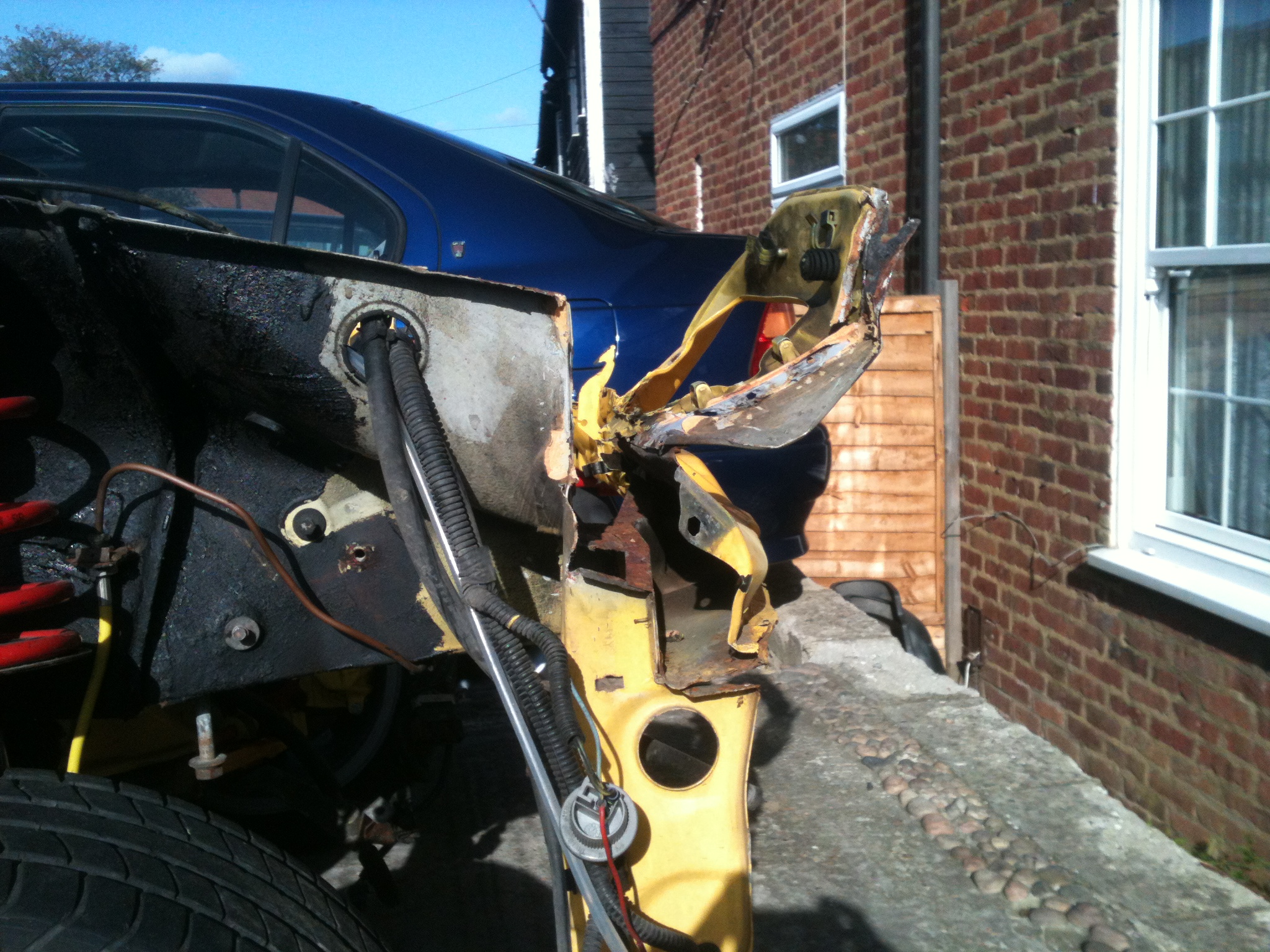

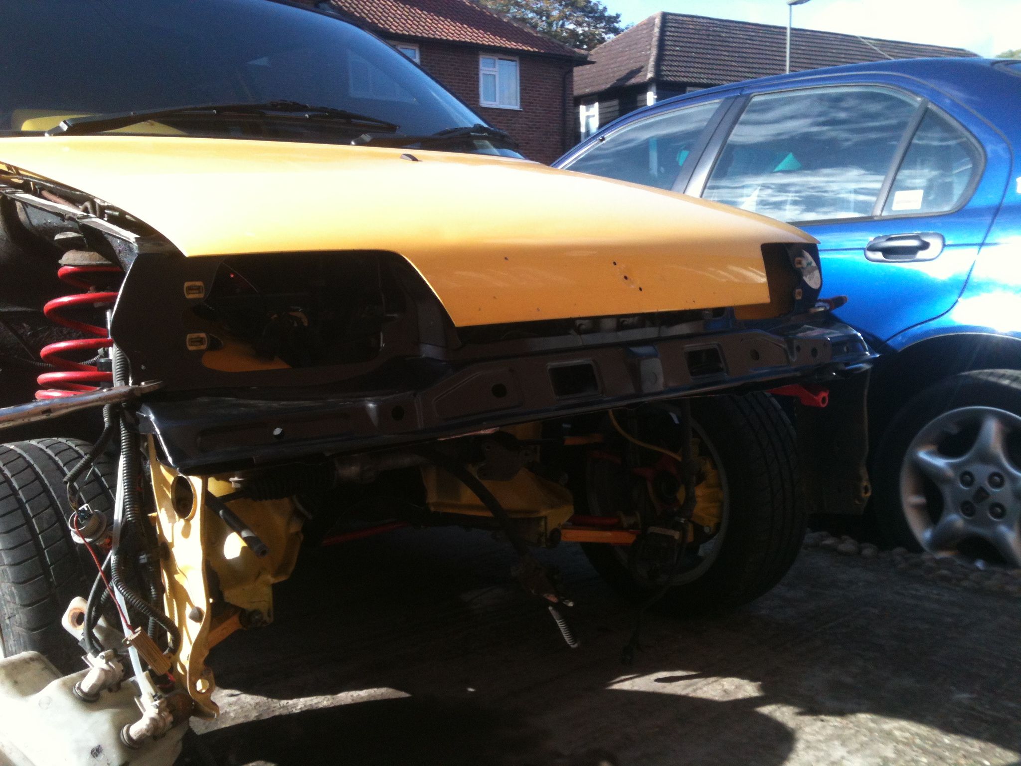

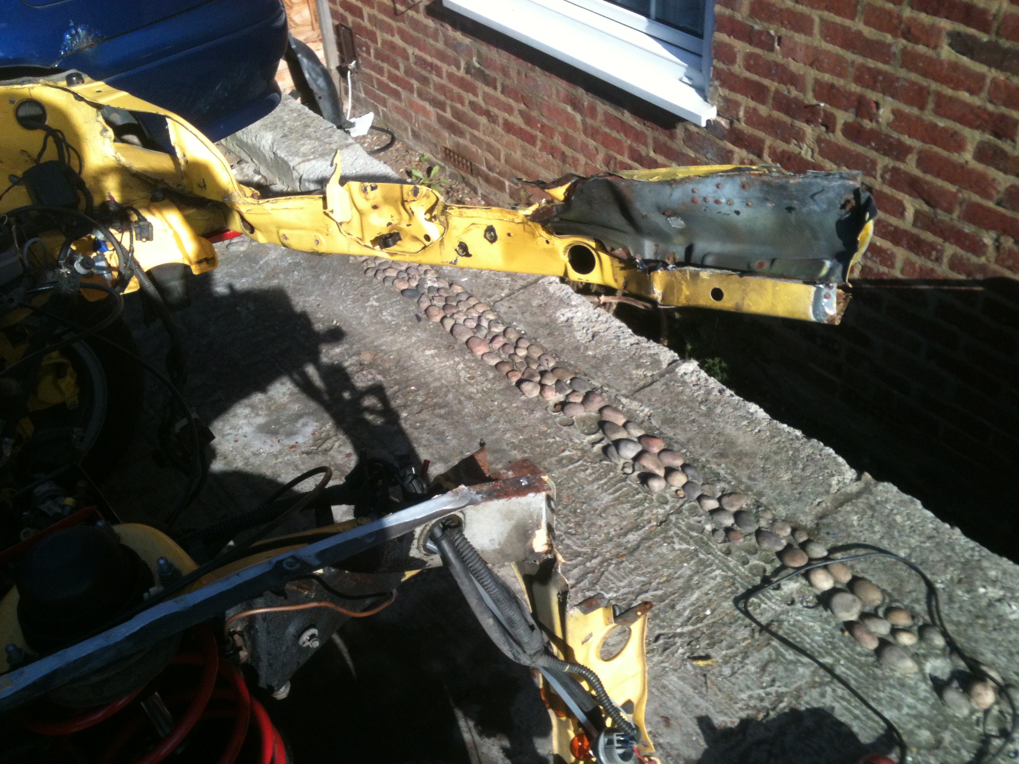

Well the forecast was wrong and i have sunshine not rain:D been out this morning and the front panels came off in 30 mins and the drivers side has defo been in an accident before and had a total cowboy repair job done:mad::mad:
im now glad i had my doubts about the front and replacing it as its defo a good idea as to me it was not safe:cry:
the first picture is how i got the front panel to last night just using a small pry bar and my bare hands.:D
anyway tomorrow evening im going to bring the works welder home in the van and get it all stitched into place as i havent got my own mig wire and gas bottle yet and its cheaper to use the works one:D:D

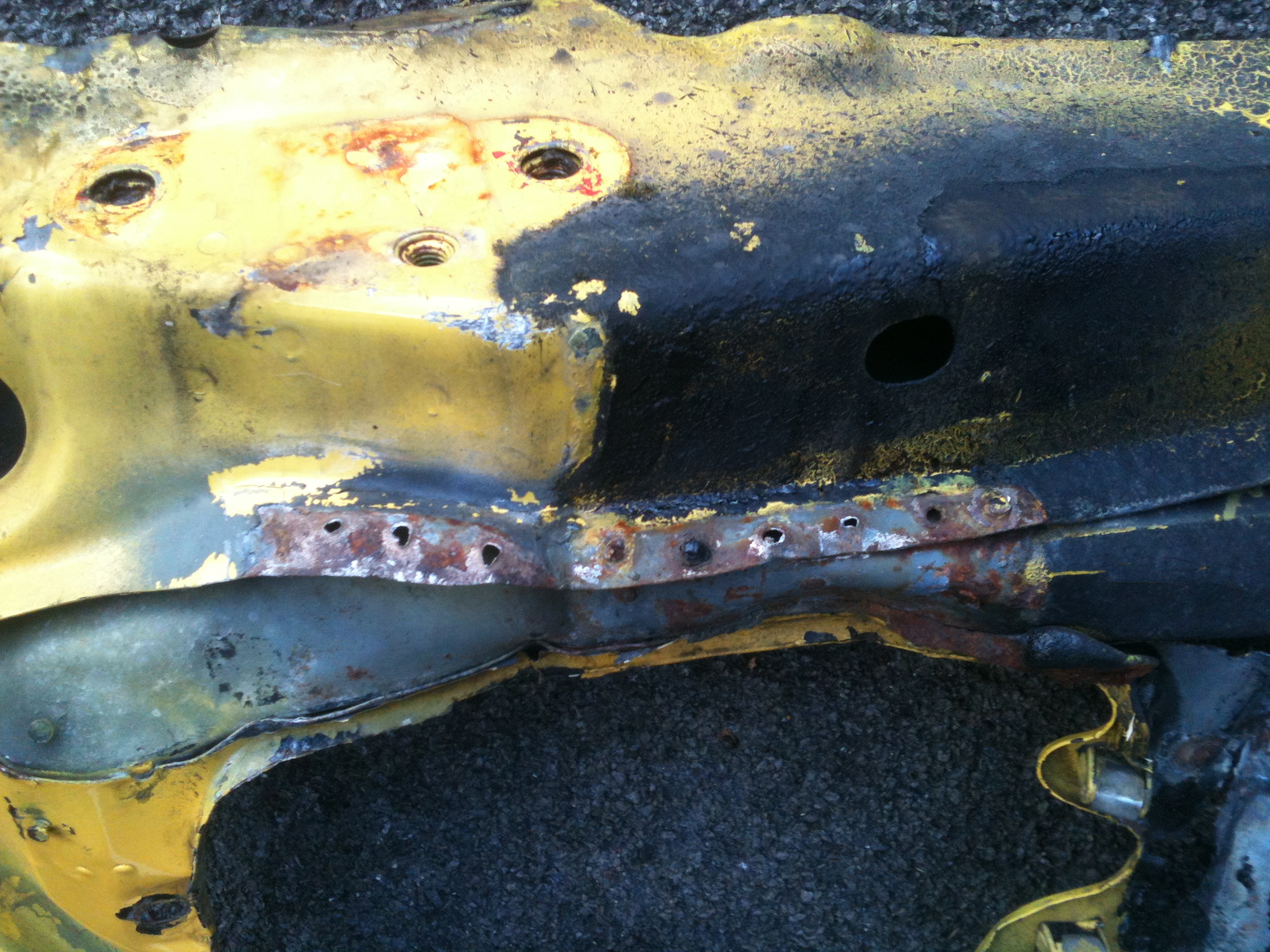

Whitz if u had seen this smart car after the crash and the driver had to be air lifted i think u would change ur mind!!!! and i totally agree u could rip it off with alot of force but this didnt take much force.here are some pics of the state of the old panels,u can clearly see where holes have been drilled but not welded up and also the state of the welding(one of the pics has lots of spot welds but they had no penetration to the panel underneath) cant be fiats doing surely same goes for the seam sealer that cant be original!!!! TBH u had to be here to see how easy it was to pull off and how bad it really was.
i have bought some rotten cars to break up but ive never had one this easy to remove any panels from....makes u wonder about the state of some cars on the road:eek:

All safety stuff aside, that one has been very badly repaired. The one I scrapped to get the panels off for Blue 2 was original and had 60+ very good spot welds holding the slam panels together and to the rest of the chassis. Now, they'd not do alot in a frontal impact (the impact is supposed to be absorbed by the rails up to the point that the block and gearbox are contacted), but enough to transfer some of the impact from one side to the other and assist the crumple.
forgot to put that neither chassis rail was attached in any way shape or form to the front panel.....not being attached is also going to affect the rigidity of the front chassis rails keeping everything in line when stuffing it thru corners... and thats the same with any structural weakness on any car,they are to be welded for a reason(y)

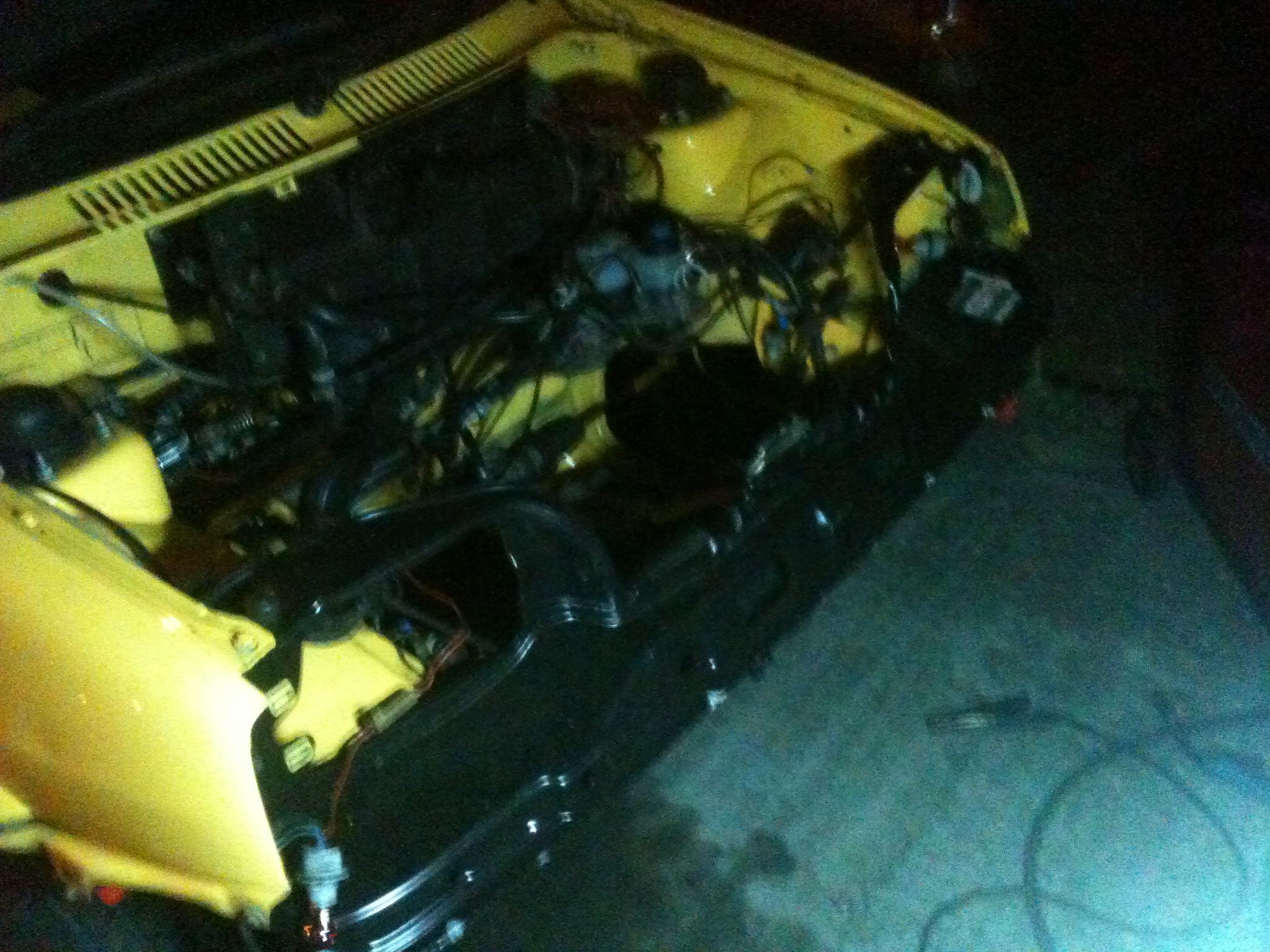

The front panels are now welded on and 10 times stronger than it was before and ive only used spot welds in the strategic places and there is no flex like there was before,even managed to get the wings and bonnet loosely bolted in place and everything lines up perfectly:D:D:D:D:D now just got to get a lick of paint on just to protect it till it has full respray:devil:
next job tomorrow evening is get all the front bolted back up properly and start getting other silly bits done out the way(y)
sorry pics aint that good but all i could get using a lead light lol....
