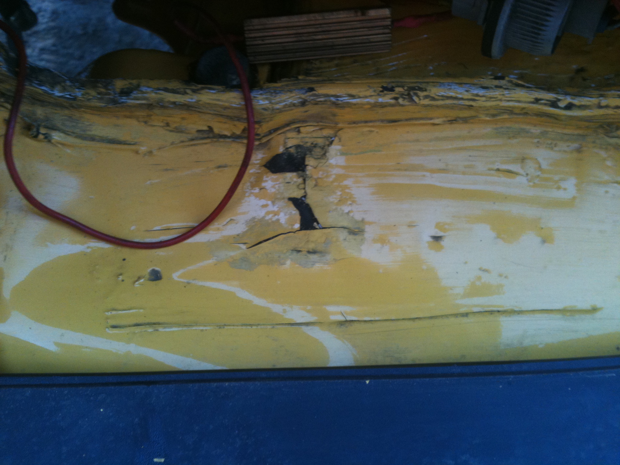

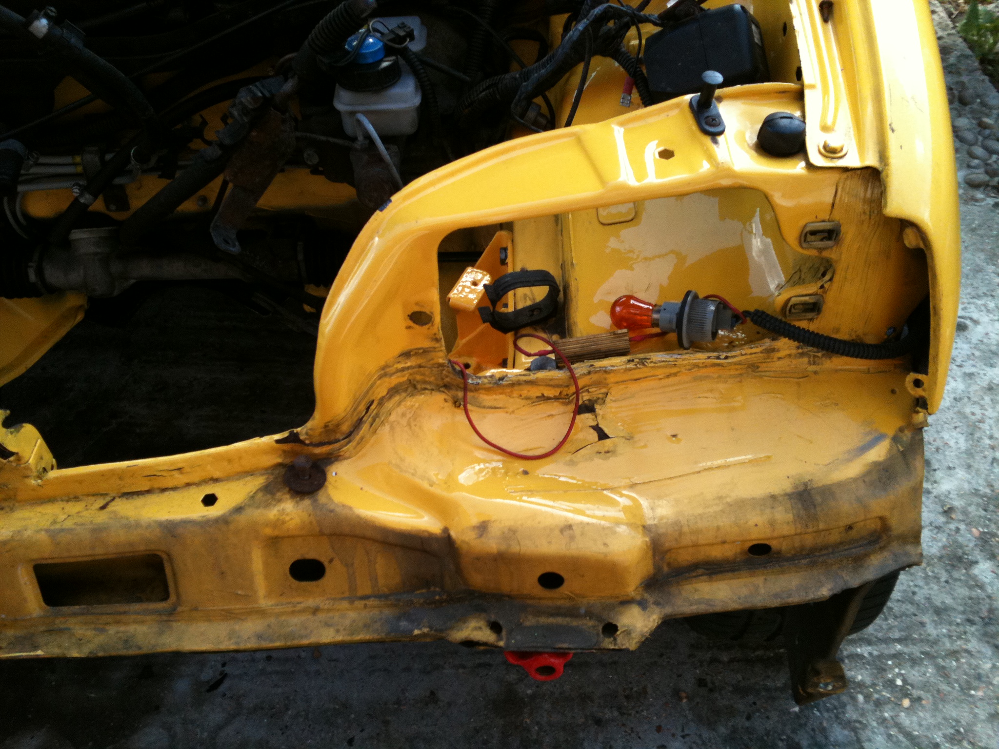

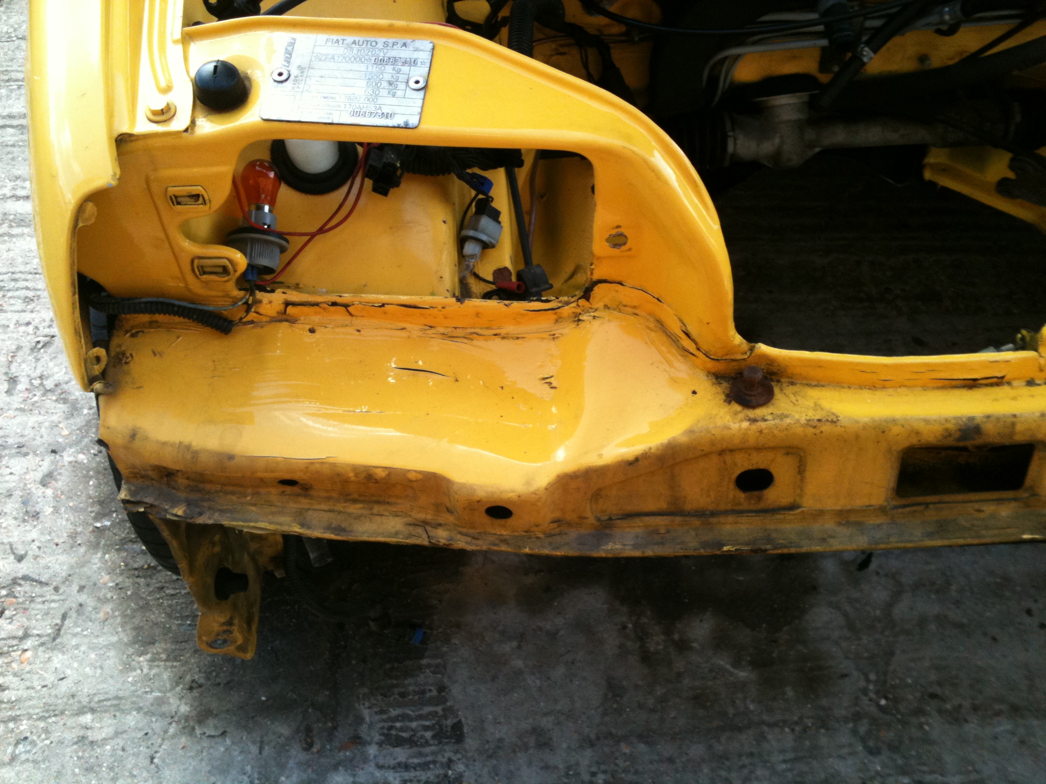

That cars had a second hand front end put on. Everything should be spot welded together. Not in this case because it's from lack of equipment/too rusty to do. I'm suprised all the panels line up with the gaps in the cross member to inner wing sections.
If you dont have a spot welder then drill some holes and fill with weld.
I just saw this. ;)
Yeah. I think the reason folk bodge them is that you have to split the slam and headlamp panels to do the job properly (the bottom slam panel welds to a bit which sticks out of the chassis "horns" as well as a couple of tabs on the sides. This involves either some deft work with Mr.Noisy and drilling out spot welds or -- if using s/h panels, drilling out about 80 spot welds.
It's actually detailed in the Cinq factory manual -- which I had in Italian until a Hard Drive bit the dust.
providing im not working on my day off(wednesday) i think its going to be get the grinder out and start cutting all the bad bits out.the pic below is under the passenger side headlight and the creases can clearly be seen.....defo had front end:(:(

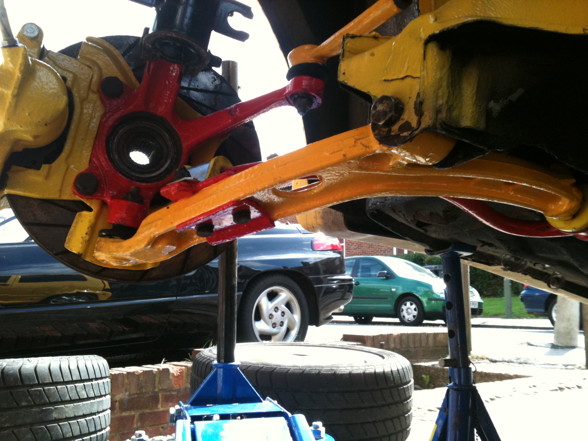

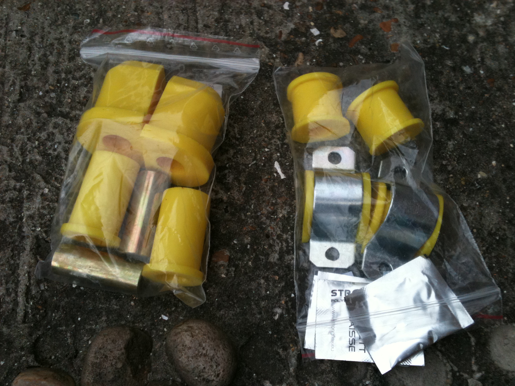

only a week after ordering the poly bushes they arrived just in time for my day off and the rain has held off so been outside getting all the front suspension put back together.
been looking at different rear shox and have chosen to stay with the avo 24 point adjustable ones as they are £65 a piece and spax want £75 for the same and my fronts are avo adjustable so might as well stay the same all round(y)

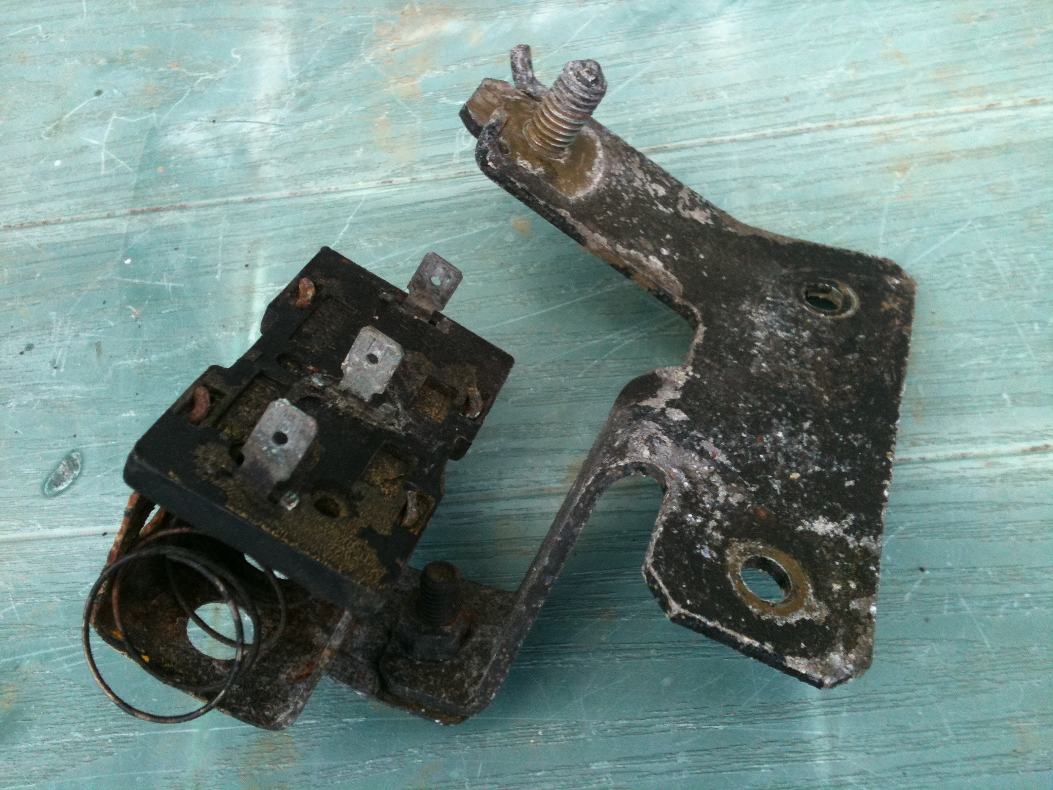

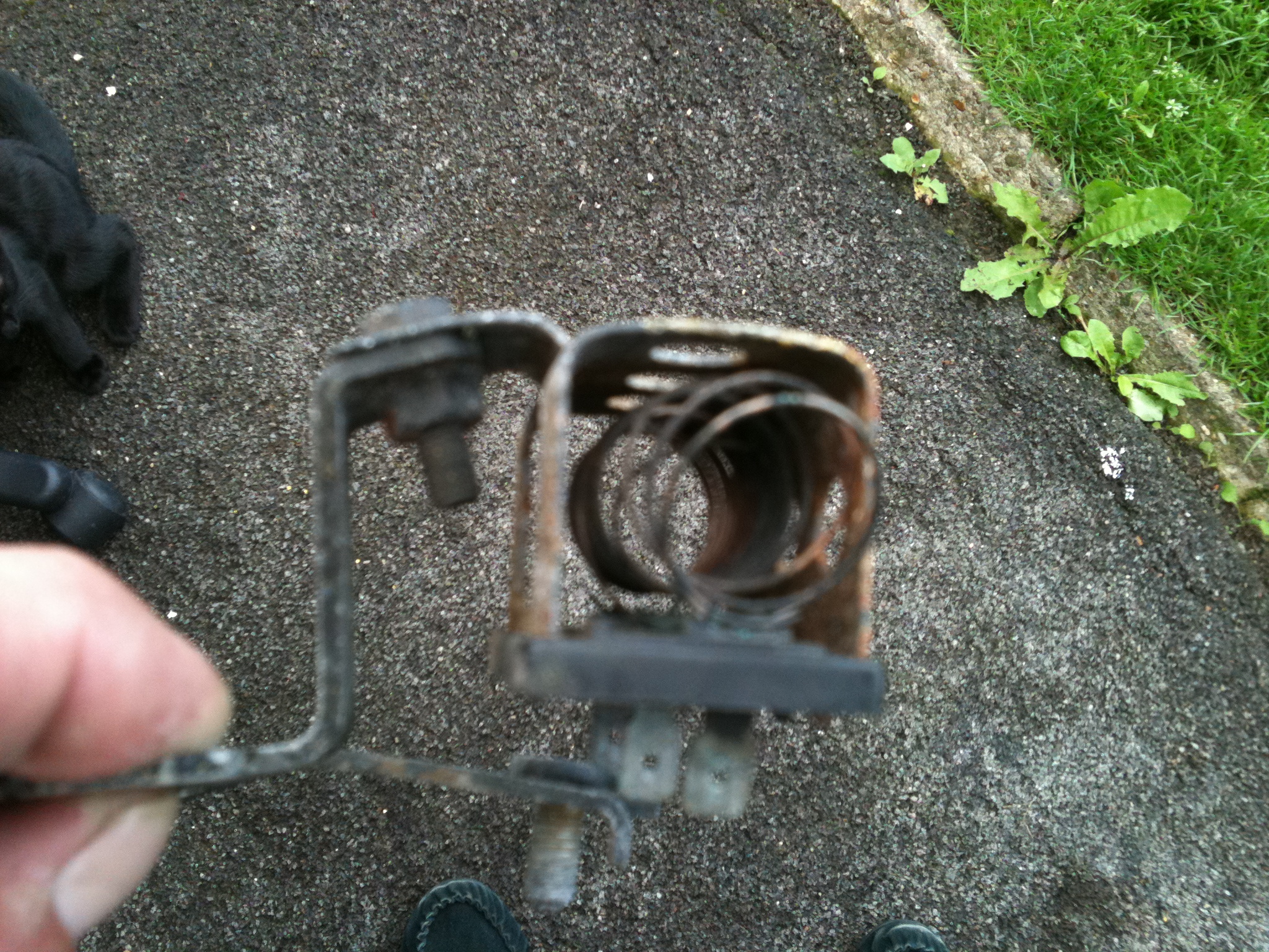

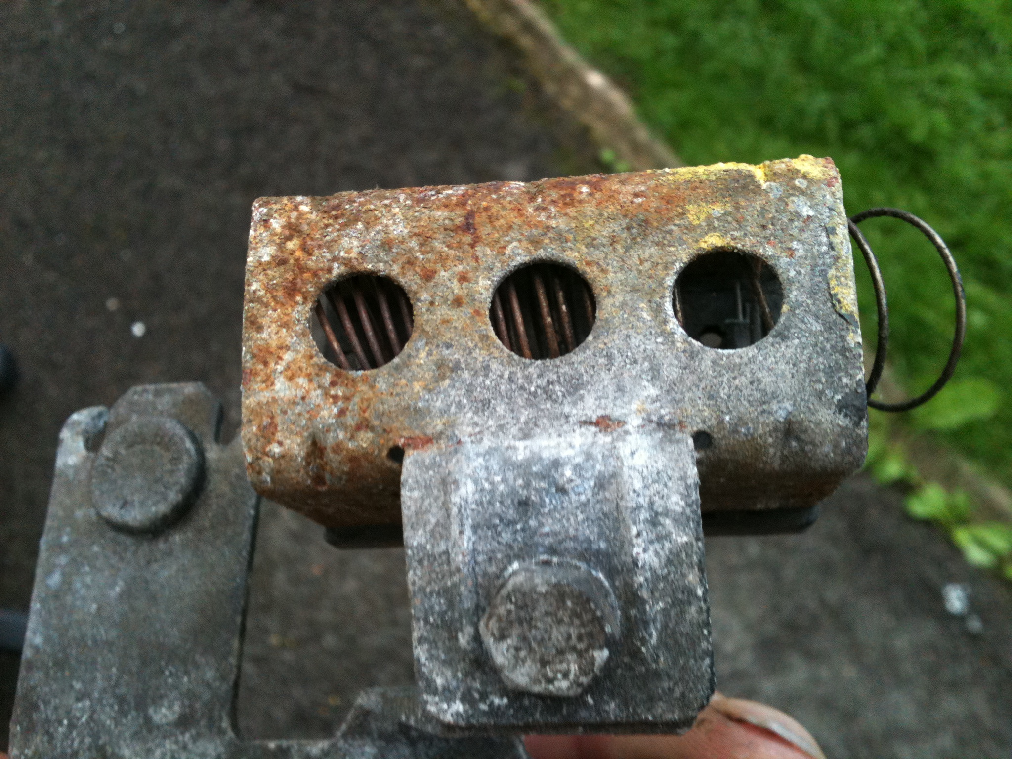

can anybody plz tell me what the hell the last pic is???? it had 3 wires going to it and is mounted to the front panel and has the horn attached to the lower bolt holes...is it required if so does anybody have one thats not fallen to bits????:cry:

its not affected anything that i have found...cant find anything in the haynes manual either nor on eper......its got me baffled:eek:

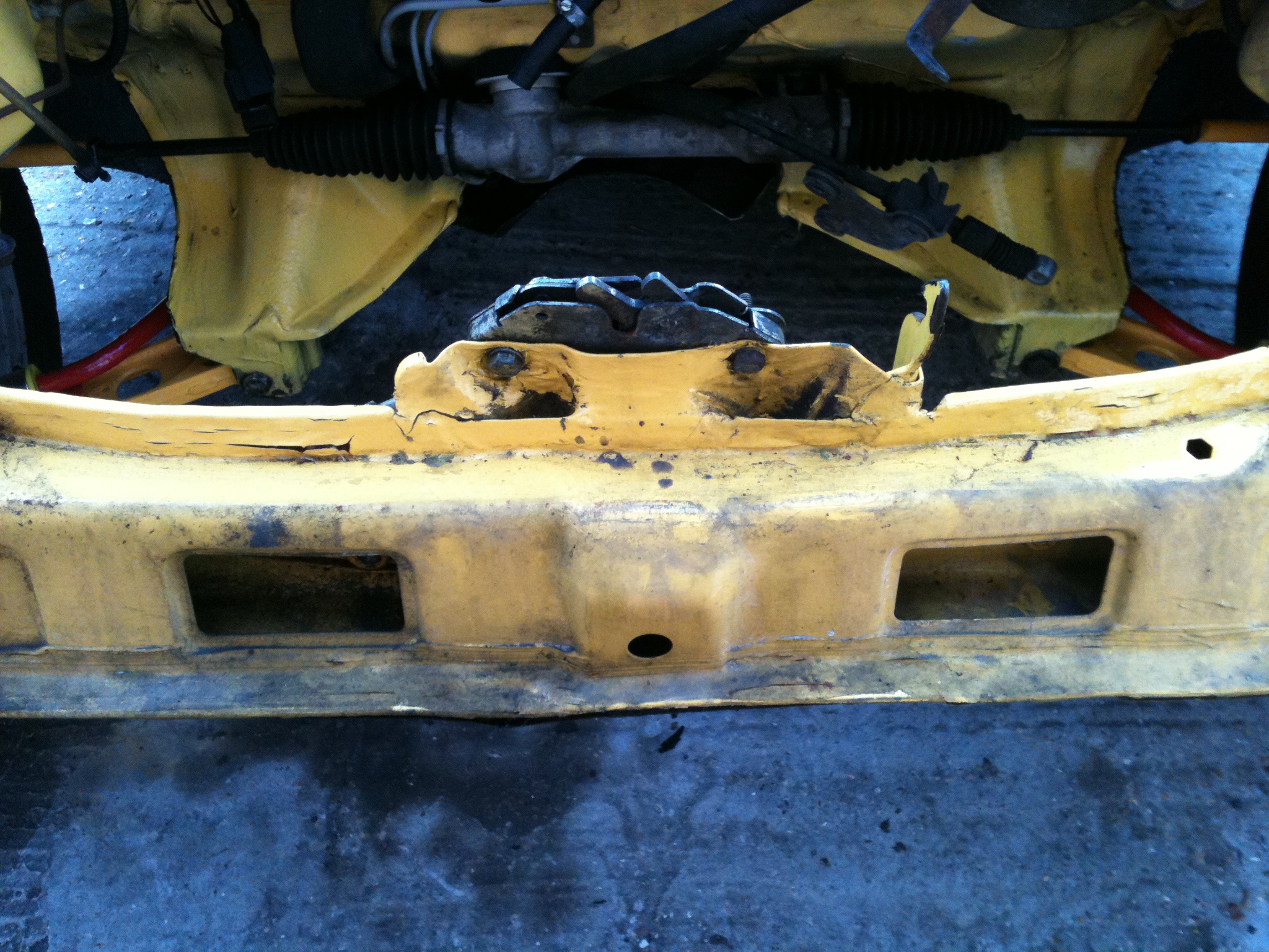

on to another bit and i think i may well just get away with just tidying the panel work up thats on there as it looks fairly straight....whats ur opinion???

Just tidy the panel up that is on there, do a couple of plug welds, seam sealer it and paint over the top, saves you allot of hassle if its straight and all your panel gaps are even!
Gaz
Yes i know lol, but not everyone has access to a double pronged spot welder at home lol and i wouldnt even bother using a single sided as it would be as weak as a small childs grip lol :p. p.s strength in a cinq front end, what strength! :p
