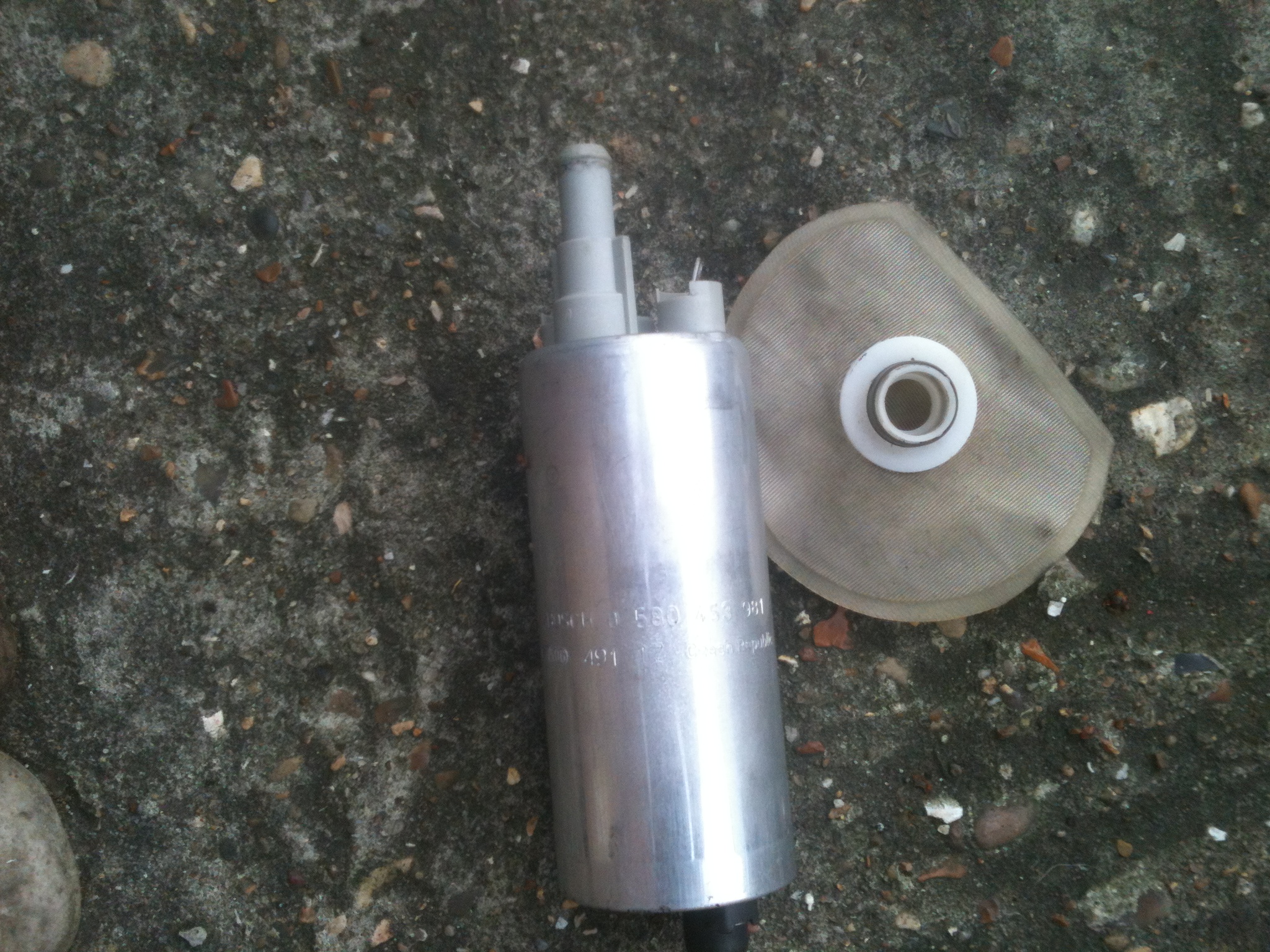

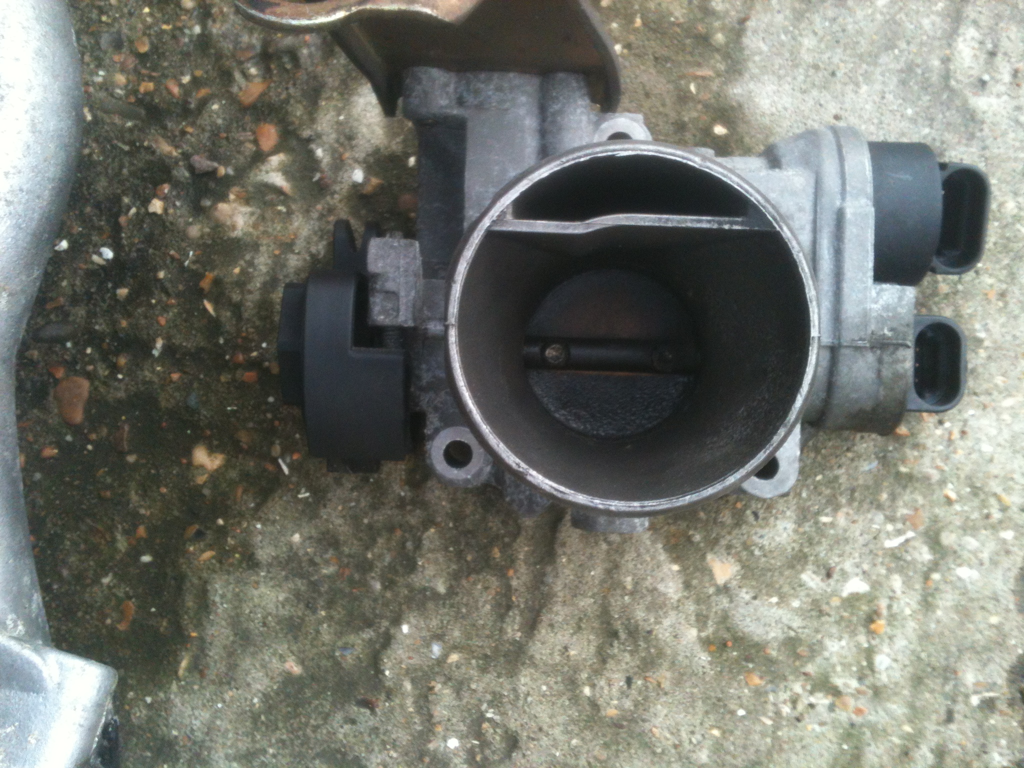

Been soo busy the last 3 weeks aint got a single bit done in that time but have managed to pick up a punto gt fuel pump for £6 and it works perfectly and also got the larger tb off a 1.6 marea which is the direct fit to the inlet £20 delivered(y)and thats already on the inlet as in the pics

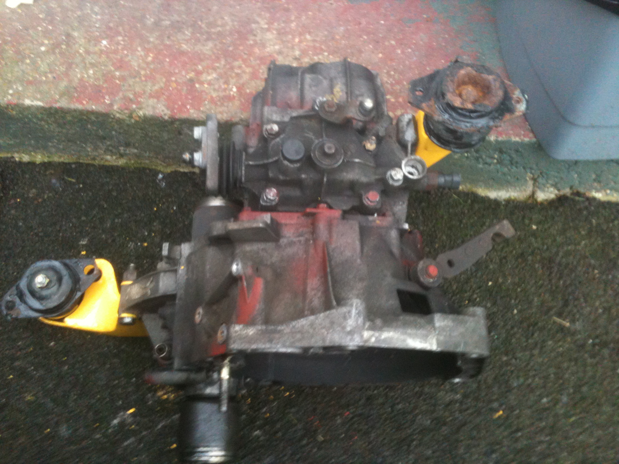

Got a few days off this week so will be getting a few bits done and on thursday ive got to go and collect a 6 speed box with a brand new clutch and then change bits over ready to go into the cinq...£50 what a result and its only done 40000 miles:D:D

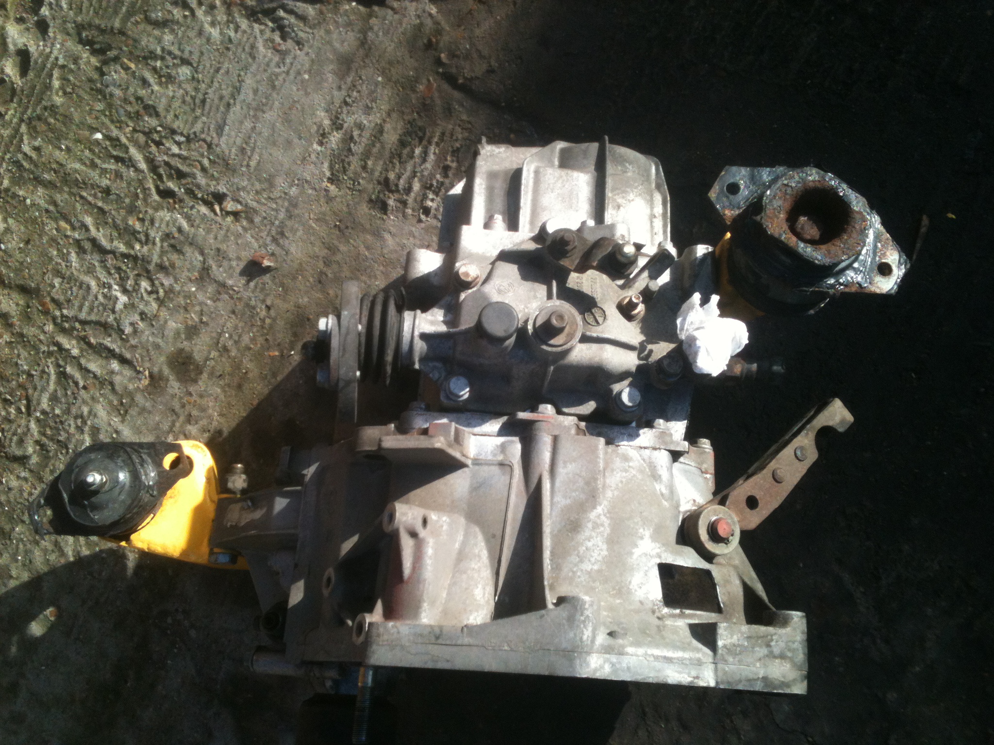

Been and picked up the 6 speed box today and 3 hours later im back home and everything is swaped over ready to go into the cinq just got to find an engine next:D

Over the last 3 days got a few silly bits done like getting all the wings back on properly all sealed up,punto gt fuel pump fitted,gearbox cleaned up,headlights back in place and connected,few other odds and sods put back in place as the itinerary has changed quite drastically today as the mrs rover has finally given up the ghost and is getting buried:D:D and she said my cinq would be dead first :ROFLMAO::ROFLMAO: and she now wants the imola blue cinq off me and has just driven it for the first time and she loves it:cry: so now i have to get the abarth done asap so im hoping everything will now come together for me at the right time:worship::worship:
i know the gearbox will need to come out again just put it in there to check the steering lock and it clears perfectly,the pic is how it stands at the momment....wiring loom comes next...:eek:
