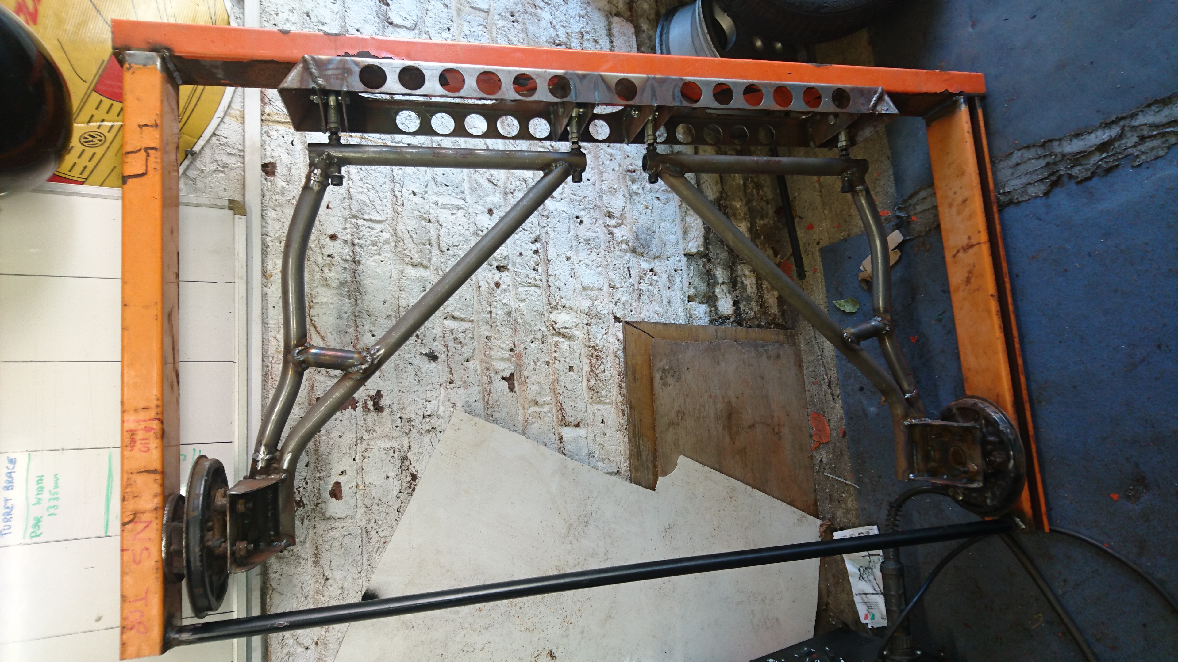

I have changed the front strut tops to adjustable ones and also designed and fabricated a custom rear suspension setup with turreted coil over shocks and multi adjustable rose jointed pivots, this completely does away the standard Cinquecento rear beam.
As I no longer need to run the standard fuel tank in its original position this gave me option to have the main body mount for the suspension bolted to the healboard and then fix to it a pair of tubular trailing arms and use current model Panda bolt on rear hear hubs.
I'm also going to be looking into making some rose jointed adjustable front arms over the coming months.
Inspiring stuff. I hope you don't mind if I "borrow" a few ideas. ;)

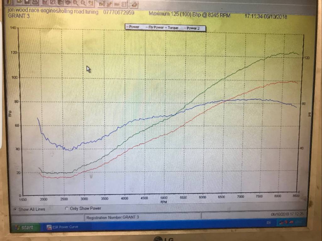

My new 1170cc engine built by Jon Wood has been set up on the dyno and is making some seriously good power.
Unfortunately the season has finished now so I wont be able to check out its full potential until next year. 20181006_182913.jpeg
