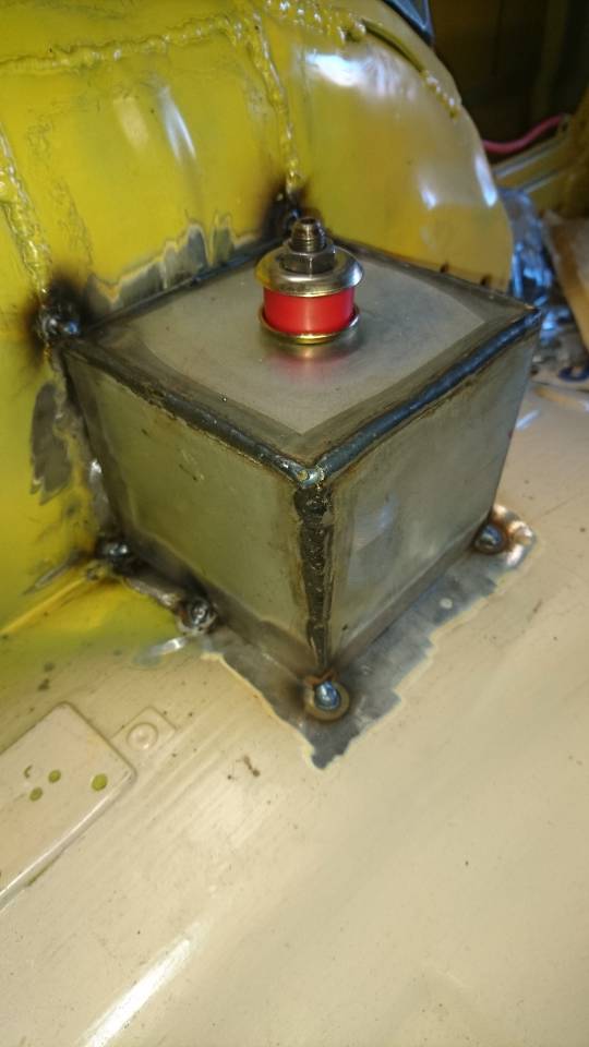

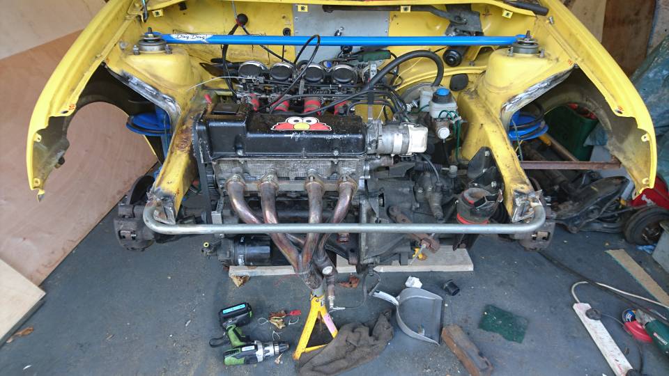

I managed to loose another 34kg of weight out of the car by "interpreting" the RAC MSA Blue Book regs to suit me, I've removed the inner wings in front of the strut mounts leaving the chassis legs and removed the front panel and replaced with a tubular support frame for the radiator and bumper. Ive also removed the rear hatch slam panel and gutted the hatch inner skin and replaced the window glass with perspex.

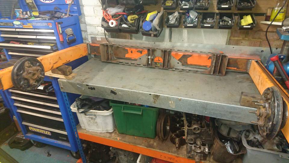

The biggest task was to make tubular rear trailing arms with adjustable mounts and turreted coilover rear shocks to replace the complete standard rear suspension setup,this was done to loose more weight and give multiway adjustability. I used current Panda rear hubs as the have 4 bolt fixing, I then bolted them to a jig frame long with the body mount and basically joined them together with 32mm seamless steel tubing and used M12 rose joints for the adjustable arm pivots.
