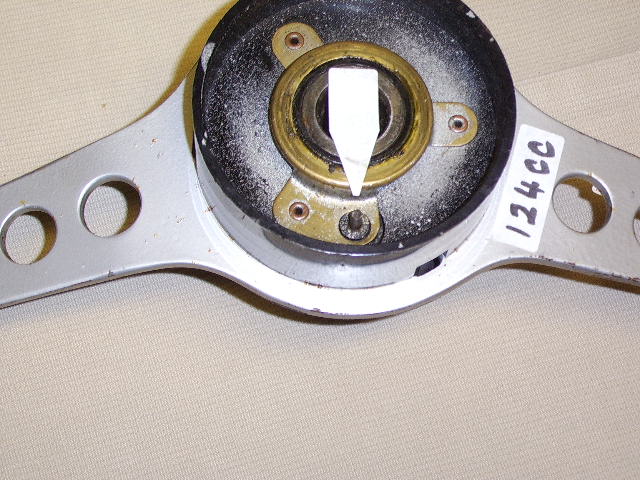

Before refitting the steering wheel, check that the locating hole in the turn signal cancelling ring on the top of the st. column sw. assy is positioned correctly (i.e at the bottom) so that the spring loaded pin on the underside of the st. wheel (arrowed in pic. below) will engage with this hole, then refit the steering wheel, try rotating the st. wheel in both directions with turn signals lever switched on to check that the self-cancelling feature for the turn-signals is working correctly, if so, tighten nut firmly, refit horn push button, reconnect the battery and check that the horn is working correctly (if not you might have to loosen the st. column switch lower clamp bolt and adjust the col. sw. assy up a little).
