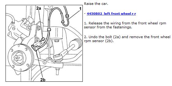

Is is possible to paste a schematic, showing me where the hub carrier sensors might be located. It would be appreciated.
I suspect, it will be the front rather than the rear units affected, as the front suspension takes a regular amount of real abuse.
I've had mine apart and fitted a new strut on the front a few weeks ago, and a new lower wishbone. I didn't see anything then on the hub that looked like a speed sensor .... and as I recall the only wiring I recall seeing, was the brake pad wear indicators .... (I've replaced those too, some time ago). Perhaps worth jacking the thing up and having a look, if I knew where to ..... can you help ?
I haven't discounted the notion that the cluster has died (again), but am examining other possibilities as well, before lashing out yet more cash !!
The front sensors would have stayed on the hub carrier while you replaced the strut and wishbone.
Diagram from eLEARN below for the front sensors. The connectors for them are under the bonnet by the suspension turrets I believe. They are long black cylindrical conectors.

Excellent,
Most helpful.
Appreciation given for your time ....
I'll print out and investigate ....
Thank you
