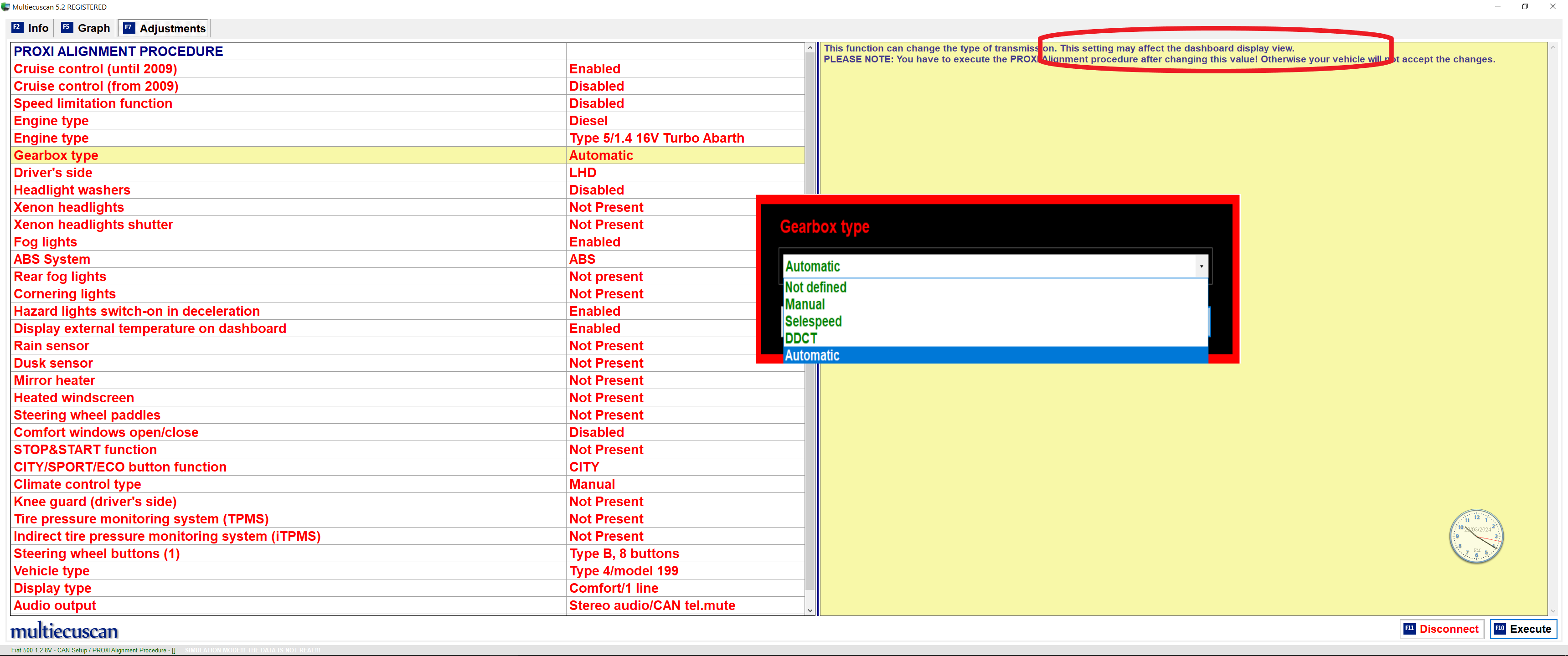

You may have sorted this by now but did you get to this MES screen?
Sorry if it seems like I'm teaching you to suck eggs....

Then as long as you like on MES....
Control+Alt+C, to change byte 65 to either:
00 = pop/lounge.
20 = Same as above with slightly different layout.
40 = Sport.
60 = Abarth.
(These changes didn't work for me as I think my speedo is too modern, and isn't recognised by the Body ECU, but I'll sort it eventually)
