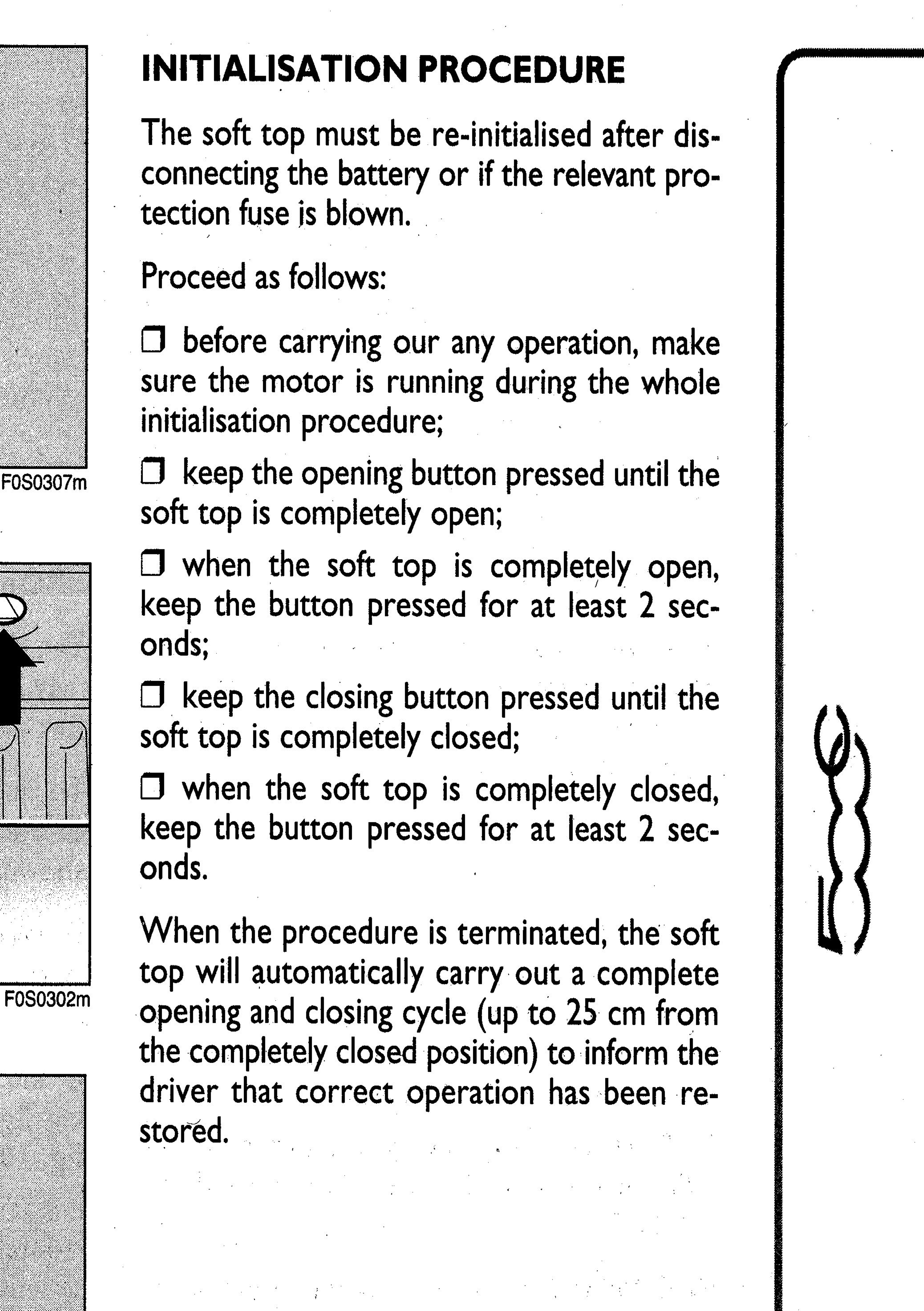

My soft top does not fully close. It stops about 15” from full closure. Would this be a wiring problem. Thank you
I believe its more likely to be a mechanical problems. Some more knowledgeable people will be a long in a minute but I do remember there use to be a repair kit to fix issues with the runners and mechanical parts of the roof if this were to happen.
Before you do anything else run the roof initialisation (if you haven't already). There are no sensors to tell the roof control module where the roof is and it needs to learn the limits of travel again if the battery has been disconnected or something.
Before you do anything else run the roof initialisation (if you haven't already). There are no sensors to tell the roof control module where the roof is and it needs to learn the limits of travel again if the battery has been disconnected or something.View attachment 424858
I tried this and when the pressed the down button, the roof went completely down. When I pressed the up button the roof stopped half way up and I had to take my finger off the button and press again. No luck, but thank you so much for your advice.

I'd maybe close it manually and then attempt the relearn? also if you can't manually close it, then it does suggest there is a mechanical issue.
Disconnect the battery for a while then reconnect and try again. Make sure to hold the buttons in firmly.
As Andy suggests there is a manual option; in the boot you'll find a nut (underneath the top shelf) which you can turn with the wheelbrace or, better, a ratchet and socket to open or close the roof.
If there's a mechanical fault such as a broken runner I'd expect the roof to skew to one side. Listen for any grinding noises or clunks when it stops. A dry lubricant spray along the tracks may help too.
