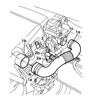

See with the throttle body valve, on the 1.2, is that in on the around the air inlet tube on the side of the engine cover? Looks interesting to remove the clip from there.
Yes here it is. If you can get your hands on right angle circlip pliers then there's a knack but a very quick way to release and refit those horrible clips
Worst comes to worst I can just grab a jubilee clip from work if I wreck the one that's on there :)
