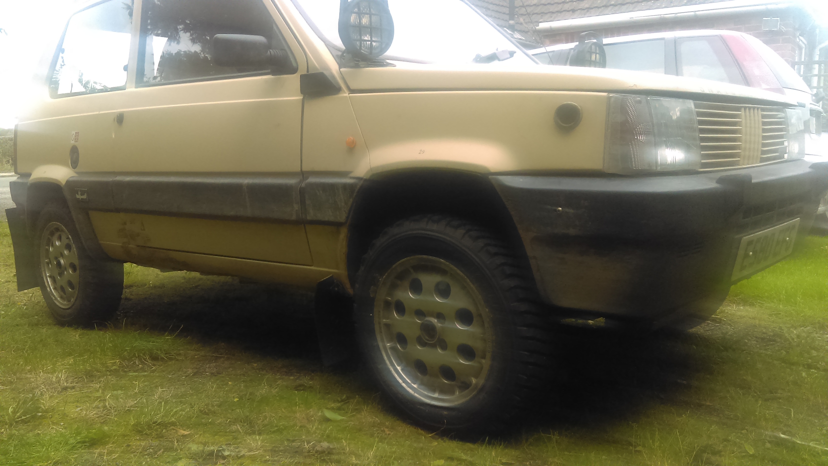

It's taken a while but I'm going to try uploading some photos..
Inspired by Snatch Land Rovers deployed to Gulf War I, Afghanistan and previously in Northern Ireland, I wondered how the Panda version might have turned out..
Dragonman gave me a useful kick early on and David, Aquamarine has been wonderfully helpful throughout -thank you both.
Things got a bit loose with the interpretation as I got carried away - so the mudflaps aren't necessary (but I like how rally cars look) and the bonnet lamps are because of a soft spot for the Matra Rancho. - Please be reassured that only a rusty bonnet was harmed in the making of this modification.
Similarly - all the changes can be undone fairly easily if Sisley prices continue to head for the stratosphere.. So I didn't paint the grill and I have kept a good unmodified bullbar to one side.
Hope you like it. Let me know what you think.
