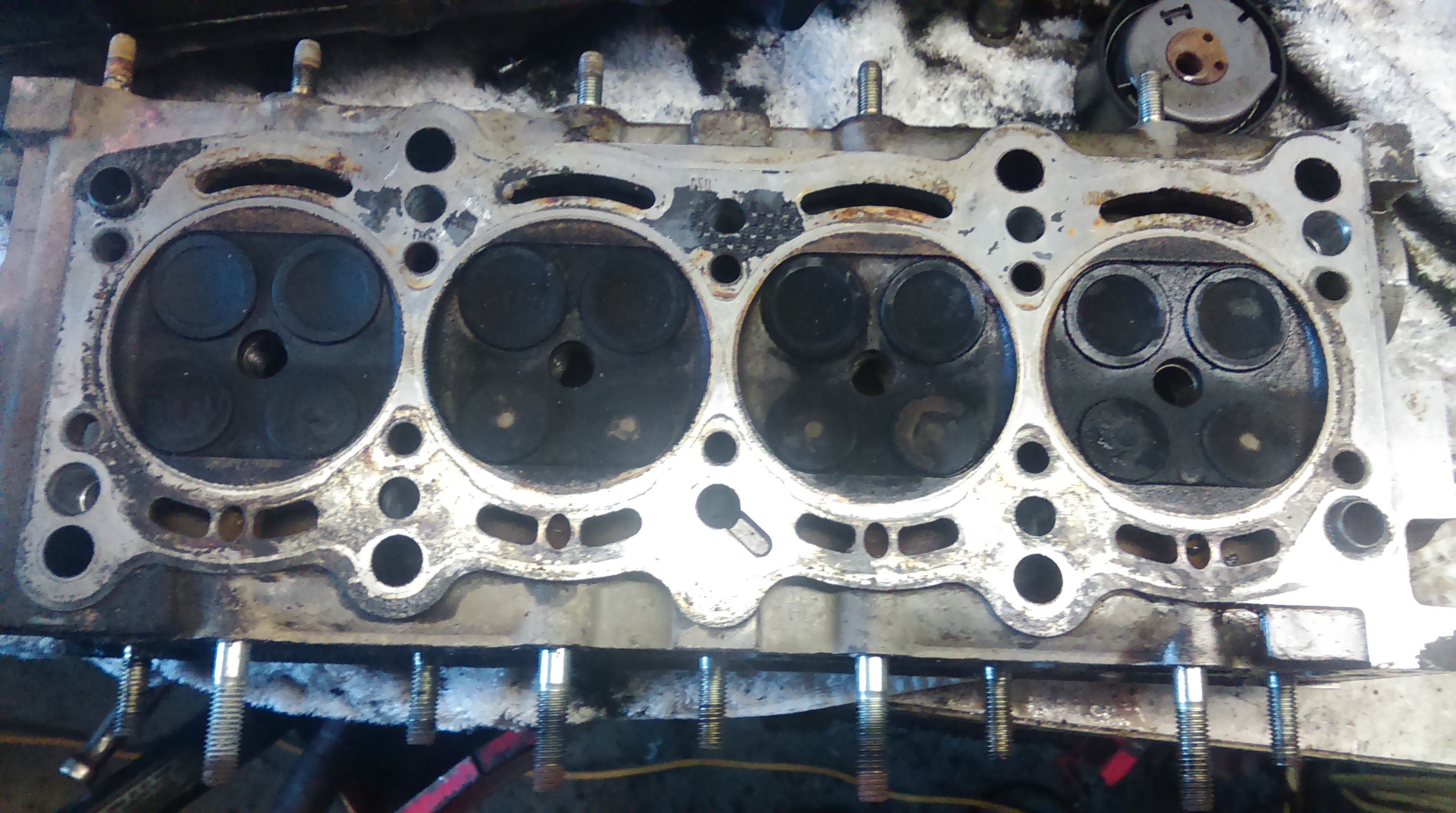

It might be just the flash effect but for me it looks like:
question 1 - is the fuel pressure right? - looking from right :
Cyl 1 - looking good - moderate ammount of deposit,
cyl 2 - bit more
cyl 3 - much more deposit
cyl 4 - much much more of coke build-up
If i would had to choose i would indicate cyl 4 as that one which had the misfire, but why?
Nice work kolza - I agree your diagnosis (but I cheated) - pulling the lead off cyl 4 made no difference to the rough running and the thermometer pointed at 3 and 4's exhaust manifold branches' showed lower temperatures relative to 1 and 2.

I'm approaching this from the point of view that a refreshed cylinder head, cleaner piston crowns and new gasket may make a marginal difference- but could also be a better base for refreshed injectors and sparky stuff to do their thing.

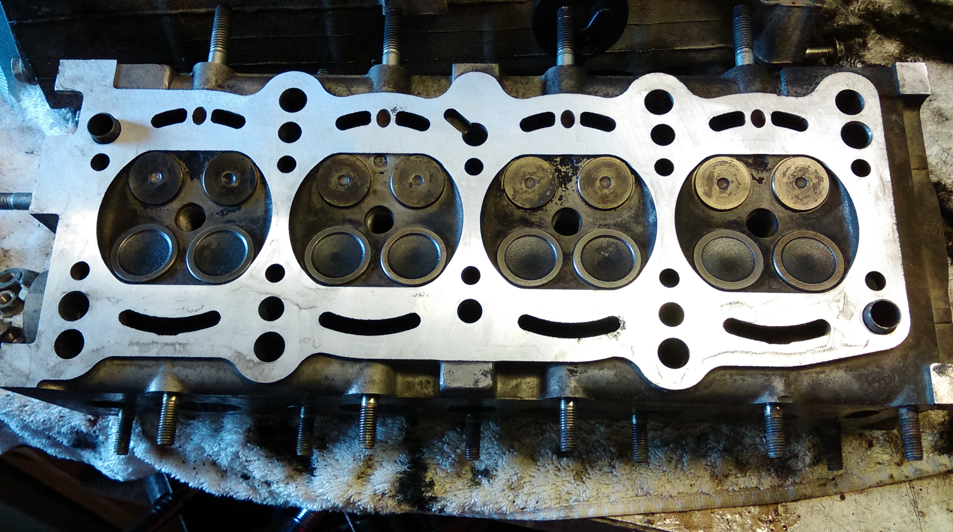

Anyway got the head back today -
All for £40. Bargain. And got to poke around their workshop where there was nothing smaller than this one but the biggest were a pair from a yacht, each head the size of coffee table. - Probably not £40.

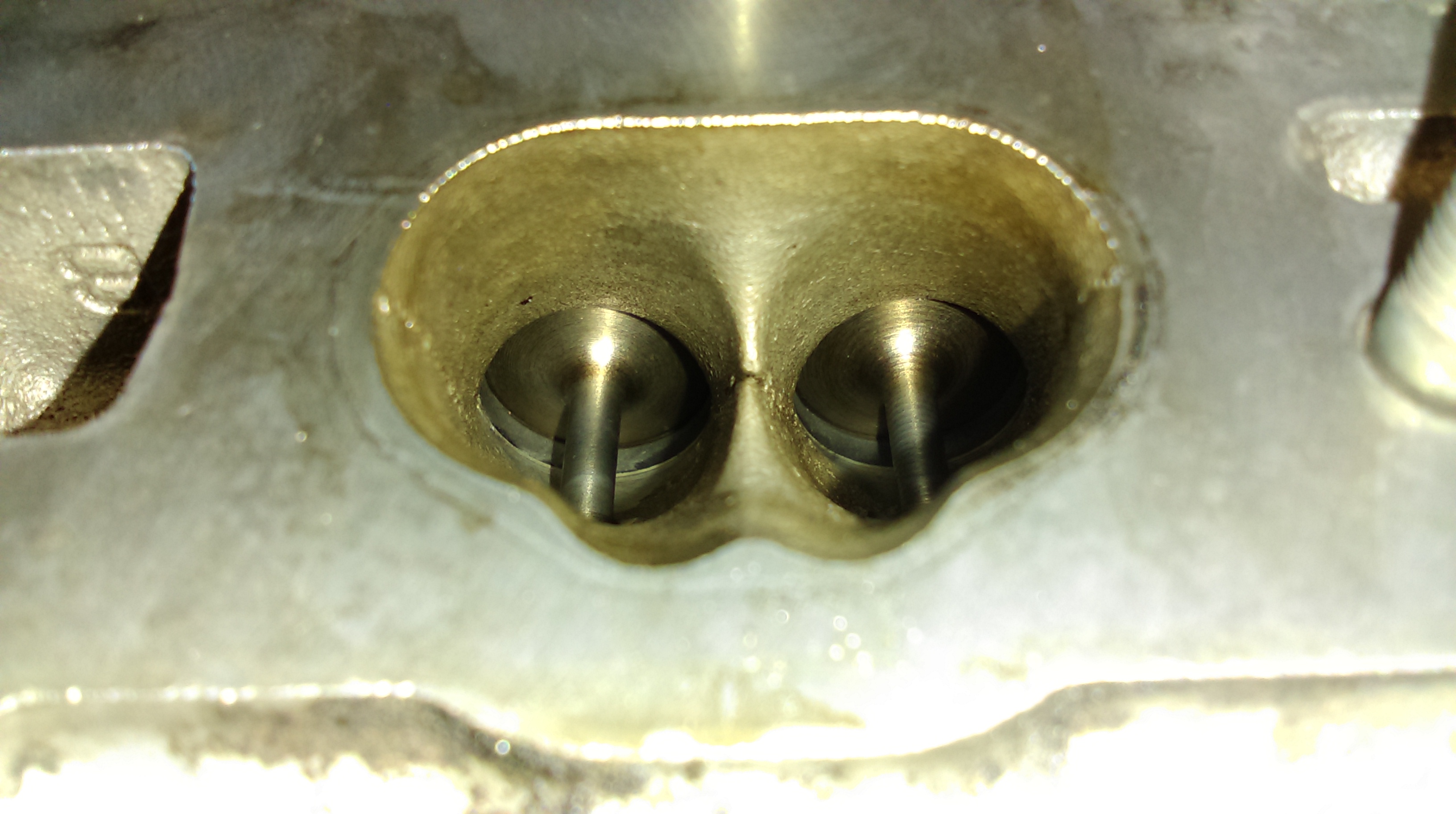

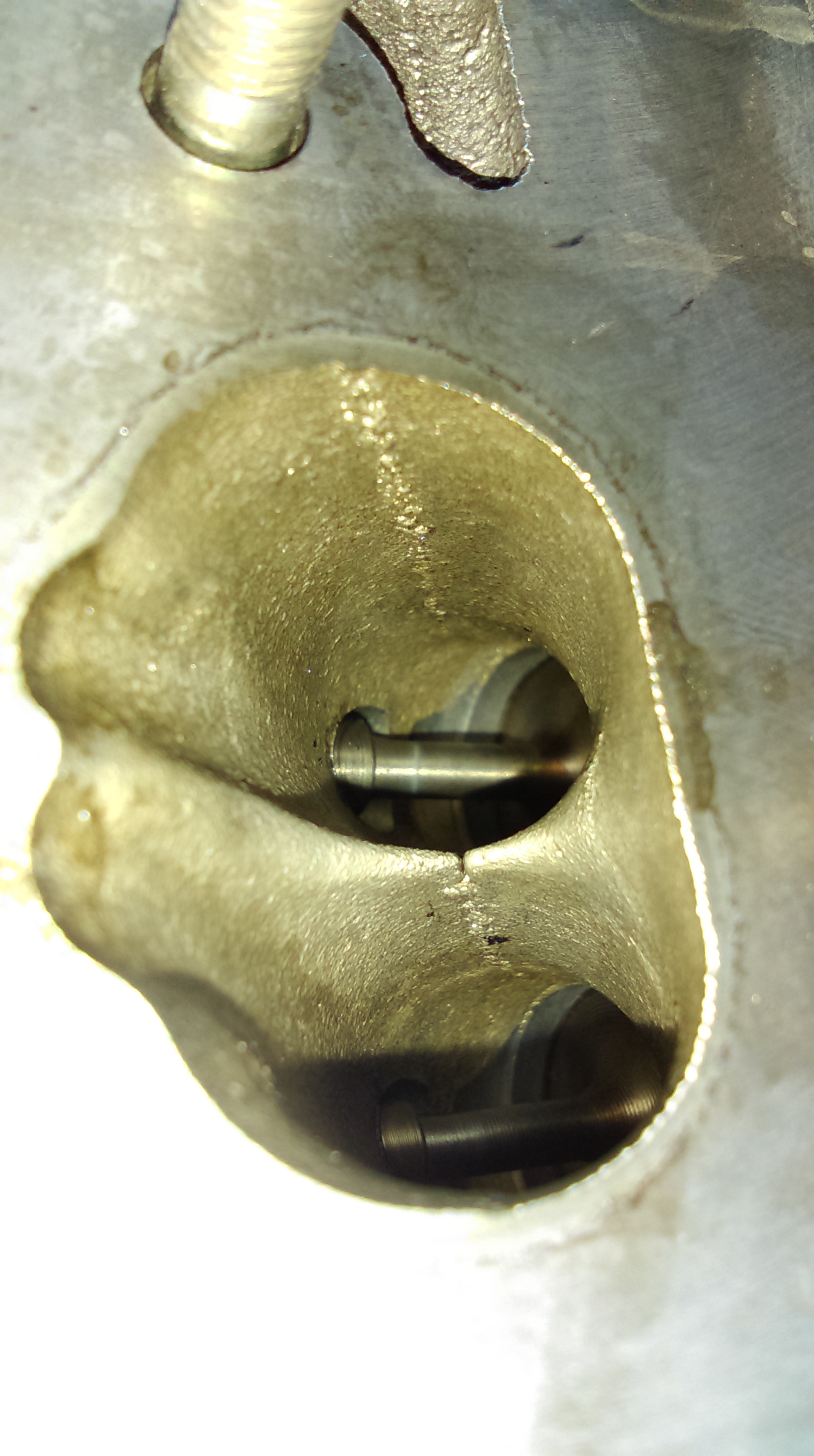

Peering down the Punto ports I noticed these cracks or slots in each centre web:
Each inlet tract looks the same and as though they've always been like that. Odd though, anyone any theories?

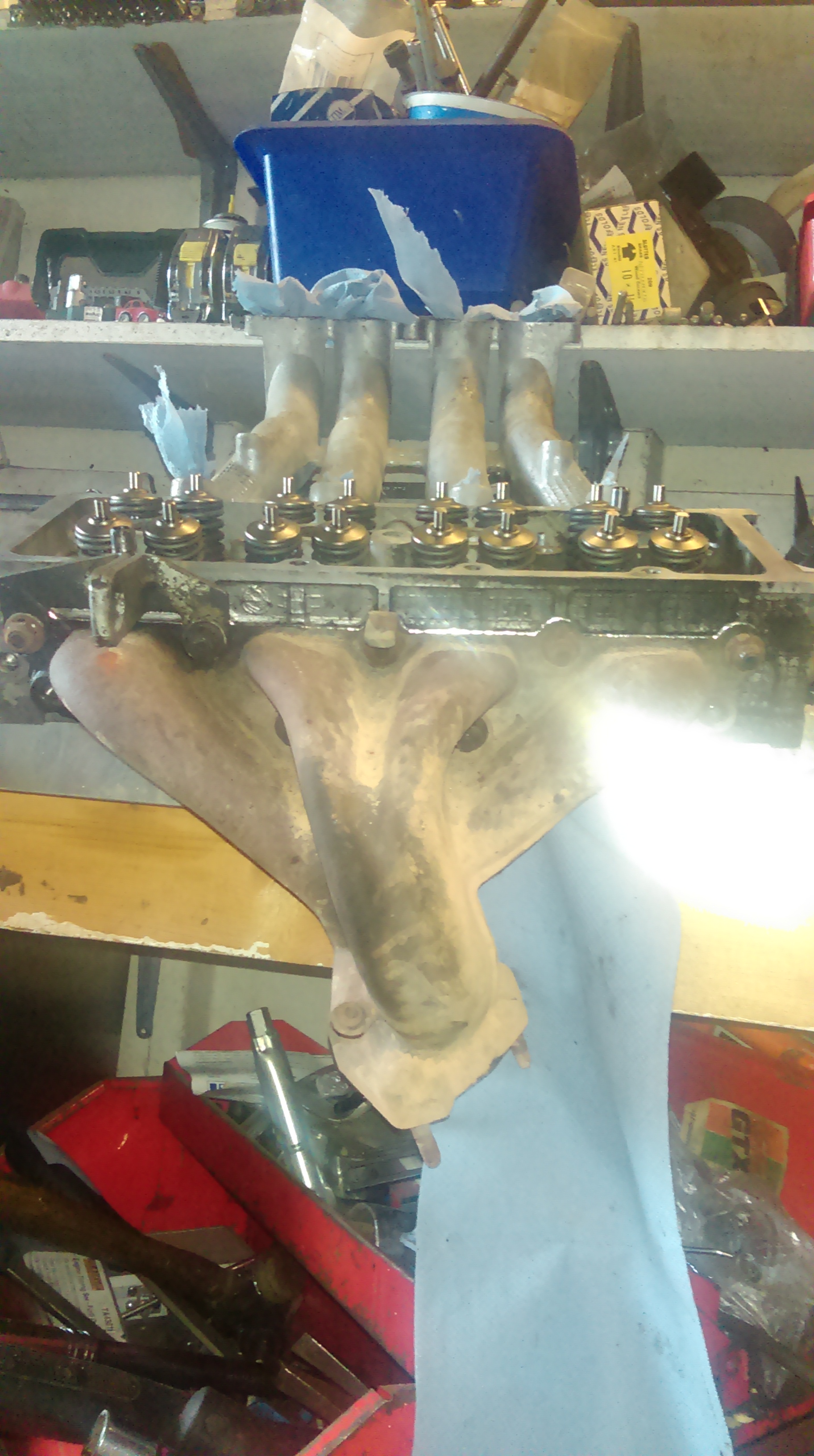

Try find a mk1 punto 85 manifold.. can modify a downpipe to meet up with whatever exhaust is under the car. That would result in decat as the punto had the cat under the car behind the engine in the section after the downpipe.
I might have a pic of one somewhere from when I did my cinq 16v swap - I'll have a look when at computer.
As Blu says Freddy- this is my Punto 85 manifold:
Which fits without moving the radiator (just) but I also run it with the heat shield on top which has made contact under duress with the back of the radiator fins even though the engine mounts are all good and I hit it first with a lump hammer.
Bravo(a) downpipes are very cheap (£20 ish) and have a lambda boss and flexi joint:
Looks like a poor casting and inclusion possibly. Naturally that thin section would be the hardest part of the casting to fill and it's where the 2 bits of molten steel have met but not properly merged. That's my guess anyway.
If oil is getting into intake through one of the cracks then that might also add to the running issue and the puff of smoke out exhaust. If the cracks have propogated to an oil way that is. Have you got any magnetic crack detection spray? I have some which I could bring to an upcoming meet but understand might all be a bit late by then!
Thanks Si
I agree with your guess. All intakes were clean of oil so I don't think there's an issue. I considered cleaning up all the rough finishes but the marginal gains, if any, don't seem worth it - apart from 'because race-car'.
Hopefully the stem seals will fix the smokiness and it's nice to see the innards to know they're all fine.

Thanks Andy and Chris, I will get searching for a mk1 manifold any ideas where I might find one. We are going stainless for the rest of the system so that is no problem. One question though, will a mk1 manifold bolt up to a mk2 head ok?

Exhaust is same but inlets are different as far as I know.. buy a exhaust mani gasket and try it to be sure before buying actual manifold ?
If you find someone breaking a mk1 punto 16v you might consider getting the cams as well. Little bit livelier although totally not end of the world to not have them.
But yes they are getting hard to find now. I'd bet them 150quid 421 for the 16v on ebay, direnza iirc, would not take up more room than a stock mani if all else fails
