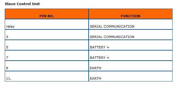

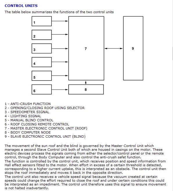

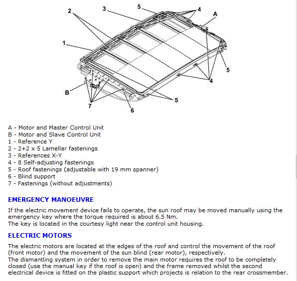

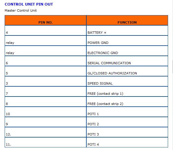

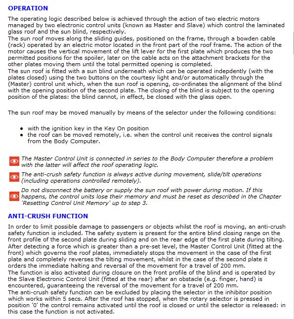

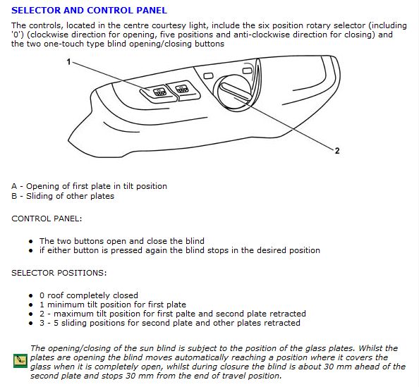

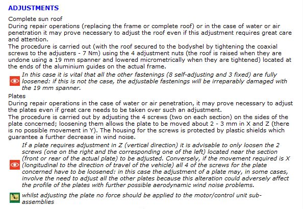

last week my son playing the goat on a frosty day decides to open my sky roof ,yes he managed to get the 1st panel to raise but the rest that was a different story .Looks like it now misalined how do i go about taking off the roof skin to check it and maybe repair it , anyone have plans ...
These are the instructions from eLEARN (the Stilo workshop manual).

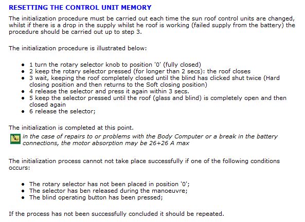

Try pressing and holding down the round roof switch for 10 seconds this should rest your roof. You may need to try this a few times (probably best with the engine running as it draws a lot of current).
The full procedure for this is shown under the paragraph "RESETTING THE CONTROL UNIT MEMORY" in the instructions I posted above.
