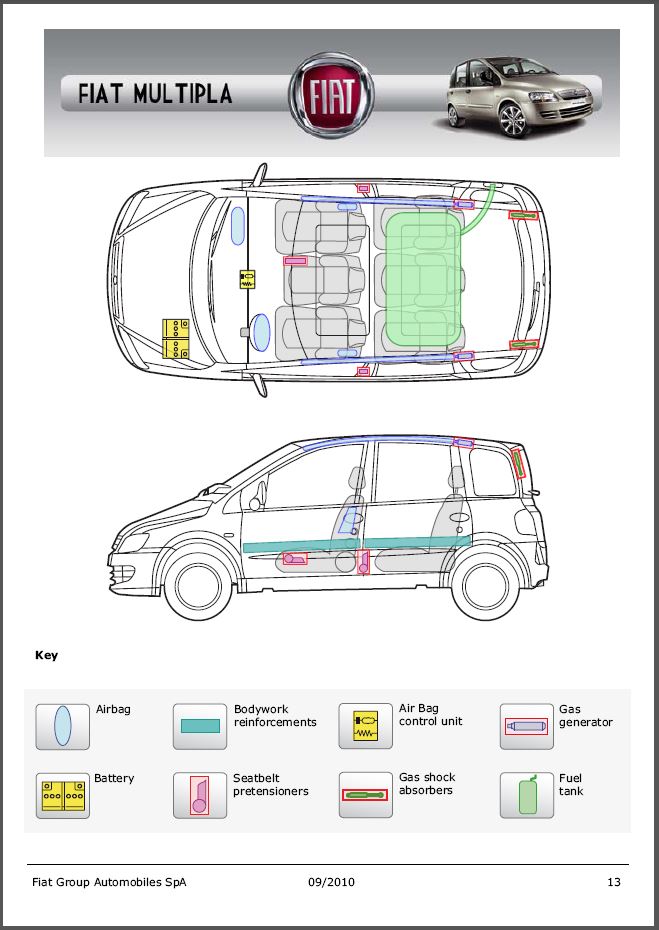

Hi all,
Have not been on the forum for some time as the car has been behaving. :)
However, I have had the dreaded air bag light come on. I have checked and used diagnostic kit. The fault code is 21 and drivers side curtain air bag is intermittent.
Does anybody know where the curtain air bag orange clip is situated so i can check the wires please.
Also, would having an airbag light on stop the car from doing a DPF regen? - Just want to make sure so does not clog up.
Any help will be much appreciated.
This is the Road Rescue Datasheet for the Multipla. It shows where the components are for the emergency services in the event they are attending an accident. Not sure it will assist locating the connectors though.
There's a Multipla eLearn workshop manual in the forum downloads section here: https://www.fiatforum.com/downloads.php?do=download&downloadid=365 There are electrical component location diagrams in the electrical section.
