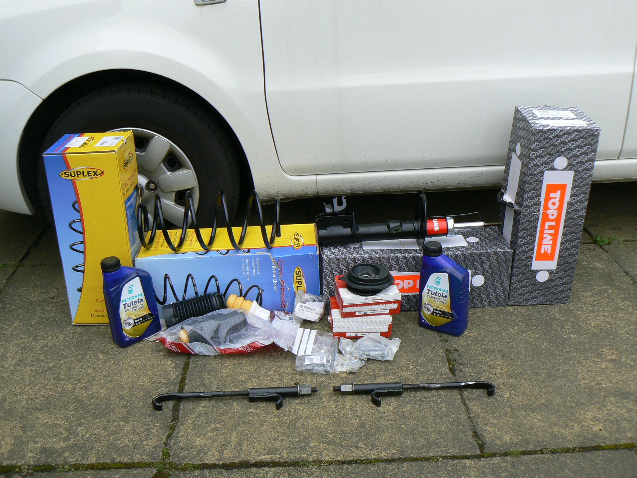

Just been cruising this website and in the description further down the page it lists the brand as BaHuHa. ???!!! Don't very much like the sound of that. However I bought front struts for the Panda from S4p which were a make I'd never heard of before and they've been very good. I hope you find these are Ok. Here is a picture of the stuff I bought to overhaul Becky's front suspension:
Oh, and there you can see the shockers were "Topline" 2019 that was and they're still going absolutely fine without any sign of leaks etc.
Looks like a full overhaul. I'm sure it drives smooth as silk!

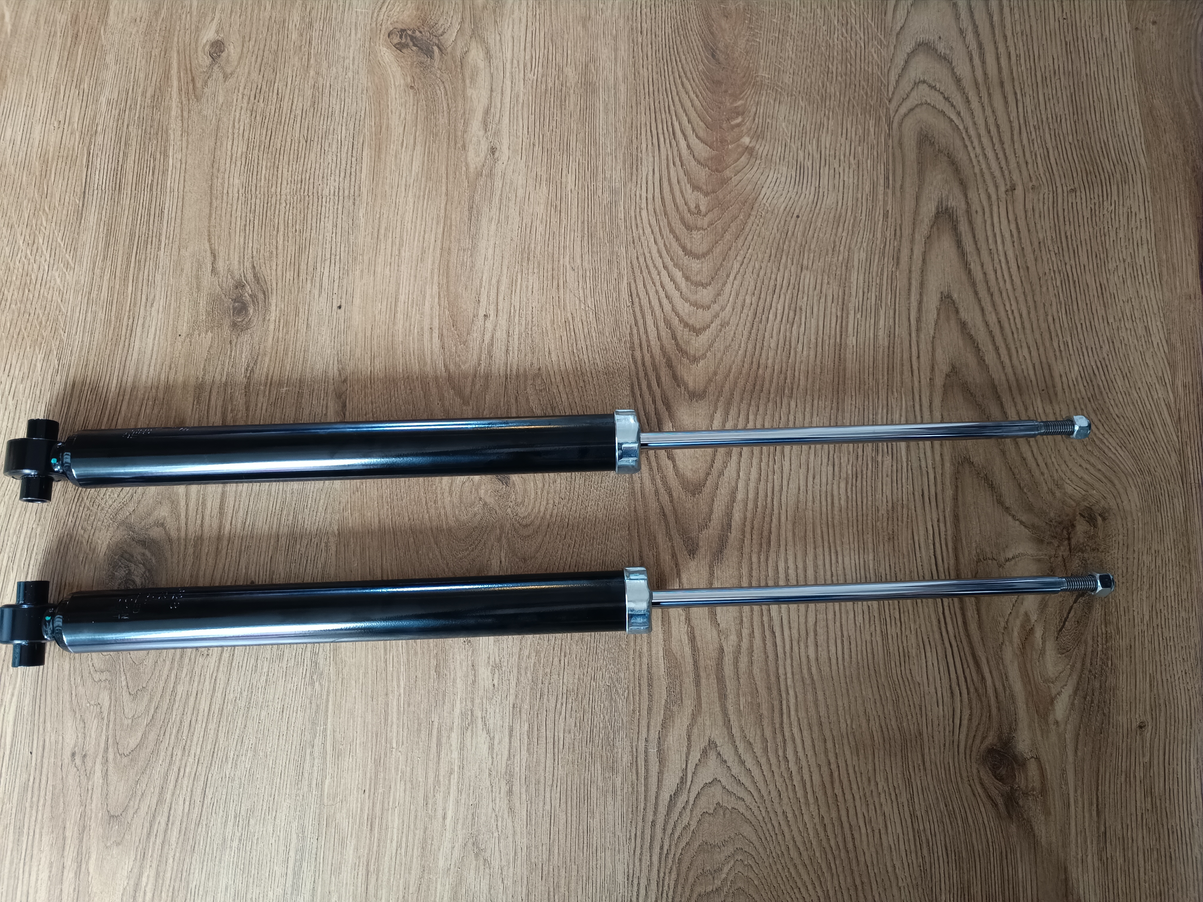

The shocks came in a Falcao box, although there is no branding on the shocks themselves. They look new, and after pushing on them etc. seem to be consistent. I'll put these on, probably tomorrow.
The car is a 2008 plate, the shocks are supposedly guaranteed for 2 years so if they last that long the car will be quite close to end of life.

I got one of the new shocks on today, there was no time to do the second. I took the car for a little drive to see if anything was going to fall off! It was safe and sturdy but I'm wondering if the shocks weren't the problem and it was the springs... The old shock that came off was the original one from 2008, it was very rusty, kind of working weakly and then when I pushed on it firmly all of the remaining gas escaped and it worked no more.

The other shock went on OK, it does feel better going over bumps, but there isn't the big improvement I was hoping for. The springs are just as shot through and would need doing too. Oh well, i'll think about that another time.

New shock should make it stiffer on the back end, less bouncy. Not quite sure what effect you are feeling or hope to improve.
It is less bouncy going over big bumps but I still feel the little bumps a fair bit. Maybe I'll do the springs at a later time.
