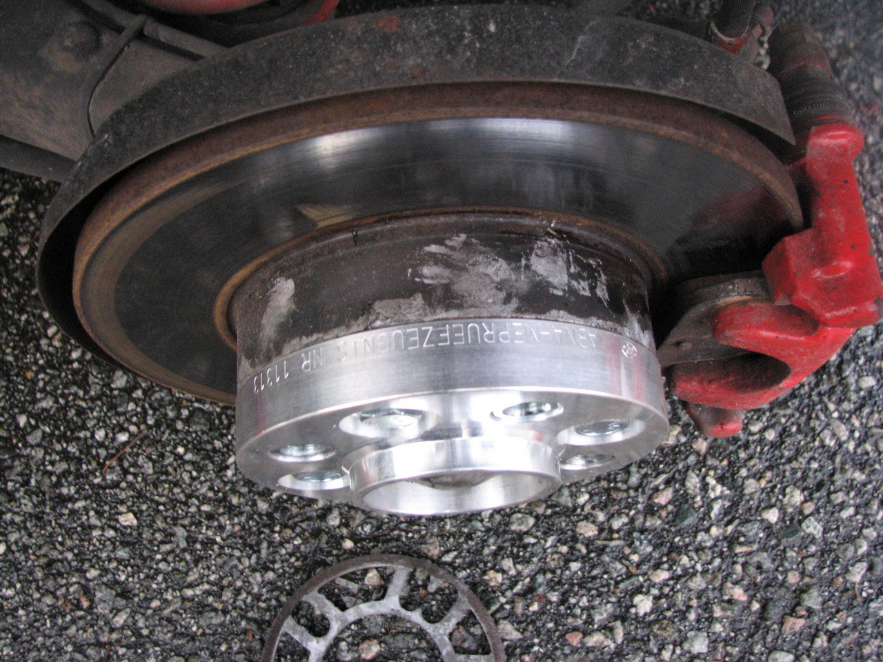

If you are eventualy going to use spacers, You can buy Hub Adaptor spacers,
These will bolt onto yr existing 4x98 PCD and convert to 4x100 stud. You can then use wheel nuts to fix the wheels.

It looks like one needs minimum 20mm adapters; wouldn't that make the track too wide (the wheels touching the arches)? The alloys are 16x7 ET40, tyres 205/45/16.
Hiya Robot,
No you would still be within the arches on a 20mm spacer.
I have 15mm spacer on mine with a 38offset rim and still i could have gone to at least 20/25mm with no rubbing.
With yr 40 offset you should be clear. The only thing you may have to do is cut away a little of the rear plastic mud guards. But this is only in need without spacers. with spacers you should be fine.

This place - http://www.schippan-shop.de - seems to do them for about €90 for a set of two; haven't found any cheaper yet as far as I can remember. It looks like the spacers are Tüv-certified too.

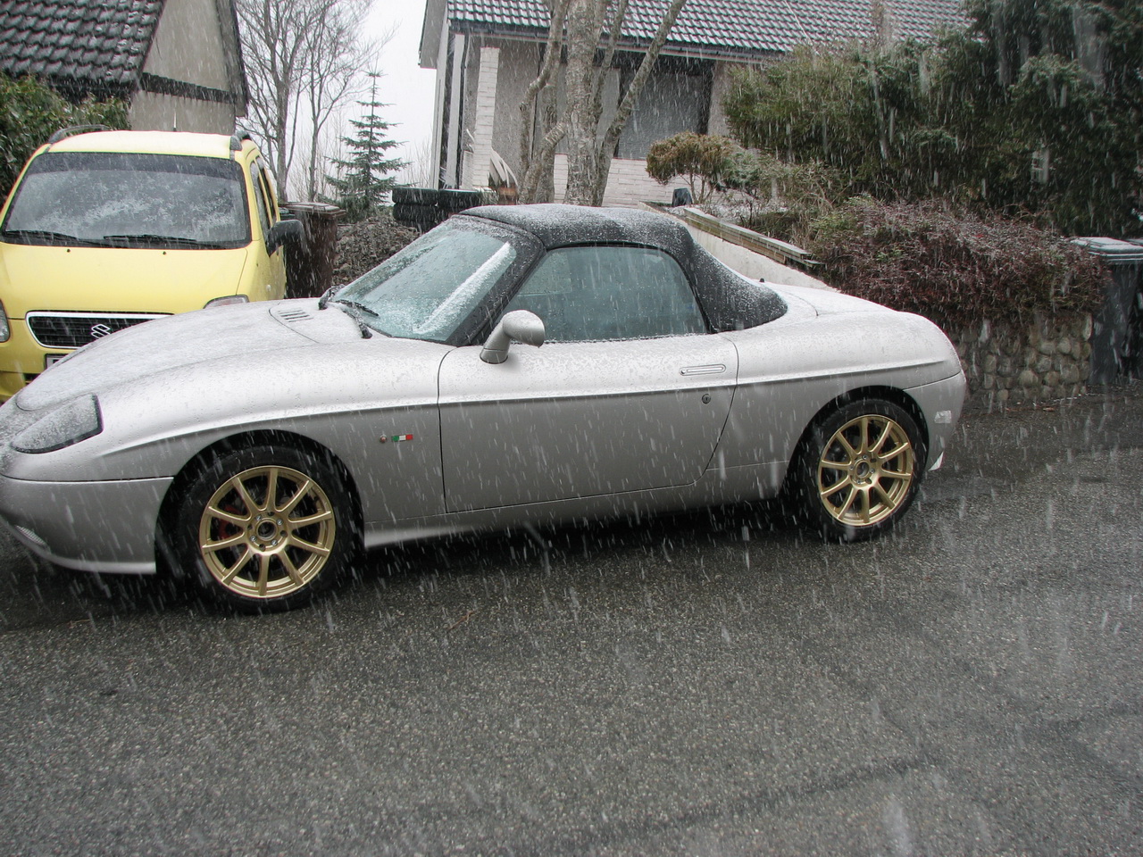

It only took me 8 months :eek:, but I finally got around to putting on the gold alloys yesterday. Looks bloody nice methinks :cool:(y)(y)
Naturally it had to start snowing again just as I changed to my summer tyres :rolleyes:

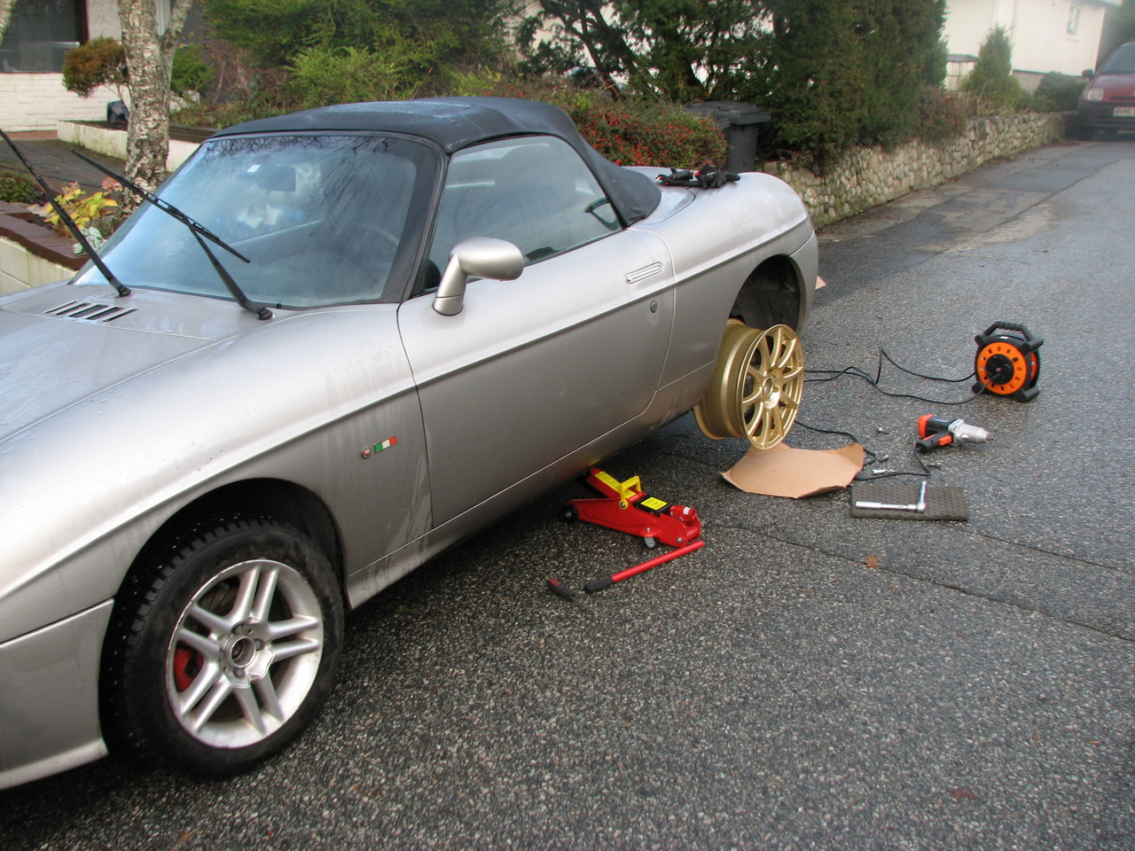

I did a test fitting of the alloys in November and I got a little apprehensive as it looked like the wheels would rub against the arches, but no problems so far :):)
